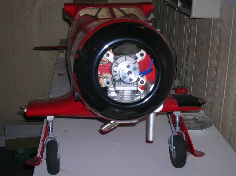

lear31A
How does the muffler hole look? That muffler looks quite large What kind of power does that engine put out?
Does anyone have any stories on the retractable tailwheel? What type are you using?
#334
Joined: Jan 2005
Posts: 56
From: Algonquin,
IL
I am putting a Saito 180 in mine. I have monted it horizontally, versus inverted. It looks like the top rocker cover will rub against the cowl. I think the bottom one will be OK. My plan is to cut a narrow hole the lenghth of the top rocker cover in the cowl, so the top rocker cover will not rub against the cowl. The Golden knight rocker covers are only $15.00, and will not show too much with the other gold trim on the cowl. (Used a Dave Brown 120 size engine mount.)
I have ordered a 90 degree muffler elbow, which should put the muffler in the cowl and exhaust out the bottom.
4" Dubro light weight treaded wheels fit in the retracts and look much better than the provided foamies. Wheel collars on both sides of the wheel keep them centered on the axle.
I haven't seen any instructions for securing the fuel tank. Did I miss them? I was considering glueing a 1//2" square balsa stick to the former over the top of the tank. Any other ideas?

I just used silicone . The provided tank fit snugly and with the silicone it's not going anywhere. It's still removable. You could get a little foam in there to help stop any vibrations for the glow fuel. It's no problem with gas.

lear31A
Looks good! Nice and neat. Maybe some Red Hi-temp engine paint ( auto store) would make the muffler blend in. If you decide to paint it just make sure to run the engine, get the muffler good and hot to "bake" the paint. It will then be fuel proof. You won't need to paint he whole muffler. Just the area that's exposed.
Worth a thought for such an awesome plane
