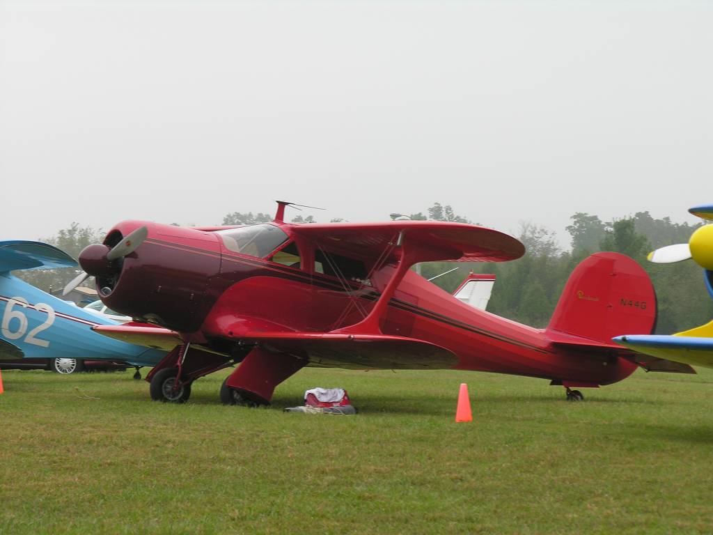

Al, I've seen a couple of those Staggerwings, also. I did see, and talk to the owner of the green/red NC80309 G17 at Oshkosh this year. I want to redo mine in that scheme.

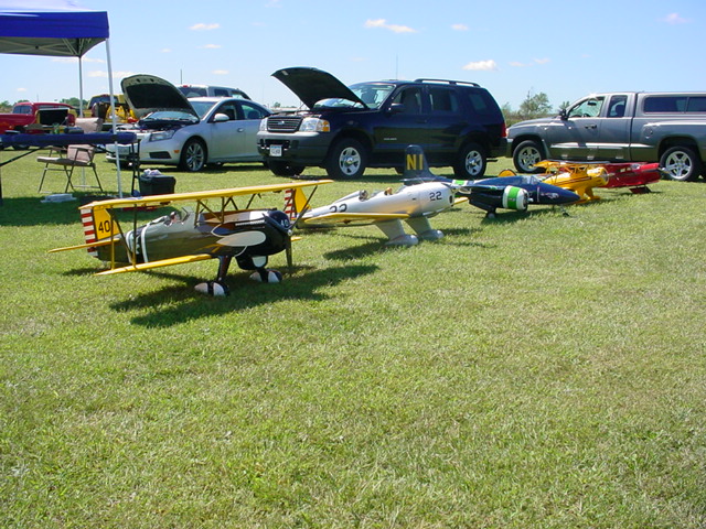

My fleet that I took out the last time I went flying, Sept 3rd. Those are all electric powered.

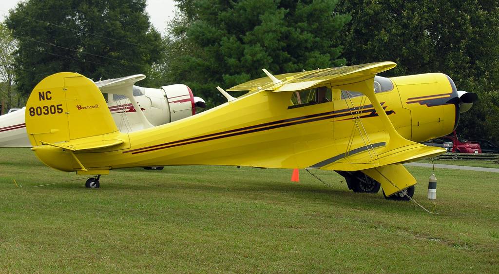

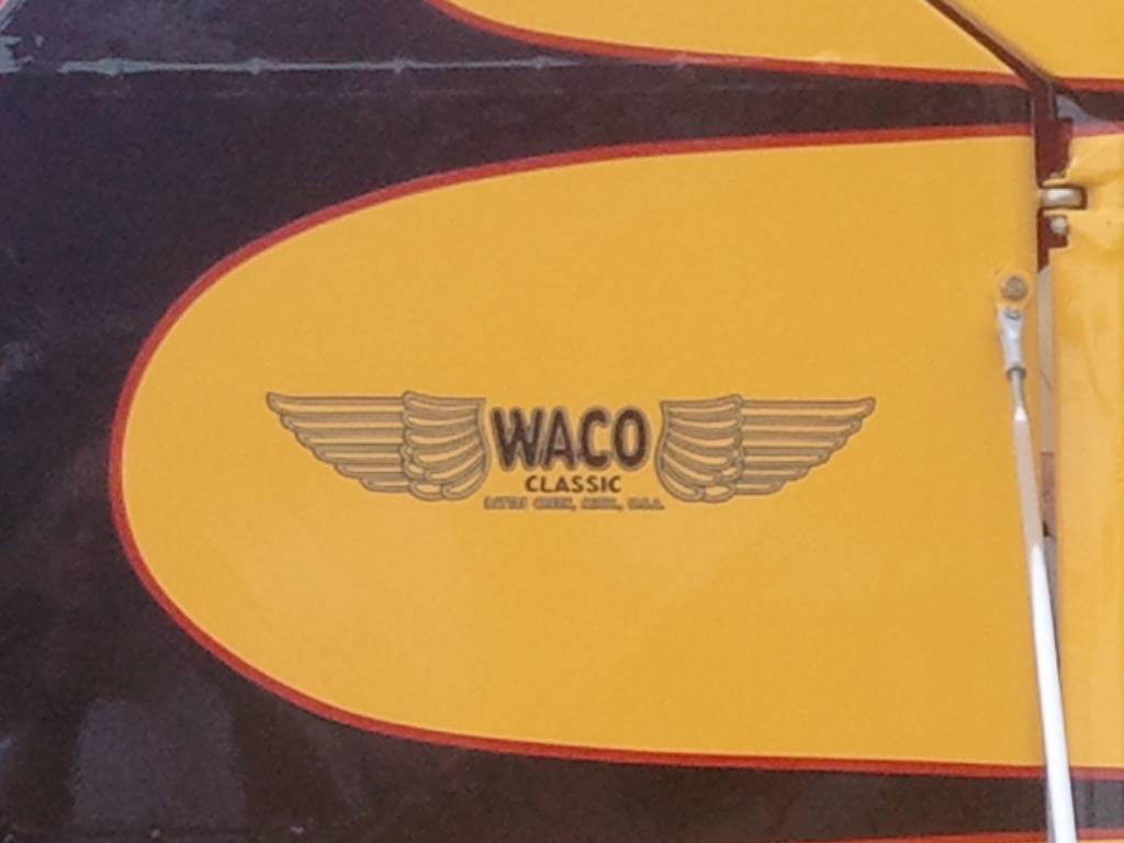

No, it's Cub Yellow on the model, but for a reason. The correct Waco yellow is not available in the Monokote line, which is the covering brand owned by the parent company that owns Great Planes.
FYI. I visited the Waco Classics booth at Oshkosh EAA Air Venture this year, where they had a 1:1 fullsize Waco Classic there, in this yellow scheme, as well as talked to them about it. The true Waco Yellow is a copyrighted color, which is specially mixed for the Waco Classic company. It is very close to Cub Yellow, but more orange. My eyes could not truly see the difference until we laid a piece of the monokote on the Waco. (I had a piece with me.) The gentleman I talked to, (Can't remember his name,) said that a group from the factory who also fly R/C, including himself, had just completed the build/assy of their first one of the Great Planes Waco. They had just enough time to fly it once before having to prepare for the trip to Oshkosh, and loved the model. They licensed the model, knowing it would be done in Cub Yellow, again due to the fact Waco Yellow was not available.
If anyone is going to turn down this model just because of the color, you're doing yourself a disfavor. You can always repaint/recover it, if you can find the proper color, or do it in a different color scheme altogether.
Just my .02 cents worth.
Don
A couple shots of the real one taken with my phone, as well as my model, also taken with my phone.

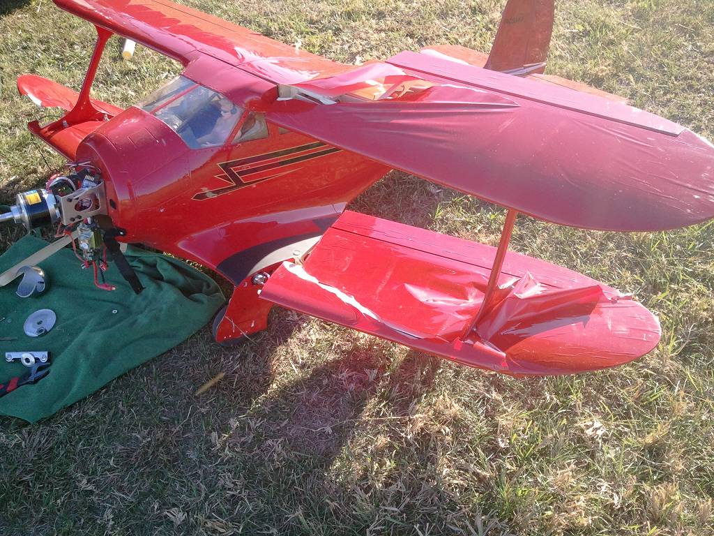

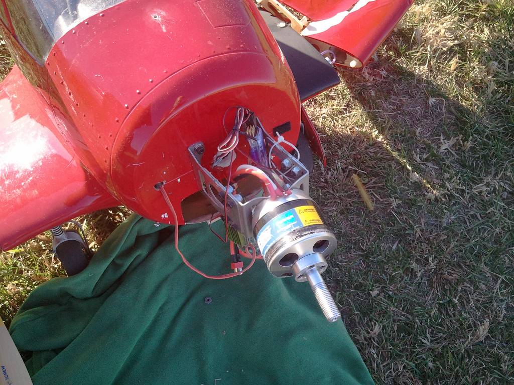

Well, this past weekend's flying session was not all good for me. My Staggerwing suffered another bad crash. Gonna need another set of wings.
No fuselage/tail damage. Small cracks in cowling from twisting moments, motor mount bent, but prop no damaged! No damage to retracts!!!!!!
Was doing a low level, high speed pass down runway, and just as it reached the end of runway, it suddenly quit. (Electric powered!!) Acted like it had hit low voltage cutoff, which I have set to hard, which requires throttle to idle, then back up to reset. But apparently not, as it would not restart. Instead of exchanging energy for altitude, which is proper procedure in high speed engine failure, i attempted "S" turn to return to runway for landing. I also, incorrectly, lowered landing gear almost immediately. DUMB!! [:@] This model does NOT glide well! Ended up hitting the ditch that runs along our access road along the edge of the dike that forms the north edge of our field. It missed clearing the ditch by less than two feet distantance, and about 8 inches altitude. (The ditch is a little over one foot deep.)
I tested batteries after crash, and they tested 98%. The cutout/crash occured just 1 1/2 minutes into flight. Pulled flight log from the Eagle Tree logger when I got home, and it showed that total voltage suddenly dropped to 5 volts, then returned to over 22 volts just before impact, which unplugged power leads because battery tray slid forward when velcro tap tore from mounting. Running 10 cells, 2X51P Impulse 4800mah 20C batteries. 42 volts fully charged. I flew them out in my Waco with no problem, so don't know what happened. Amp draw during high speed pass just before cutout was 65.10 amps. Motor specs for amps are 60 map continueos, 78 amp burst, batteries rated at 92 amp continueos. My logger set to record at 2 times per second. Drop off to zero occured in 1 full second. Voltage went back to 61 for one second, then back down to 5 volts over 3 seconds. Amp draw remained at less than one amp, since hrottle was closed. Need to do ground draw test of the Staggerwing system for more info. Logger is wired in between batteries and ESC, so it gets full info first.

No fuselage/tail damage. Small cracks in cowling from twisting moments, motor mount bent, but prop no damaged! No damage to retracts!!!!!!Was doing a low level, high speed pass down runway, and just as it reached the end of runway, it suddenly quit. (Electric powered!!) Acted like it had hit low voltage cutoff, which I have set to hard, which requires throttle to idle, then back up to reset. But apparently not, as it would not restart. Instead of exchanging energy for altitude, which is proper procedure in high speed engine failure, i attempted "S" turn to return to runway for landing. I also, incorrectly, lowered landing gear almost immediately. DUMB!! [:@] This model does NOT glide well! Ended up hitting the ditch that runs along our access road along the edge of the dike that forms the north edge of our field. It missed clearing the ditch by less than two feet distantance, and about 8 inches altitude. (The ditch is a little over one foot deep.)

Yes, primarily a set of wings. Since I now have two sets of damaged wings, I should be able to get a good rib template, and maybe draw a decent wing plan. But it's going to be the "want to" factor that determines when it will get done. Since this is the third crash for this airframe, I'm not going to be in any hurry, I'm afraid. I don't plan on destroying it, but it will be sometime before I even think about fixing it. I have four other "fixable" wrecks standing in the corner now. All of them may/will be fixed "someday."
