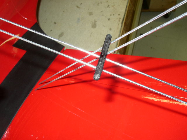

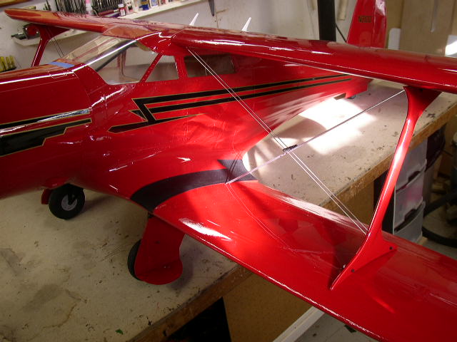

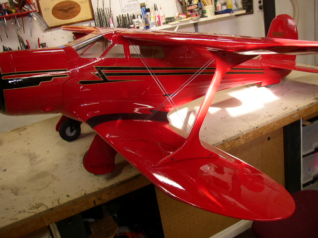

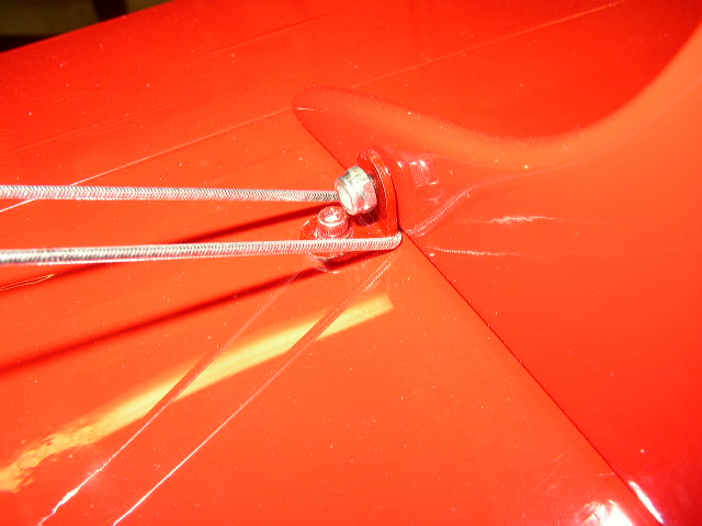

Got to have Flying Wires Dick!!!!

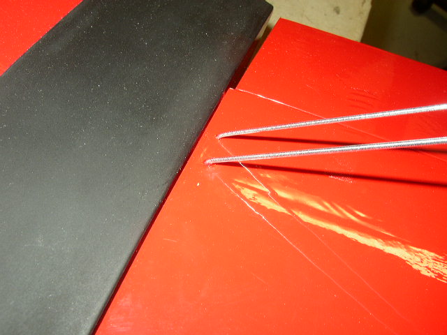

ORIGINAL: teamscalepilot
Those look Great!!!!!!! How and where did you anchor these. All of the orginal ones had wires didn't they.
Old 11-23-2006 | 08:36 PM
  #354
Joined: Aug 2002
Posts: 639
From: Ridgeland, SC
Default RE: Top Flite Staggerwing
I just drilled 2 3/32 hole in the wing 1/2" apart then wraped around the strut fitting. Be carefull not to get the elastic looped together or the wings won't be able to be seperated..

These pictures should help..

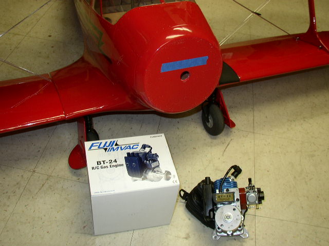

Using the Fuji 24 in mine. the version with the mag. vrs the electronic ign. You will need the nose wt. and you can use a standard starter on it!!! This weekend's project!!!
