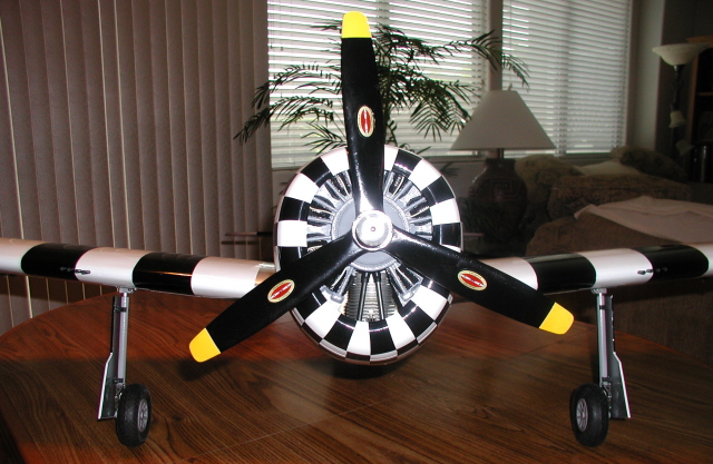

OK here is mine. 18 lb. 12 oz before nose weight for the CG balancing.
The Saito 180 almost fit undwer the cowl. I put Golden Knight rocker covers on it, so they would match the gold trim.

Jim,
That 180 install sure looks clean and, nice job. I would make one suggestion. I found that on my TF Stinson Reliant, I had to remove the rest of the material between the cylinders on the dummy engine. I was getting pretty hot head temps until I did that. Good luck. Now I guess we are all going to have to think seriously about TF's new Cessna 310.

I would leave the material between the cylinders for more efficient cooling. It will work as a baffle and create more air over the cylinder. Has worked for me many times with no heating problems.

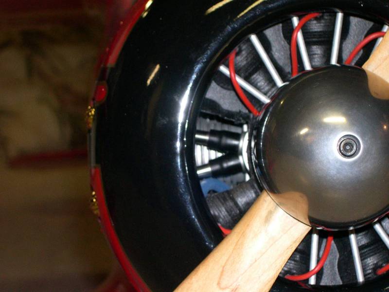

I balanced the model at 5.5" just inside were the wing and fairing join. I used a Great Planes CG Machine. The fact that I had to add so much weight does not surprise me since the RCS 140 is the lightest gas engines I know of. I will however recheck the balance before I remove any weight and will inform you here.

As I mentioned before, my engine is installed inverted with a Bisson Pitts muffler. Only the spark plug cap barely shows. I do not know if you can find an inverted pitts style muffler for the Evo 35, but if you can, I do not think that you will have to expose to much through the cowling.

I think you will be very pleased with your arrangement. In my case, I only removed two cylinders and the flat spot between them from the dummy engine leaving the flat spots between the removed cylinders and the rest of the engine. As for the exit, I only removed enough material to clear the muffler's exhause stacks. I have had no heating problems.
I wish you luck.
