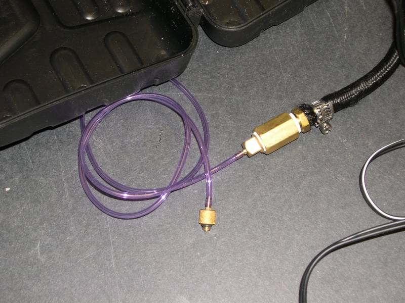

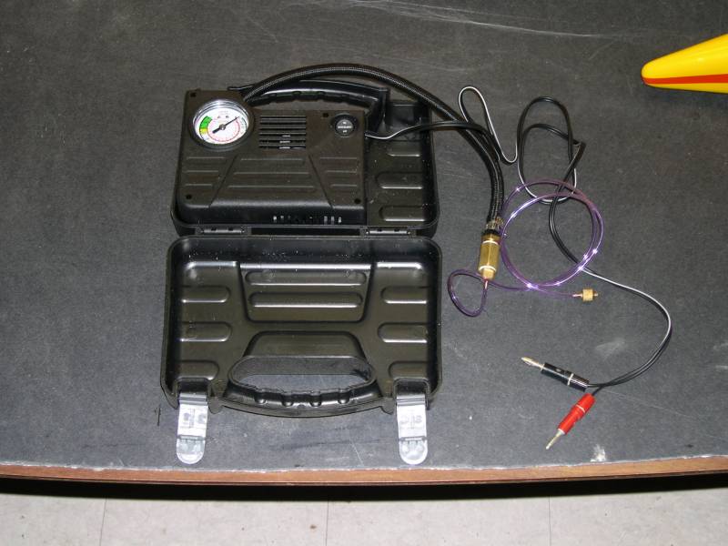

I am sorry that I did not respond to your inquiry of March 22nd. I see that someone sent you a reply, but I thought that I would give you the details of my solution.
As you can see from the pictures, my little compressor comes with it's own carrying case. The air hose loops in the handle at the top. Thei it extends down to the opening in the right side of the case where the end of it and the wire are stored.
I replaced the cigarette lighter plug with banana clips, as you can see.
I cut of the tire fill nozzle on the end. Insrt a brass barbed fitting into the hose and secure with clamp. Screw on a brass adaptor. On the other end of the adaptor is a brass plug. Before you screw in the brass plug, drill a hole in th end and insert a Robart barbed air line fitting. Secure the fitting with Red Loctitie. Then add a length of Robart air line and their screw-in fitting.
It works like a charm. The air tank fills to 100 PSI in about 5-6 seconds.
Jim K
