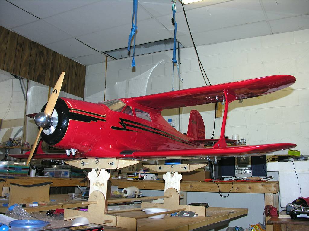

Well, it's getting there.
Servos all hooked up, engine/cowl mounted. Retracts mounted, but have been sent to Down and Locked for conversion to electric. Should have them back later this week.
A couple of questions. What sort of method do you all use to get the flap servo leads up to the receiver area to hook them up at the field. Looks like it could be a PITA! And second, I'd like to mount my batteries for flite pack and gear on the firewall , as together they weigh a little over a pound, but don't think they're going to fit. Any tips for getting them mounted right behind the firewall? Pretty tight in there. [:@] Won't be too much longer before it's ready to go!

ORIGINAL: Staggerflyer
I used a long (12'') Y connector. The ends just exit the fuse/wing joints. I use a rubber band to keep them available when the wings are removed. Yeh, sometimes it's a PIA when the rubberband slips off and I have to fish for the leads.
ORIGINAL: mobyal
Hmmm. Thanks, that makes sense. I'll try that. I used 12" extensions on the flap leads to give me some more room and was thinking about using string tied to the ends of the 6" Y harness running out the opening to fish them through. Hadn't thought of trying to lrngthen the Y harness itself, and it sounds easier. Thanks for the suggestion.
Al

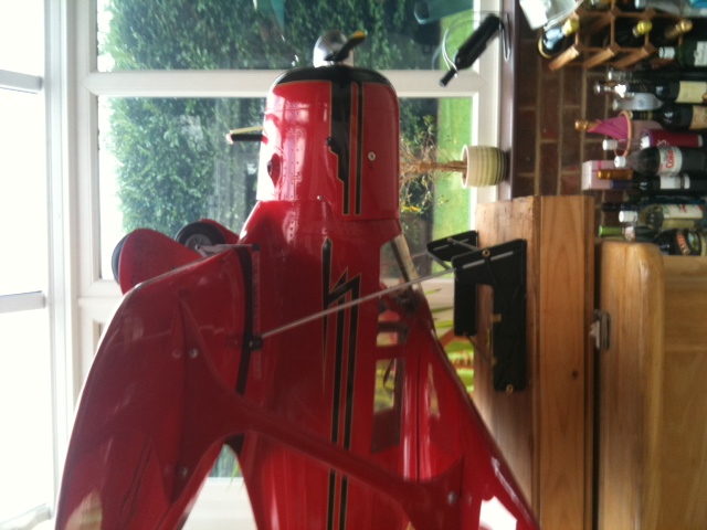

#1739
Posts: 818
From: Lenox Township, Michigan
ORIGINAL: njmheli
HI Guys.......
This is my SW on the c of g balance.........2nd attempt to get it correct as per your comments and flying experience.Should be good to go now..?
Kind regards...Nick (UK).
HI Guys.......
Joe M.

Hi,
Here are more picture of my radial install. Still need to seal the plywood plate.
Can someone with a flying SW tell me where the CG is with the wings off? Doesn't need to be precise just want to do a simple lift of the fuse with the engine installed to see where the radio is going to go.
Joel
