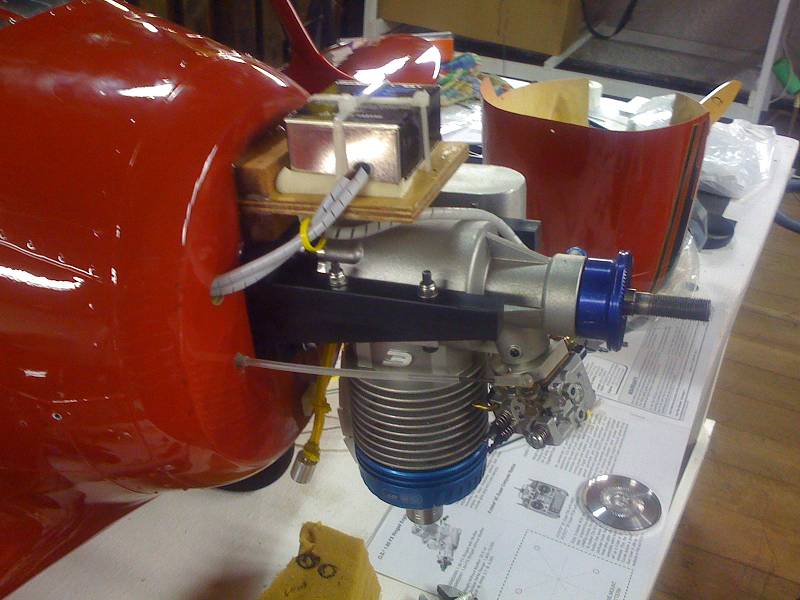

Hi!
Hi guys I have been reading this thread and was wondering what gas engine would be easiest and beest to install in my staggerwing I have a new os 1.08 that has lots of power has anyone tried that? thanks
I'm using an Evo 35cc on it with a great success!!!
Flavio
Old 04-04-2008 | 05:57 PM
  #679
rslstft's Avatar
My Feedback: (10)
Posts: 415
From: Tustin, CA
Default RE: Top Flite Staggerwing
Flavio,
I am about 1/2 way thru the assembly of the Staggerwing and am probably going to use the Evo 35 also. Do you have any pictures of your installation? Or can you tell me of any problems you had? What motor mount did you use and exhaust? Thanks.
Russ
Old 04-04-2008 | 08:08 PM
  #680
Joined: Mar 2007
Posts: 308
From: Rio de Janeiro, BRAZIL
Russ,
I'll upload some pics, but on a few days, because all my R/C stuff is in a barn in my mountain cabin and I won't go there till Wednesday.
Anyway, for now, I can tell you this: Evo 35 is a great engine for that plane. I used a regular nylon mount and a regular inverted muffler. Though, I love the solution Goetz did to exhaust a few posts ago.
I built a "T" of hardwood and glued it to the firewall to assemble the ignition and it works great.
Go ahead with the assembling and wait a few days before attaching the engine and I'll take pics of all of the engine mounted to give you an idea of what i did.
Flavio

Old 04-14-2008 | 07:17 AM
  #683
Joined: Mar 2007
Posts: 308
Russ and all,
As I promised, there goes the pics.
Flavio

Thanks Flaviosi. Those pictures will help. I hope to get to the engine installation this weekend. I have the same muffler and also the Evo inverted pitts, guess I''ll try them both to see which fits best.
Russ
Old 04-16-2008 | 07:18 AM
  #685
Joined: Mar 2007
Posts: 308
Russ,
The Evo inverted Pitts will do better... Let us know, though.
Flavio

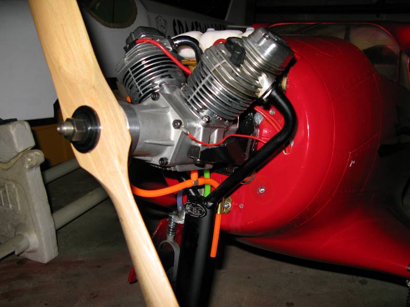

This thread has been quiet for a while. Thought I'd post an update on my latest upgrade. I decided that a little more power was needed, particularly at takeoff so I removed the Saito 1.70 radial I flew with last season and replaced it with an Enya VT-2.40 v-twin with McDaniel/SonicTronics onboard ignition and Keleo Creations exhaust. It's got unbelievable power and swings a 20 x 8 prop at 7,100 rpm. The sound of the big V-twin is awesome. I'm hoping to test fly it next weekend. Here's a link to a short video: http://www.rcuvideos.com/item/VXQYB27VYMQD1RSH
A few pictures:

GaGeeBees, I've got a new Staggerwing in the box wating for a 170-are you saying that its marginal power for the model? Saito 200 in-line twin?
Old 05-07-2008 | 05:07 AM
  #689
GaGeeBees's Avatar
My Feedback: (23)
Joined: Sep 2004
Posts: 1,413
From: Fayetteville, GA
ORIGINAL: blampkin
"Marginal" would not be the way I'd describe it. "Scale" is more accurate. The 1.70 is a wonderful engine and I debated quite a while before deciding to swap it out. One of the deciding factors was the fact that I needed so much ballast (in my case it was 26 ounces) on the firewall to make the plane balance. My thinking is, if I need more weight then I'd prefer to add weight in the form of more engine rather than just lead. Once in the air, the 1.70 is plenty and will pull the airplane through any maneuver appropriate for this plane - it won't hover and neither would the full scale Take off was the only time I found myself wanting a little more power in reserve. The 200 twin is an awesome engine and I would think it would be a great match but I have no experience with that one. Before I got the Enya V-twin I thought seriously about going with the new Saito 36cc gas engine. My 1.70 radial now resides on the nose of a Pacific Aeromodels clipped wing Monocoupe and is a perfect match for that plane.

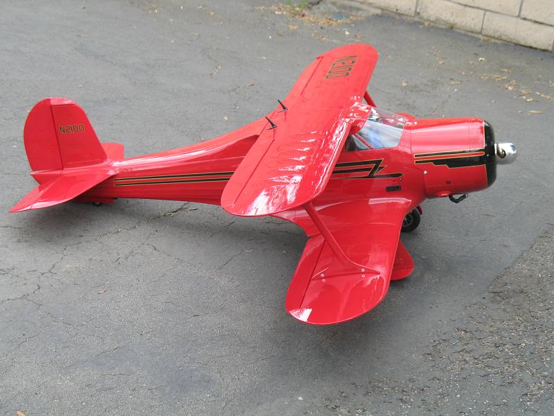

Well, finally am 99.9% done with my Staggerwing. All I have left to do is tune the engine a bit and fly her. Thanks to everyone here for the advice and tidbits of information, it was a big help in finishing this one. I ended up going with a Evo .35GT gasser with the Brisson muffler (the inverted pitts wouldn't fit - hit the firewall) and pretty much all the standard stuff everyone else used, good hi-torque JR servos (4721) on everything except the retract valve and throttle and Fromeco Li batteries on receiver and ignition. I heard everyone say that they had to add nose weight, so I moved as much stuff as I could as far forward as I could and ended up having to put about 6oz in the tail. Unfortunately, won't be able to maiden flight her for quite some time, travel alot for work and won't be home for month or maybe up to 3, but I'll let you know how it goes eventually.
Russ

Russ,
Just curious about the location of your N-numbers. I mounted mine on the right for the top wing and on the left for the bottom. I thought that was the standard location but maybe it doesn't matter. Any reason you went with the reverse?
Paul
Old 05-25-2008 | 02:44 PM
  #695
rslstft's Avatar
My Feedback: (10)
Posts: 415
From: Tustin, CA
No, Paul, no reason at all and you are probably correct as to the placement. I was at a airport recently and there was a Stearman sitting on the ramp and it had it's N numbers placed on the wing similar to what I did, so maybe that stuck in my mind when I put them on. Or maybe just cause I'm left handed??? :-)
Old 05-25-2008 | 05:48 PM
  #696
GaGeeBees's Avatar
My Feedback: (23)
Joined: Sep 2004
Posts: 1,413
I noticed today one of my flying buddies has a Hangar 9 Cub that has the numbers mounted like yours. Looks like either way is okay. Good luck with your first flight.
