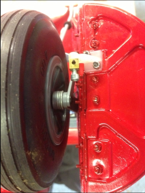

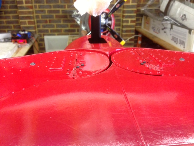

Hi Jon.
Have a look at the phot's of my U/C set up...........Hope these will be of help !!!
Kind regards..........Nick (UK)

So did you add another hinge to the door flap? mine only came with 2 hinges...My door flap is not warped....I can see how adding another hinge would help.
