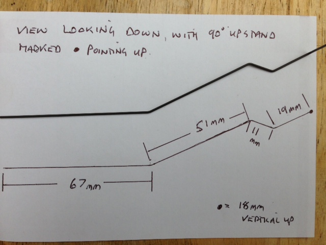

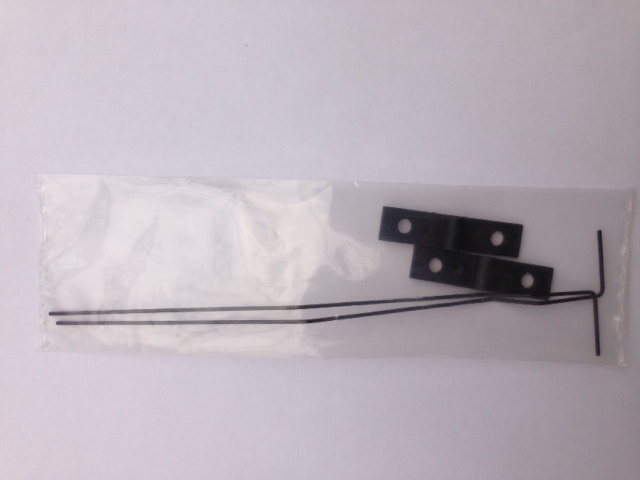

Been building the staggerwing, I originally purchased this un-built ARF from a member on these forms. The guy started to build it like do the hinges and stuff like that. but on the top wing he glued the aluminum bar on the wrong side of the wing. So I need to be able to separate the top wing for storage. I installed the top wing to the fuse with out gluing the wings together and it seems like it holds very will with just the nylon bolts. What do you all think will I be safe? besides that..the kit was shorted some parts but lucky I had some extras laying around from other kits. But unfortunately there were a couple that were not included
The nylon collars for the rear main struts on the landing gear to hold the gear door to it. Do anyone have any spares or an alternative for this? As well as that, the pre-bent wire/rod for the main gear door flaps is missing as well. Anyone have extras of those or an instruction or plans on how to bend them and what gauge rod I would need to make them if anyone don't have any. Let me know I'm currently at a stand still with this plane.

Hi.
Sorry to hear about your problems with your second hand purchase :
I would try and work out a way to just put a bolt on to lock the wing spar in place....just in case : my thoughts would be to try and duplicate what T/F have done in the other wing half ie: drill a hole in the other wing,exactly over where the spare slides in ( so that a bolt will push down onto the top of the spare to lock it in ). This bolt can be held in the wing using a "blind-nut" / "captive-nut" in reverse from the surface of the wing,so that the spikes will be sticking into the wing surface,you could use a thin bit of ply to ensure good strength and epoxy the "nut" to the ply,then the ply to the wing surface after removing some covering material.
The bolt then threads throught the captive nut and onto the top of the spar to lock it in.
Hope that the above makes sense.
For the U/C.........just use some metal wheel collets ( with the correct threaded bolts) of the correct dia of the U/C wire..........just the same job.
These are what you need for the door "flaps" on the U/C,see pic: Material is a "piano-wire" approx dia 1.01mm / 0.040"...have you got the plastic plates as in the photo..?

Hi.
OK..........have a look at these,let me know what else you need from the bits..... you may be able to enlage the photo's to size as shown..?
Kind regards...........Nick (UK).

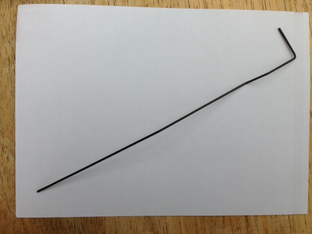

Hi.
Some "angles" for you,hope this helps............
Thought of making your own plastic collets out of a piece of plastic rod..?
Kind regards.............Nick (UK)

Got those wires bent up like they should and installed...I don't know if I have them installed right or what? when the gear goes up the wire binds with a part of the gear causing the back part of the flap on the door to bend up. Is this normal? Anyone have any pics or video of the gear in action? would be much appreciated.

Hi.
Very nice looking S/W,looks great with the 200 sitting up front !!!
I too had the same problem,but you may be able to "dial" a little bit of that out.........as it is just in the geometry setting,I kow that you bent up the "rod" from the details that I posted,so if the door is working,you cannot be too far of the correct setting.
My fix to get the door flush was :
1/......try to shorten the length of the rod where it is clamped to the "half-door".......takes a little bit of time,but you may get it a bit better.
2/.....I was lucky enough to purchase another set of gear doors and fittings from "Omnimodels in the US " ( hence a spare set of rods that I gave you the dimensions for )...I then took two of the hinges off of the spare set and bolted exactly where the door appears to "bend up" when retracted on each door. ( the rod then takes up the retract compression for the door being held flush by the hinge )..........PROBLEM ALL SOLVED and nice flush doors !!!
It's not too much work and I'm sure you can get another hinge..............a piano type small hinge..? ( as used in what we call here in the UK "Doll's House" that children play with,from a craft store maybe ).I think that you will find that T/F have used metal hinges on the doors..
If you look at mt U/C video again,you should see the extra hinge that I fitted....
Hope this helps.........But I know you are on a very tight schedule for your Model Show.....hope it all goes well !!!
