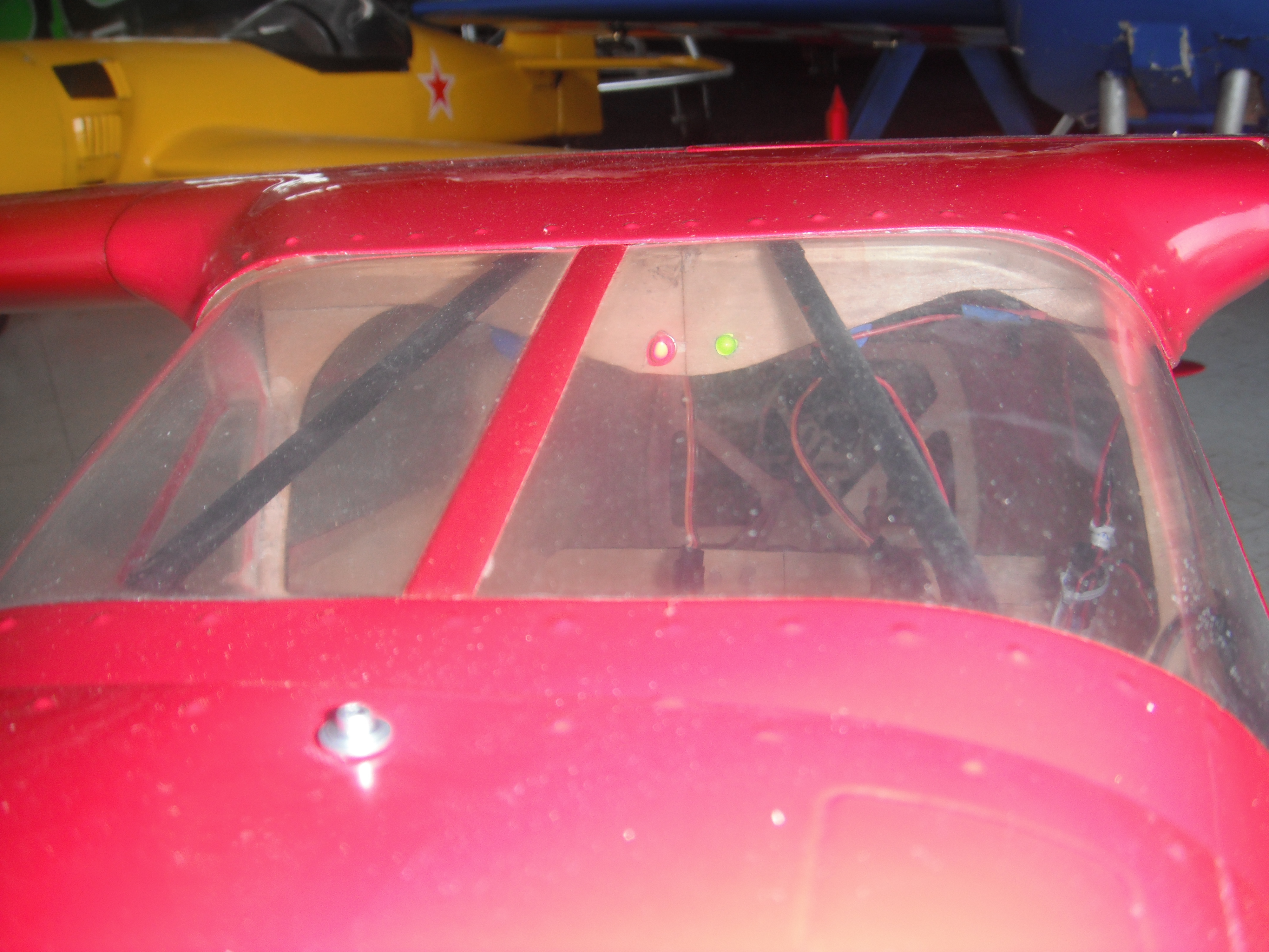

Bill looks like you had a great first day with your Beechcraft model

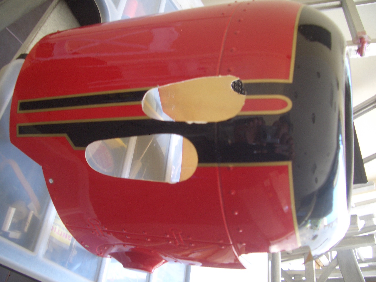

I acquired this Staggerwing a few days from a fellow who had only flown it a couple of times. It is complete with the Robart retracts and a Chinese 52cc twin cyl gas engine (and a ton of servos)
The model is in great shape except for the cowl that has some holes cut (hacked) out of it to accommodate the sparkplugs of the twin and necessary cooling outlets.
I will give the model a meticulous going over and will change a number of things simply to do them in my way.
I am also contemplating yanking the twin and installing a 45cc single cylinder. This will allow me to repair the holes in the cowl.
This thread is really a wealth of info for this particular bird thanks to all those that shared their knowledge and experiences.
The only items I am missing are the two lower wheel well covers and the wire actuators. If anybody has these that they do need I would gladly pay for them.
Mike

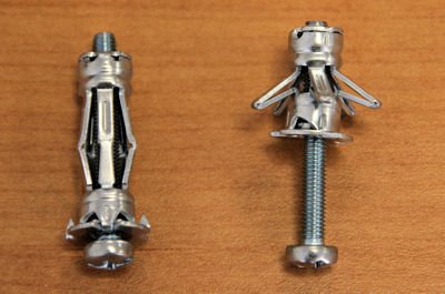

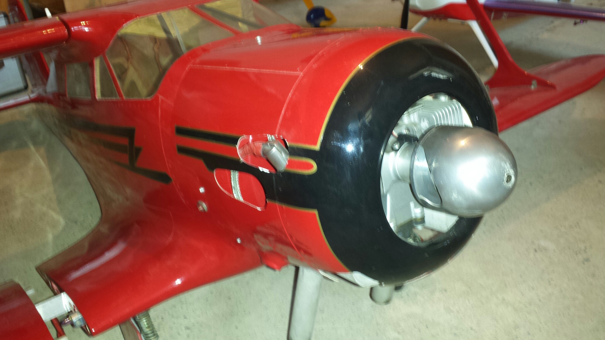

Very nice! What are you using to secure the cowl? I have been trying to find something like spring loaded rivets such as what is used on real aircraft access panels, but nothing small enough for this application.
Old 11-08-2014, 01:32 PM
  #1859
Iceman 29
Iceman 29's Avatar
Join Date: Sep 2007
Location: Locquenole, , FRANCE
Posts: 9
I use "grip nut", glue with epoxy inside the fuselage when it's possible, when you built your plane.
Otherwise for ma Bearcat ESM, I use this type of nut, for wall mounting. Not so light weight, but it's forward, so.. Less weight to put in the noze to balance the plane!
And this "nut molly type" is very interessting because you can install it without dismantle anything if you have cowl fitting problem.

Thanks Iceman 29. I think I'll try the "nut molly type." Hopefully I'll be able to get them in as I can't get inside the nose anymore. I see you live in France. My wife and I lived in Germany and Italy for 17 years and finally had to move to the USA if I wanted to keep my cushion job. Sure wish we still there!
If you look really close at his picture you can see slotted screws such as the one the arrow points to in the included pic. At least it appears to be.

Yes, for this one, it's nylon screws painted in red.
Your welcome.
Yes, i live in north west of France (Brittany). http://baiedemorlaix.files.wordpress.com/2012/01/ilelouetpano.png
For molly, the problem is the diam of the screw (Diam 4 mm minimum, M4) So, it's a little bit bigger than a normal screw used for this purpose. An allen (button) screw can reduce the size of the head.

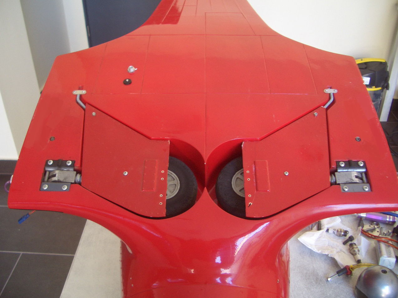

So, after years of waiting for a giant scale Staggerwing, would you believe I scored both the Topflite and the Byron Original inside of 2 weeks! The Bryon is the complete unbuilt kit w/retracts and the Topflite was started, but abandoned after building the wings and installing the main retracts.
I've triaged the TF kit and noticed a couple of missing parts that I hope someone can help with. Most importantly, the gear door actuator wires for the main and tail are missing, as is the cabin floor, dummy radial and the tail wheel retract mounting brace.
Anyone aware of a source for these parts? Especially the actuator wires and tail wheel mount.

With regards to the main gear door flaps, I agree, on grass they'd rip off sooner or later. I should still be able to run the covers over the mains without the flap part or the actuating wire to open.
On the tail wheel, I was hoping to install the tail wheel retract with working doors. Perhaps off grass, these doors may create a problem as well?
If this is true, then all I'm lacking is the tail wheel mounting brace and as near as I can tell, that part doesn't have a discrete part # to search online for???

In my opinion unless you fly from a paved or similar runway you will eventually rip off the tail gear doors. There is very little clearance between them and the ground.

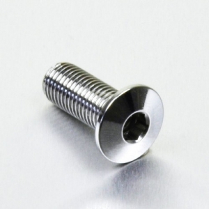

BTW, I just noticed my kit did not come with the top wing securing screws. Can someone share size and/or part #?
Cheers
