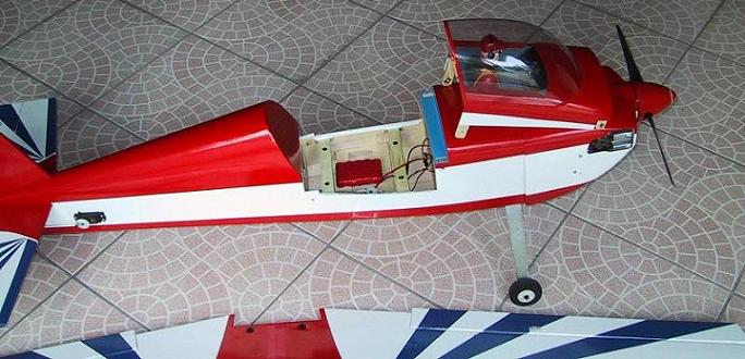

hi boy
mine fly well on thunder tiger 91 fs,not extreme 3d ,but hover 1/2 trottle. i plan to switch to a YS FZ 91 with 15/6apc next week.
the only think i disagree is wing spar
regards mirco

Wow, thanks for the pic wolf123. Do you think the added power of a Magnum 120fs would be a good tradeoff for the weight? What 3D stuff have you been able to do? Will it harrier at all?

Does the model come with decals? In a pic from a distributor I saw "Edge 540" and star on the fin(also some stuff on the cowl). But, I don't see them on yours(I can't really see the fin though).
How much ground clearance do you have with a 15x? prop, could it take any larger?
What don't you like about wing spar?
Thanks!

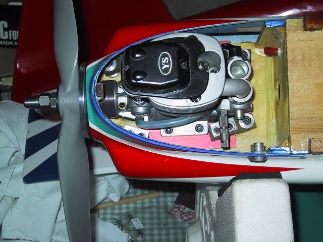

for motor i try to put YS91 but is too long for engine bay

ptarp
the distance between firewall and spinner right out of the box is 125 mm,consider YS91 have airbox that touch motor mount, the thickness of motor mount(dave brown ) is 9mm. you have 116 mm
of available lenght
this afternoon i make more pics of engine bay and put it
regards mirco

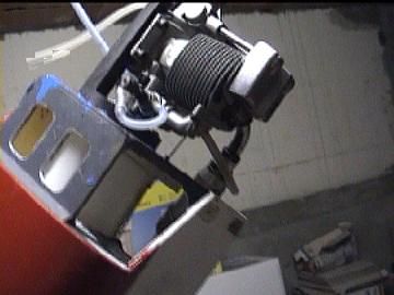

first

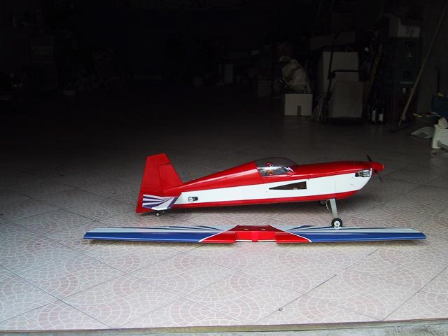

second

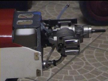

3

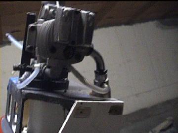

four and last

wolf123, is that the "stock" method of engne installation? What is attached to the end of the muffler? Is it included in the kit? Also, are you sure a TT 91 would hover this model at 1/2 throttle? Someone earlier said that a Saito 100 would take 60% throttle. How easy does it pull out of hover? Here is a link that says the specs that I found http://h1070453.hobbyshopnow.com/pro...1025&ptab=tech

no i replaced the stock mount with a dave brown model.attached to muffler is a silicon tube normally used to connect pipe and manifold on 1/8 racing cars. yes my tt91fs with a grauner 14/7 black hover at 1/2 trottle(fuel 20 nitro 20 sintoil 60 alcool). my model weight 3.3 kg. the first ten flight i've used a YS FZ63 but vertical not good (Ys with a 14/5 apc). i don't have use saito 100,normally i use YS on all my model.
