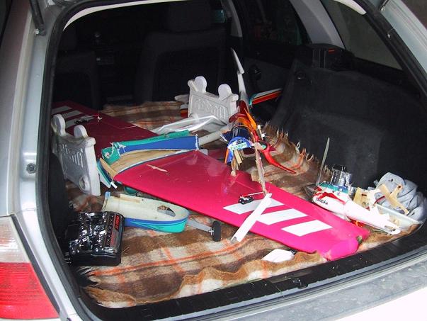

adrian
but i have mount trottle servo in the nose(like battery as for intruction) to keep balance!and save gr.i think the structure fail with extra power of 120, not speed but shake
stay tuned
regards mirco

Since your plane crashed, I am not sure if I want one now. I guess I will just get a U-Can-Do-3D. Thanks, Conrad

conrad the plane crashed is a kyosho g-trick90 not a seagull edge 540t
