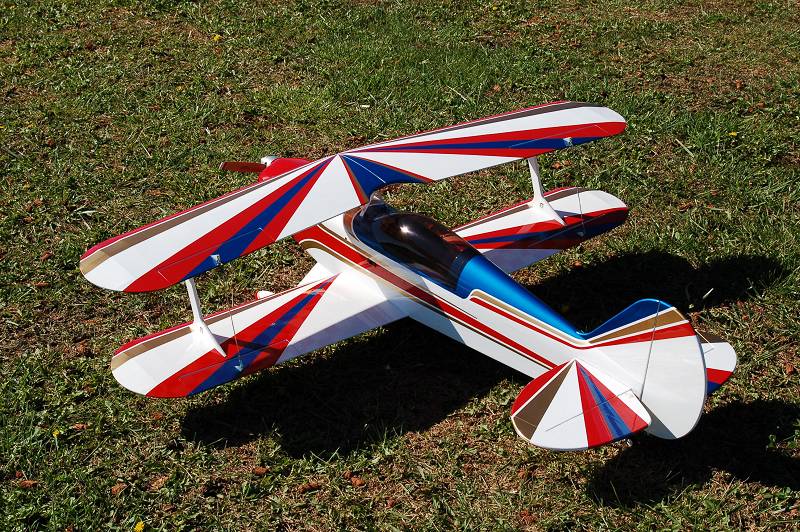

Out of curiosity...
My Skybolt pulls toward the belly HARD when you attempt a knife edge.
It exhibits the same behaviour with high rudder deflections in level flight.
Does everyone see the same thing?

Depends on the definition of HARD.
Being used to dealing with a tuck and roll out of almost everything I fly, I'm not a good one to judge degrees. And will trim the rudder couples down (never bother to try and completely erase them as they're often speed sensitive somewhat) with the first flights. And rudder couples are so often encountered it's hard to remember which planes showed what degree back in the first flights. Plus memory goes with age.......... If I remember correctly.
I make a habit of trimming out rudder couple on any model that shows it on purpose. Not because I can't fly knife edge without help because I can. And not because I'm lazy and don't want to. It's because you really need to fly the takeoff and the approach as you come over the numbers with the rudder. Ailerons can kill the airplane at low speed, high AOA, close to the ground. So I fix that early on.
A push toward the belly is actually a nose down pitch. And darned if I usually want to be changing pitch on takeoffs and landings with the rudder. If I want pitch changes then, I want them to come from where they oughta come from.
I actually base the trim corrections on the behaviour in level flight. Since that's closer to what takeoffs and landings are like. I'm not sure that doesn't fix the knife edge but to me that's not of much importance.

Bipes all tend to do the same. Here is the mix I use in a knife edge:
Rudder Either direction mixed to -
Up Elevator
Opposite Aileron (opposite to the way it will want to roll)
This will also make your rudder turns very flat.
I also give a throttle to rudder mix to correct any thrust issues.

I maidened mine last week, ended up with 8% elevator and 14% aileron to mix out the coupling. Controls remained responsive and even throughout the rollers and KE flight with these mixes. Flat turns were flat and easy to maintain.
I thought I was having thrust issues with mine (Saito 1.25 on the front of it), but it started lurching the opposite way(left) on some of my uplines. I dialed in some expo on my rudder to tame it down around center a little, and it is easy to keep it pointed up now. So much motor for it, if your not pointed perfectly straight up it wants to go off to a side. I don't know that i would mix rudder to throttle, because the thrust issues will change depending on which direction you are pointing and how hard you blip the throttle.

"Hard" as in full rudder deflection from level flight causes a relatively fast nose down move ( I'll have to try this inverted next time too), as if I had pushed the nose down purposely at full deflection.
My Ultimates pull toward the belly too ( and they also roll a bit ), but I can easily compensate with a little up elevator and aileron.
The Skybolt surprised me as I cannot hold a knife edge on it at all.... and I have no problem doing so with most planes even when they have a high dihedral such as my Spacewalker II.

Mix it out. Mine did the same thing, as I stated above, 8% elevator and 14% aileron mix and it fly KE all day long. it will even do knife edge loops with enough altitude. The funtana X100 couples to the belly much "harder" than the skybolt does, and is not that uncommon.

opjose,
Actually I was wondering how hard it tucked. Mine was pretty awful. Fairly hard. Roll was just as hard.
And I don't have my TX up here to check, but I fairly certain my percentage of elevator trim is 8% but I'm pretty sure the aileron percentage is also 8%. No idea why they would be half what trixer needed. Ohhhh wait.....
You know what. You remember the discussion about aileron rigging for the Ultimate? Bet you do. Well, my Skybolt is rigged the same. And the ailerons work in unison not at different rates of deflection. I'll be darned. That's basically an indication of the value of rigging the ailerons to work in sync, not basically skewed. How bout dat...... I'll bet nobody could tell anything about the way the two different airplanes fly, but there is obviously some difference. Kewl.....
Remember the rigging deal? Picture shows the Skybolt's.

Right, and I am saying the the ailerons on my skybolt are equalized. All 4 have the exact same throw up and down...... So I don't see what the difference is?

Nope
The tucks and rolls are going to be basically equal because they originate from the rudder deflection. Nothing else. But the trim required to cure the problem...... that's the clue.
The amount of deflection required seems to be less than Trixer. That'd indicate that the lesser amount of trim is giving equal results as the greater amount of trim. That should be an indication of the cleanliness of the ailerons overall effect.
