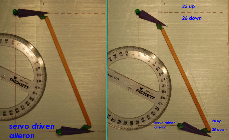

4/ I understand the aileron differential thing but honestly, you'll never notice it
Nah, it don't. But it is worth an observation.
No matter how wonderful anyone thinks what he is doing works, if he hasn't even seen the alternative in action, he honestly has no idea if the alternative even works, what it does, or much less how well it works.
It has been said many times that almost everyone who has flown the stock Skybolt loves it. And that the aileron rigging improvement does not cure problems that happen throughout the flight envelope, but do SEEM to give the airplane a bit cleaner response and appears to not do some of the things others who own Skybolts have seen.
It's also less work and a stronger installation to do the suggested rigging improvement setup. There are two motives. Have all 4 alierons move equally to equal stick input, AND the new rigging arrangement actually takes less time to do. And doesn't cost anything at all since it uses the supplied hardware with simple and quick modification.
I have actually flown Skybolts without the modification. And unlike the detractors of the rigging mod, HAVE flown the "differential thing". And I did notice that the OEM Skybolts seemed a touch "muddy" in response to tracking when ailerons were effective.
As for labeling it "the differential thing", that naming suggests whomever calls it such seems not to have understood the better rigging removes differential, not causes it.
But hey, this really isn't war over a little thing like that. We fly ARFs, and when you do, you accept a lot of little things you might or might not build into your model if you did build it. This is another, like getting a LitePly firewall, that is supported around the upper third by nothing but a 1/2" foam fuselage top sheeted with 1/16" balsa. If you only have time to improve one thing on that Chinese ARF interpretation of an excellent old US kit design, then put the time on the firewall improvements. Since you probably won't be building two Skybolts to compare the aileron response, and the OEM users are perfectly happy with what they did, doing the rigging improvement won't prove anything to you, but it will reward you with the knowledge that you do have an airplane where all 4 ailerons move the same amount at the same time. For whatever that's worth to you.

da rock... You seem a little put off by my reference to the "aileron differential thing" and I appologize for that if you took offence to my wording. What was intended by my comment to dgrant was to say that if the plane is built according to GP's instructions, it will still fly just fine. Maybe not perfect but nevertheless, just fine ! You're absolutely correct when you state that I (or anyone) who hasn't seen the alternative has no idea if the alternative works however, I never said anything about it not working as you seem to think I did. In fact, when I read about it (the aileron linkage mods) in this thread, I was quite intrigued, interested and very impressed ! Let's face it, the Skybolt is not a high-end, high-performance aircraft but I would suggest that most that own it do a lot of casual flying with some simple aerobatics and would be more than happy with it just the way it is. The problem with forums is that there much like e-mail... People get 'bent out of shape' when they read other's comments without stopping to think about what is being said. They're too quick to judge and fire-off a 'snot-a-gram' when they're a little offended for no good reason. Enjoy your aileron differential !
#540
ORIGINAL: Lumpy n bumpy
Not put off at all. That's why I kidded about "This is war".
Lots of people see what they see, no matter what is said. Same with an airplane in the air, only in that case, some don't see. And that's especially kewl if it wouldn't matter to 'em anyway....... see?
But I would like to try to make it clear once again that the "aileron differential" isn't mine. The OEM rigging gives 3 different deflections every time the 4 ailerons move. And they don't actually give the deflection that is usually rigged on purpose to help some models bank-turn that everyone calls "aileron differential". I'm basically trying to make sure everyone understands that this isn't about the "aileron differential" everyone talks about. And that the OEM doesn't give that aileron differential, and that my suggested rigging removes any differential so the airplane will actually see all 4 ailerons move the same amount.
You intended in your comment to dgrant exactly what a number of us have said a couple of times over about the OEM rigging. The Skybolt flies great for many, many people with that OEM rigging. And most flyers won't see the difference.

well i don't get it at all Rock............i set my Skybolt as per GP instruction and i don't see any differential at all........i get the same up and down deflection with the stock setup.............
With the stock setup, there will be differential, and it will vary on the uppers depending on whether they're going up or going down.
The basis of that is the basis of a major cornerstone of our R/C world. If you do not have a right angle from the pushrod to the servo output shaft, the pushrod will move a different amount one way than the other, and the same for a right angle at the hingeline. That one idea is a cornerstone. The pushrod at the servo should make a right angle and the pushrod at the horn should too. We all preach that, don't we. And it applies to rigging that is one pushrod connecting two horns.
In the case of a biplane, and that OEM configuration, the wing stagger causes most of the problem. And the Skybolt has a stagger. In the case of the Bolt, the critical stagger is where the two ailerons are joined. And there is stagger there. But you can solve that minor problem if you place the horns where the pushrod connections give the right angles at both top aileron and bottom aileron.
When I first mentioned what I'd done and how easy it was, it wasn't well accepted on these forums. And just the explanation of what "should be" by the "right angle rule" wasn't good enough. So I made up a display/test setup. The actual measurements of the airplane were used. You can see that layout in one of the attached pictures. It shows what I got when the lower ailerons are the drivers. My little Ultimate and my Skybolt both are hard to measure with dependable accuracy so the getup solves that problem Plus a picture is worth a thousand words. (Unfortunately, I often spew out at least a thousand words as well.....
I never tried to measure on the airplanes, 'cause I never had them rigged the OEM's way. But I have looked closely at the other Skybolts I've been lucky enough to test fly. And I could see what they did. Truth is, at least one owner never did see it. And I'm not sure the others did either. The beauty of our hobby is that very often, there are two ways to do something and the worse of the two ain't bad. And the beauty of the Skybolt is that the stock built one is a heck of a good flying model. I won't say that about the little Ultimate, because I have flown stock ones that were treacherous as hell. And mine is only a bit sneaky.
BTW, I don't get royalties out of this deal. And I'm not selling my patent on the design.
Another beauty of the hobby is we can do anything we think works. And I'm not suggesting otherwise. BTW, I do offer a guarantee with all of my priceless advice. If you are not entirely satisfied, there will be no additional charge.
Good flyin' wid' ya' today.
#544

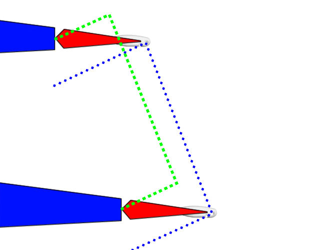

Oh yeah, that first attached picture above isn't a depiction of either the Skybolt or the Ultimate. I made it up just to show what the ideal right angled rigging would need to be. The green dotted line would be a rigging that has a right angle for the top aileron and a right angle for the bottom. And the discussion was about linking ailerons at the TE. Which also works pretty good.
The point of the right angles on the green lines would be where you'd want the horns to connect to the pushrod.
To tell you the truth, I'm completely baffled why a manufacturer would do what they did with the Skybolt and little Ultimates. Eventhough it's been done by others, it's never been done on purpose for larger biplane models, and for a pretty good reason. Have you ever seen a big bipe, or any bipe with individually driven ailerons where the mfg wanted you to adjust the upper servos to give such wierd deflections?

Unfortunately, the differential comes from the rigging. With either the OEM rigging or my suggested rigging, the lower ailerons move equally both up and down. The differential results from just what has been shown in the pictures, rigging that changes how much the upper ailerons move. No way the TX can dial that out.
#547
Here's what happens with the OEM setup.
When you move the TX stick, both the aileron servos in the lower wings move the aileron they're rigged to whatever your TX stick movement tells them to. Lets say the TX movement says 20degrees. Both those ailerons on the lower wing move 20degrees. One moves 20 up and the other moves 20 down.
When the aileron on the downgoing side moves 20 degrees the OEM rigging pulls the upper aileron it's connected to 26 degrees.
When the aileron on the upgoing side moves 20 degrees the OEM rigging pushes the upper aileron it is connected to 23 degrees.
The OEM rigged Skybolt sees 3 different aileron movements from your one TX stick command. And that is caused by the way the pushrod is connected, mostly from the way it's connected to the upper ailerons. The lower aileron hardward actually is pretty close to giving the prescribed 90degree setup.
