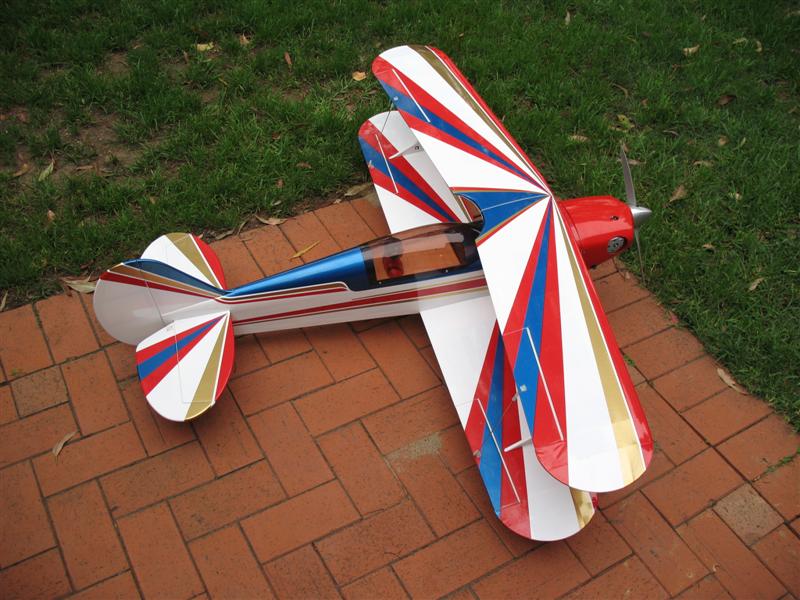

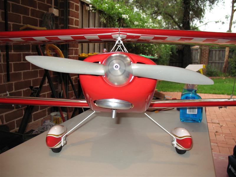

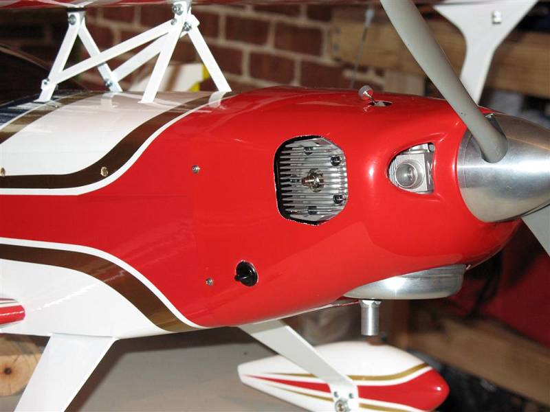

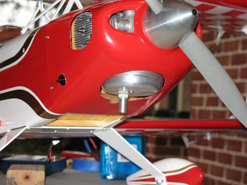

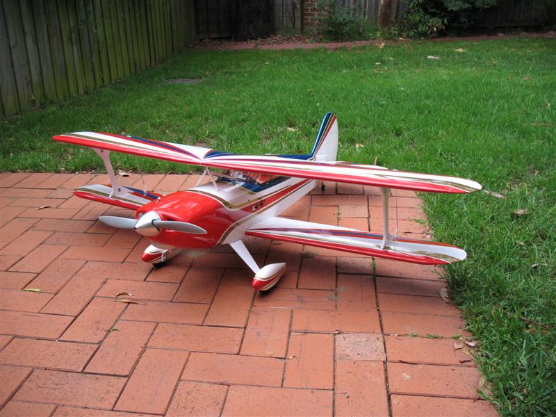

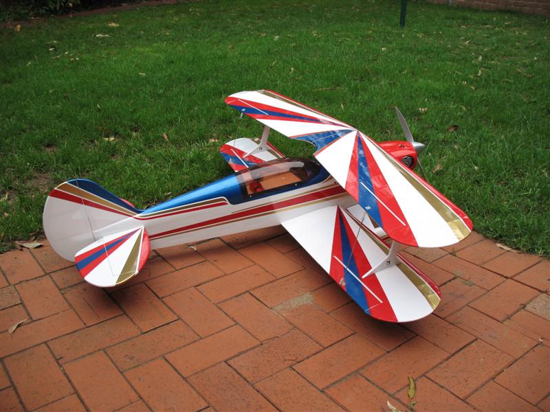

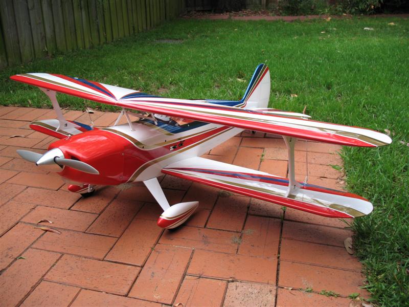

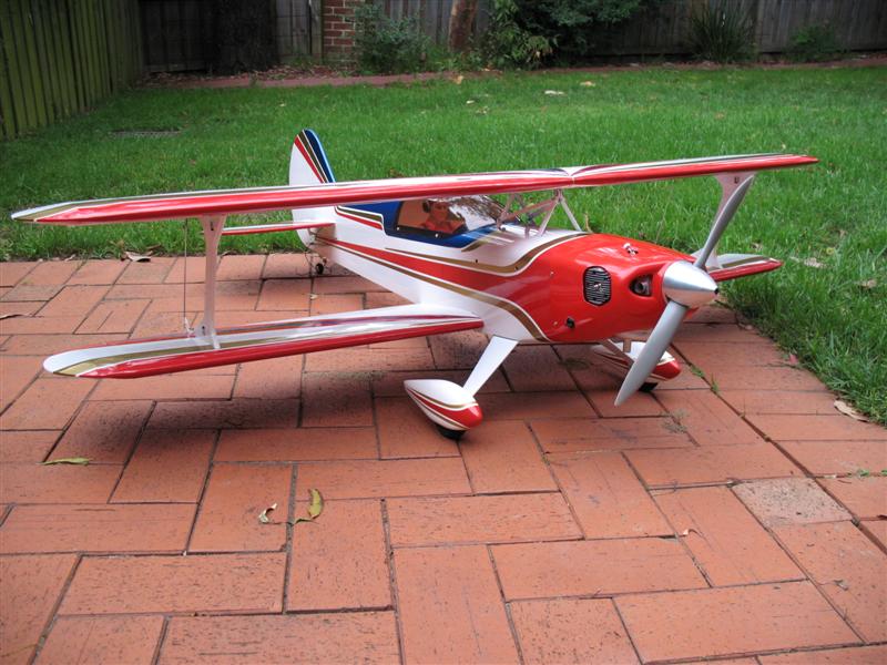

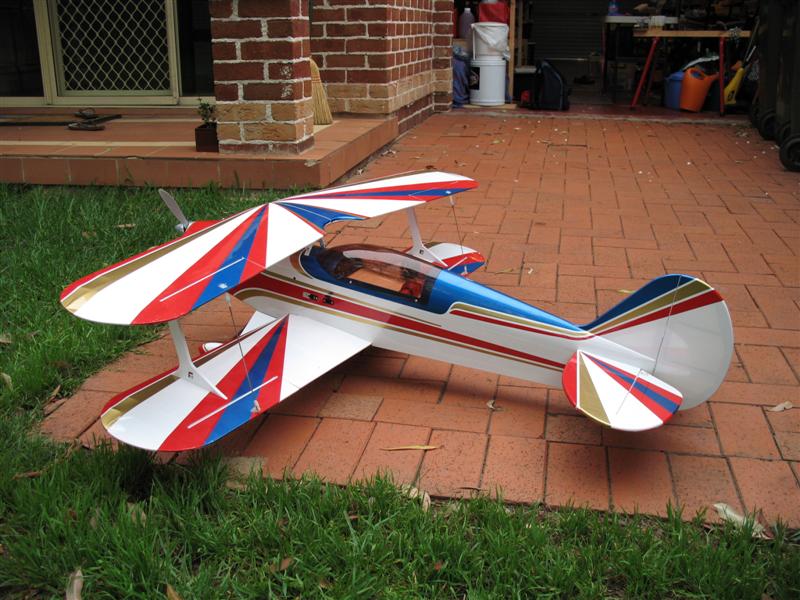

Here are some pics of mine now that it's complete and ready to maiden.
What's the concensus on the CofG? With the battery in the standard location my CofG is a finger's width behind the suggested mark. It takes 4oz of lead just behind the firewall to ballance.
I could move the battery forward so i don't have to use the lead, but i'm reluctant to do so if the recommended setting is conservative and i'm only going to have to move it back.
I'm thinking i'll stick the 4Oz of lead in the nose and remove 1/2Oz at a time until i'm satisfied. Then i'll experiment with battery locations to find one which gives me the same CofG without needing lead.
Update: It flies great with the battery in the stock location and no additional lead in the nose. My motor/muffler weighs in at 25.4oz (720gm).

Custom, you could use a 1 oz weight in the spinner, or a heavy nut, and that would go close to puttin the CofG in the right place for alot less added weight.

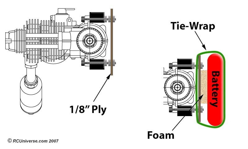

CustomPC, I put my battery up front (Before I switched engines). Here's a good way to do it:

What motor are you using now and how much does it weigh with pipe?
My motor weighs in at 720gm (25.4Oz) with the Turbo-Jett Muffler. I believe that is slightly heavier than the suggested 91 Surpass.
I've read some posts that say the suggested CofG is very conservative, and i've read just as many posts saying they moved the battery up to the front to achieve the suggested CofG and were happy with the way it flew.
