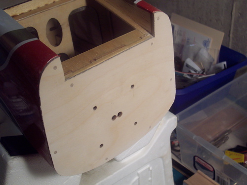

I have been following this thread as I have been working on my Super Skybolt over the last few months. Based on what has been said about firewall integrity, I decided to beef things up. So this is what I have done: I drilled and tapped the landing gear screw holes out for 4-40 bolts instead of using the supplied machine screws. I cut a temporary access hatch into the fuselage underside. I will permanently put it back later. This cutout has allowed access to the firewall and around the landing gear. I fiberglassed around the landing gear on the inside. I traced and cut an additional firewall laminate from 3/32" birch ply. I sanded the face of the existing light ply firewall to prepare for glue. I pounded out the blind nuts, put 1"square 3/32" birch ply pieces underneath them, then reinstalled the blind nuts. I glued the firewall together and pulled the blind nuts snug, using the engine mount as a handy "clamp".
V6

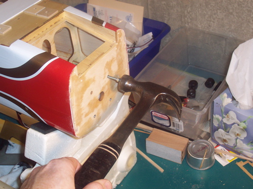

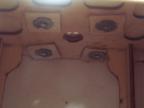

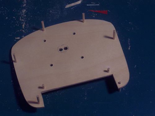

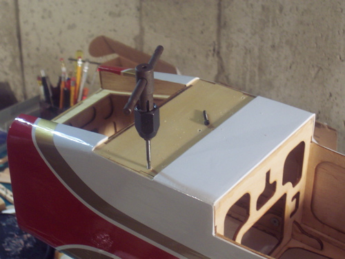

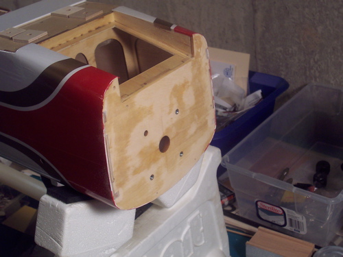

Pictures of Super Skybolt ARF front end mods

Vinnie6;
Mods look good. Looks like you "dowl pinned" the firewall to give it some bite into the fuselage edges and strong points? Is that correct? Can you elaborate on this if necessary?
Eric

ORIGINAL: Racer944
Eric
Eric, you are absolutely correct. I used 1/8" hardwood dowels, one inch long, around the edges to really make that firewall be a part of the fuselage. The reason being I couldn't really clamp it together when I glued it except for bolting on the engine mount, but obviously that didn't hold it tightly around the edges. Maybe it's overkill...
V6

V6.....great looking mods to the front end...........and a great addition to this thread.......i'm definately doing that to my next skybolt.
making an access just behind the FW makes perfect sense................the one i have now had to have the battery mounted just behind the FW, and it was a royal pain to get it in there and padded.

ORIGINAL: Vinnie6
V6
Excellent move.
Basically what I did, only you did it before instead of after. I wish I had known before the failure how weak the design is.

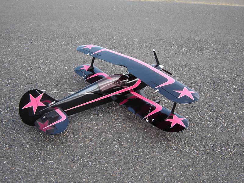

Well, try this one for something different. Mind you, this is a kit version. MM
