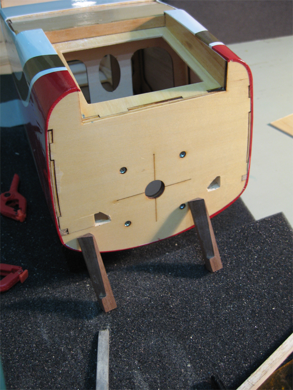

I have the YS 1.10 in mine. Pulled the firewall right out of the front of the fuse. And yes, I did reinforce the firewall. It happened right on final about 1 foot off the ground. I was flaring and the whole plane dropped. It spread the landing gear, but that was the worst of it. The break off the firewall was a clean break, so it was an easy fix.
I also have VERY fast coreless motor servos. This biplane is amazing!

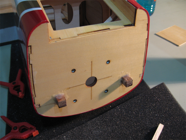

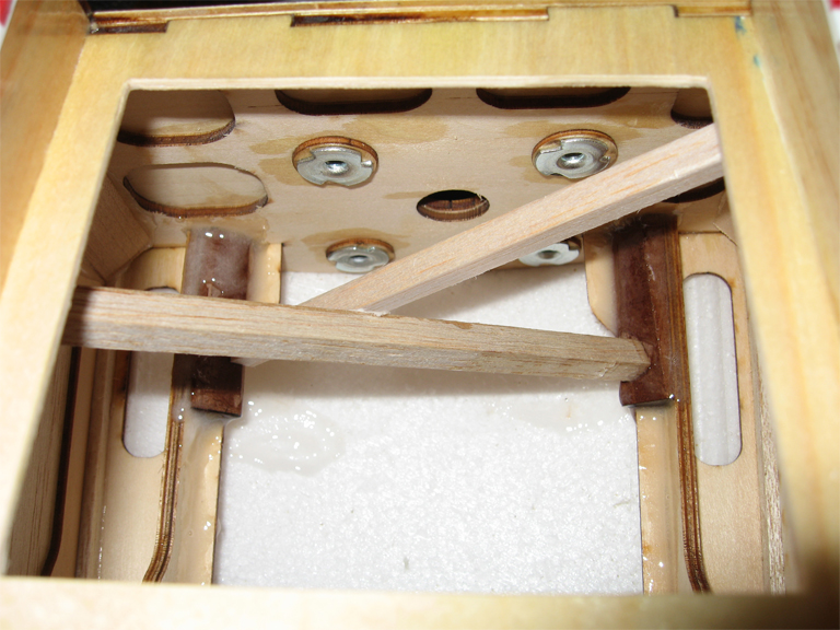

Yes, it seems that now Great Planes adds tristock at the left and right sides behind the firewall. I was planning to power my SS with a new FS-110alpha, yet the extremely high cost of glow fuel here in Greece changed my mind and I'm now waiting for a RCGF 20cc engine to come. The other owner of a SS with a Zenoah and his reports were also a reason. What I did to reinforce the firewall was to somehow "bolt" it to the structure behind it. Below are 3 pictures, the first one showing the 2 holes opened on the firewall, the hatch to be able to work behind and the 2 "bolts" (notice their shape), the second one shows the back side of the firewall with the reinforcement installed (and you can see the tristock at the sides) and the third the final front side. I still do not know if I'll have to trim the heads that protrude, but I guess that with a gas engine on stnad offs that will not be necessary.
As you can see at the first picture, the sides structure does not fully contact the firewall, and that is because the inside lamination of the firewall is cut slightly bigger. So the sides only contact the firewall at half its thickness. Do you think that epoxying a stripe of fiberglass around the firewall would be necessary? Weigth is an issue with a gas engine in front, though I guess total weight will not exceed the one of the kit.

i know it's the reason why they recommend the lower powered engines, but with the Skybolt it's like buying a Corvette with a straight "6" because the frame isn't strong enough to hold an "8"...................
EXACTLY!
I don't think it would hurt at all. Weight won't be an issue, you'll be fine.
There was tristock on mine, but the left side didn't even contact the firewall. Apparently, I didn't add enough reinforcement either. However, after getting it all back together, no one can tell it ever happened to begin with. I'll be adding fiberglass on the outside of mine. She is just too sweet to not put into the air and beat the snot out of! [8D]

From: BILLERICA, MA
Default RE: Super Skybolt ARF
I am using a Saito 125 and that's what I did. Used some thin carbon fiber rod.
