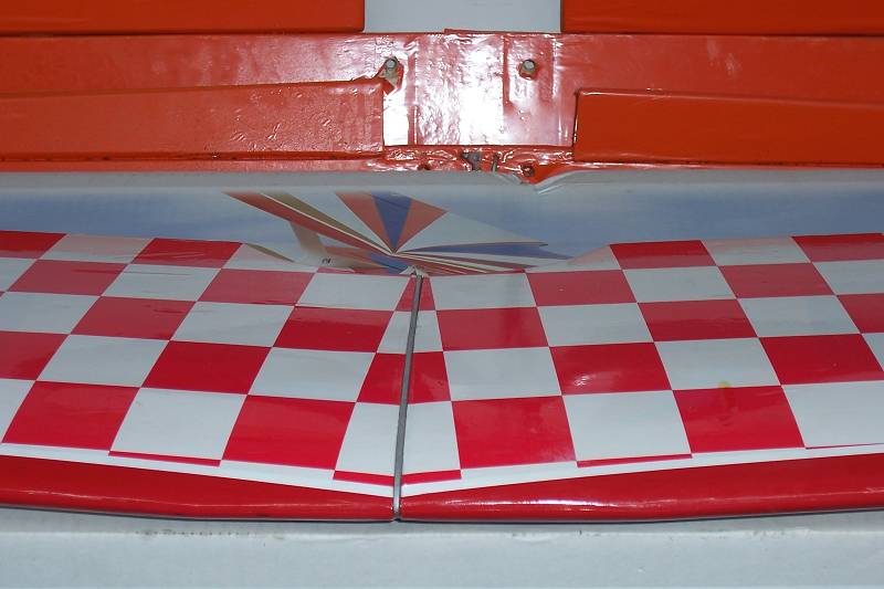

I just recently found this forum . Took a while to get thru it. And I did not see someone do this yet. Put this together 3 yrs ago , right after back surgery. I blame it on the pain meds, and that`s my story and I`m sticking to it . lol Bought another ARF and been flying that the last few years. Put this one on the back burner till now. I can order a new wing for $67.00 or maybe strip this one and turn it over , and recover it . I`m pretty sure it the same shape top or bottom. Yes I glued the wing mount in upside down , glued it real good . what d o ya guys think .I`ll have to buy the monocoat to recover it, makes a new wing look a little cheaper ?
Few post back , some one asked about the Saito 1.00 in this plane. . Mine has the 1.00 with a 14x6 apc, tried 14x8 and 15x6 , but the 14x6 apc seems to be the one it likes ., unlimted upline . A bigger engine is not nessecary ,but bet they sure are fun .

I'm no builder! I'd buy a new wing.

ORIGINAL: Insanemoondoggie
hey doggie,
sorta like building 2 left panels eh?....seriously though, that's an easy mistake.

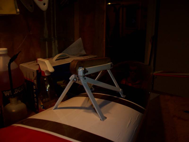

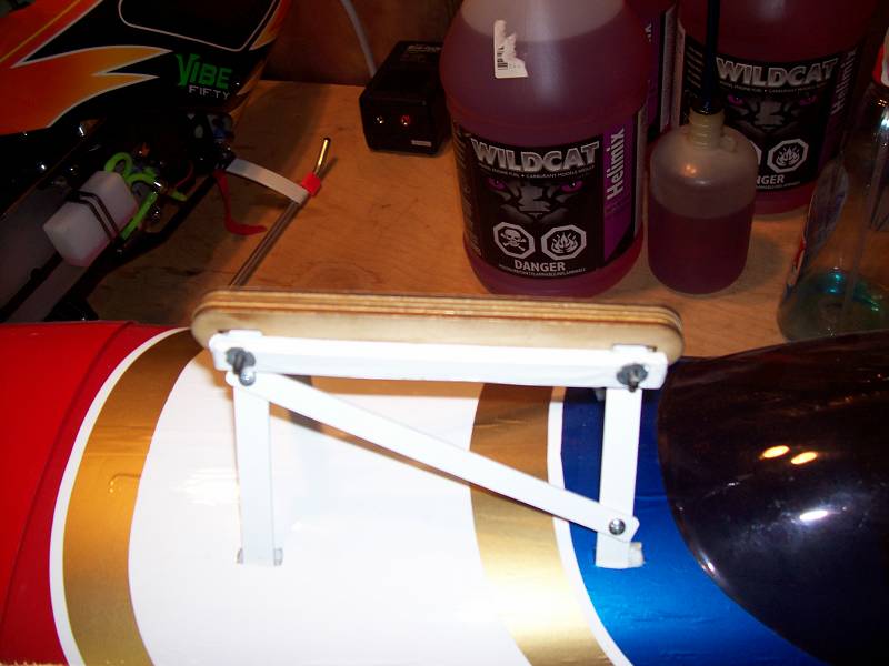

I built my SS this past spring almost a year ago. I also fly mine on high rates all the time. I use quite a bit of expo to tame it for smooth, scale take offs and landings. This is the best flying bipe. I absolutly love the huge speed envolope this plane has, scoots right along at WOT (OS 91 FS with Graupner 14-7) but will stop to chill like a kite in a 5mph breeze! I can (and have) flown my Skybolt for 31 minutes on a tank of fuel and still landed under power and taxied back, awesome. I put 52 flights on mine last year, completed the annual back in november, she passed with no problems other then a valve adjustment (expected) and there she hangs in the basement waiting for spring. You guys enjoy your Super Skybolts!
PS One thing I did for mounting the top wing was to make a small plate and installed blind nuts for the top wing bolts so you dont have to fiddle with the locknuts. Very easy!

ORIGINAL: oneqwk96gt
As a long time SS flyer, I'd like to see that plate you made for the upper wings. Those 2 bolts and locknuts are the worst part about putting together the Super Skybolt at the field.

I attached the two 4-40 locknuts to the metal with JB weld, I've had the wing on and off about ten times and the nuts are tight and secure. I'm sure your plate works well too! I love JB Weld.

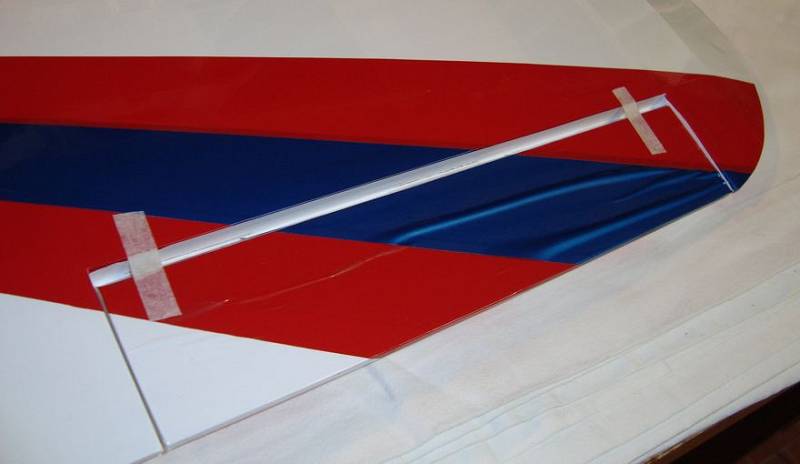

ORIGINAL: dblatner
I knew right off the bat i would not like the locknuts for the top wing so I made this when i was building the skybolt. I dont use any locktite though you can if you want. I have logged almost 2 hours of airtime one day and the bolts have never loosened up. Makes assembly a snap. This plate is made from lite ply. Oh yeah, i coverd the plate with white monokote also to make it un-noticable.

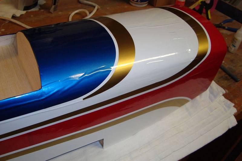

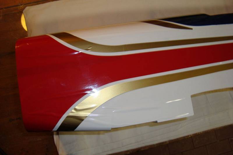

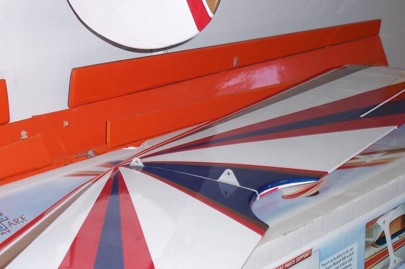

Last night I finished ironing... Now fuse and wings are OK and I can start the assembly.
The pictures are not just the "bad-spots" everything came out of the box that way, seems like it has been just wraped up! Wings had a better covering, but still needed some ironing. Did some of you experience the same covering issues?
Looks strange, in all forum and magazine articles the author states the kit has a superb covering... unfortunately not mine []

Default RE: Super Skybolt ARF
Those are some nasty wrinkles all right. Mine had very few. But it's hard to fault the manufacturer for wrinkles. After all, who knows how long ago it was built, and then it was boxed, crated and put on a boat for several weeks. God only knows what temperature and humidity changes it went through before it got to you.
But as bad as they are, a heat gun followed by an iron should get all of that out.
Minn, you're right, nothing a heat-gun and an iron is afraid of!
Model now is OK and ready for assembly.
btw, I have monokote coverd models that, once covered, never had such nasty wrinkles even after mamy seasons. Still I'm not lucky at all since the room where I park them (a cave...) is very moisty.
