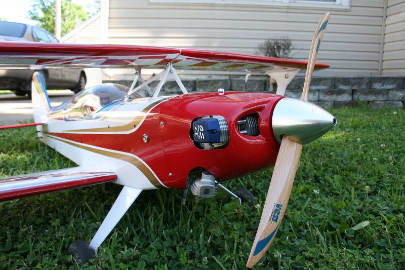

well my maiden could not have went any better[8D] Besides the light crosswind it was a perfect day.  The SS balanced as per the manuals intructions with the OS 110 up front and 1200 mah A123 battery from Fromeco.(Actually the battery was from their Iron core line of batteries which is a little bit different from the A123's) The OS 110 is plenty of motor on the ground I richened to motor to 9100 RPM's and in the air it pulled the plane around with great authority. I never went above 3/4 throttle I just kinda took it easy and flew the plane in a calm manner.  Overall I am very happy with this ARF, but I am used to flying bigger planes so ti took a little getting used to. At times I found the plane hard to see at times, The color scheme looks great on the ground but it just doesn' stand all that well in the air. I'll just have to keep it closer

Im trying to post pics but RCU is not letting me[:'(]
Old 05-31-2009 | 03:29 PM
  #685
Joined: Jan 2007
Posts: 258
From: perryville, MO
Default RE: Super Skybolt ARF

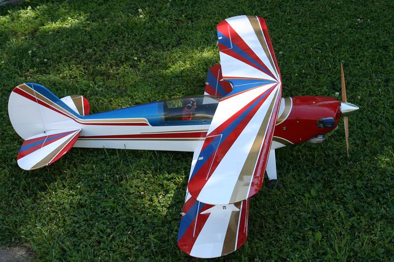

here's some pics

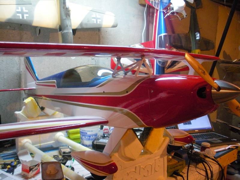

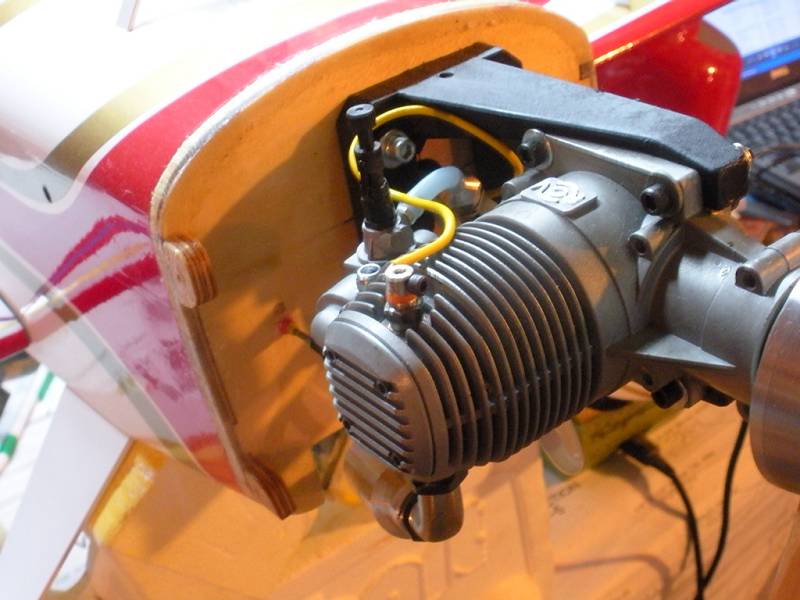

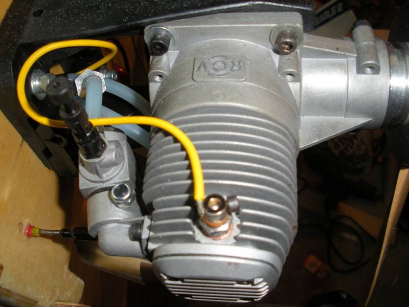

Here's mine, I put a RCV .91 CD under the hood, with a remote glow system, I had to get creative with the adapter because the stock rubber boot one included was too tall. I used a 5/32 wheel collar drilled out to .101" and took the chrome plating off one side, soldered the lead to it and changed the set screw out to a 4-40 cap head screw. Just put a small slice of silicone fuel tubing between it and the base of the plug and you got a very low profile connection that can be removed at the field if needed to change out the plug. After running the RCV, I realized that glow heat isn't needed, but it's got it anyway, I glassed the firewall on with 6 ozs cloth and MAS epoxy too. For servos I ran 475 hitec on the alerions with a carbon fiber interlink and sig alerion connectors for biplanes, (2) JR 537's on the elevator halfs and a hitec 565 MG on the rudder with a 322 hitec on the throttle. Believe it or not, I chucked it on the scale with 11 MAH battery and switch and reciever and it all comes out to 8.5 LBS, I figure about 8.75 with foam rubber and onboard glow battery, but I might change to a LIPO and a regulator to feed the reciever and the onboard glow as well. Just gotta glue and screw the canopy down and set the throwas and she'll be ready for a madien flight this week or next weekend.
ID:	1209877   Click image for larger version
ID:	1209878   Click image for larger version
ID:	1209879   Click image for larger version

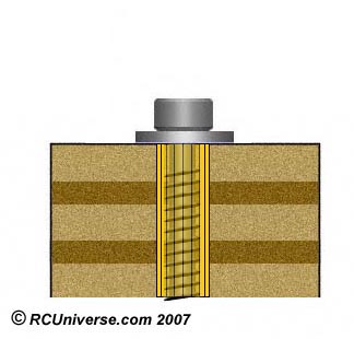

I have had a constant problem of the cowl mounting holes getting "keyholed" by vibration. I came up with an idea, tried it, and it works!! I took some fuel line and carefully cut off very thin slices - like 1/16 inch, or one millimeter, to make soft washers out of. I then put Futaba servo mounting flat washers on the cowl screws, with the fuel line under, and turned them in tight enough that the fuel line washers begin to bulge out. Problem solved! The silicone pushing against the cowl keeps it steady and prevents it from vibrating.
An even better variation, is to make the holes just large enough to put the fuel tubing THROUGH the hole.
Then cut some thin tubing slices and put them on the cowl screws themselves under a washer.
Push the tubing through the hole in the cowl and screw in.
The screw will expand the tubing in all directions causing it to grip the cowl from underneith as in your suggestion, but also from the center and sides. This dampens vibrations in all directions.
( This was MinnFlyer's idea and he has a great graphic for it around here... ).

Actually it was MinnFlyer's idea - AND his graphic
I gave Ken access to my graphics files and he posts them so often that everyone thinks they're all HIS LOL
Oh well.
In any case, here's the illustration that opjose was referring to

Yeah, that's what I said...
Really! Just look!
The tubing tends to bulge at the bottom too though, which isolates the cowl from vibration very effectively.
Great idea!

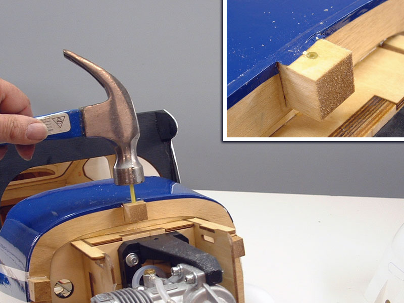

Speaking of innovative ideas, here's a great way to keep the blocks from stripping out:</p>
Drill the holes 1/8" and glue a piece of inner pushrod in each hole.</p>
Now a servo-size screw will screw into the plastic tube and you'll never wear out the threads</p>
ID:	1210264   Click image for larger version

ORIGINAL: MinnFlyer
now that is one of the best yet Mike.......but we do have a couple Gorillas at our club who can strip that out in a blink of an eye...LOL as a matter of fact, one of these Gorillas managed to bend a pushrod in his new YS the first time out along with a stripped needle valve..a big <span style="font-family: Arial"><span style="font-size: xx-large">LOL<span style="font-size: smaller"> </span><span style="font-size: xx-small">to that one</span></span></span>

Reminds me of all-threads by ohio superstar or was it Ohio models. Same principal, just a piece of plastic tubing glued in the hole and scew your wood screw into it.
