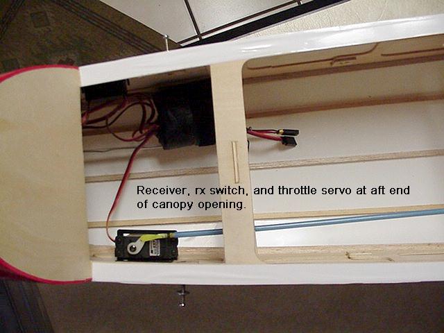

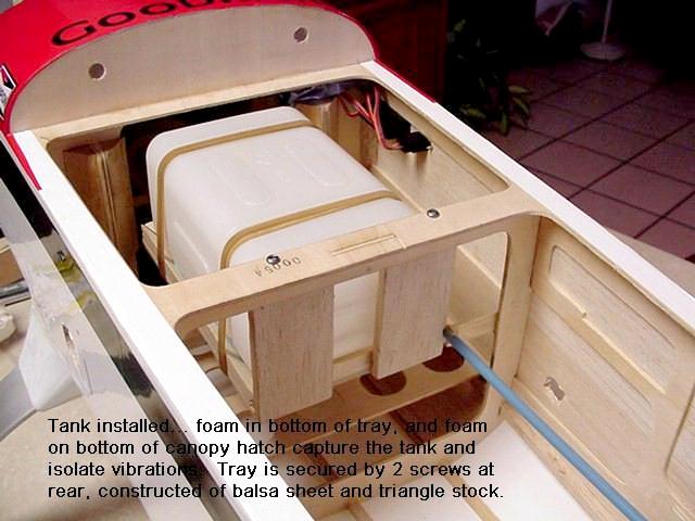

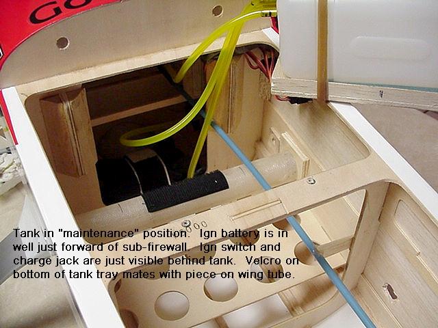

Here are some pictures of my 300S. I am still waiting on my Tauras 52.
Servos
Futaba S9206 ailerons and elevators
Futaba S5301 rudder
Futaba S9202 throttle
Futaba R149PCM receiver
Sanyo Hydrimax 4.8v 2000 mAh - receiver
Sanyo Hydrimax 4.8v 1650 mAh - ignition
TME smoke system w/ 10oz tank
Tauras 52 up front (soon), 22x8 Pro Zinger prop
4-40 Dubro pull-pull
Central Hobbies .210 carbon push rods
Rocket City 01B control horns
Rocket City #87 ball links
Sullivan tail wheel.
Will take some more when engine is installed. Thanks to everyone that gave hints/recommendations on what to do on this model.
TJ

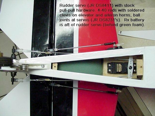

WC,
I'm sure the 2.4 would be fine.
The only thing I would recommend it that you epoxy the tail section on for a gas engine. Before glueing the stab on, I did put a couple of hardwood rails in the tail section of the fuseluge. Just cut them to fit and glue them across. It beefed up that area pretty good. Again, only did this because of the gas engine. Maybe an overkill but better safe then sorry. Also, attach the rudder to the fin and check to ensure it is straight. Mine leans to the left a little. I failed to check before glueing the hinges in, will be the first and last time I fail to check It will be ok thou, that is why we have trim
I used the metel hinges supplied but also used 2 extra CA hinges on the ailerons/elevator and one on the rudder. I did seal the control surfaces. Also put some packing tape on the wing tube to eliminate the play on the fuseluge side.
Everything else is pretty much straight forward but I am sure I will have other pointers when installing the engine.
I'm hoping mine will be less then 16lbs and don't have to add any weight to balance. I plan on balancing at 6.75.
The taurus I am putting on is 5.87in long so as of right now, I don't have to modify the engine box.
I used a 1/4 scale pilot and it was too tall to fit. So, instead of risking cutting and screwing up my $30 pilot to fit, I cut out the canopy and it sits down about an 1/2in. Its all foam so it was easy. Then I used black trim tape to even up the cut around the pilot.
Will send some more pictures as soon as I finish with engine. Will be out of town til the 10th.
Happy building/flying all.
TJ

:spinnyeye After looking at some of the recent photos I have a couple of suggestions. On my Extra I used the Rocket City control horns all around. On the rudder the stock location is to high. When I used 3D rates and the rudder was all the way to one side the control horn hit the elevator when it was in the down position.
The solution is to simply shorten the R.C. control horns. This also reduces throw. I had to install a (Dubro) large heavy duty control horn on the servo to allow 3D.
I hope this saves you some frustration
