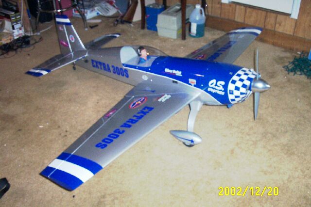

I have the blue and gray model that I am just finishing up.I am using the os160fx and hoping it is enough power. I will let you know what I think. Should fly it in a few days. Tivey

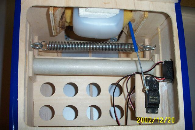

Mine is ready to fly all but some finishing touches.I removed the bolts in the wings and installed wooded dowels down in the wing and cut off flush.I then screwed in an eye hook into each wing half. Now when I get to the field all I have to do is attach the wings together with the spring to each eye hook. I have attached a couple pictures of my new bird. Tivey

Thought I would show you guys a picture of my extra. I will maiden this next week if the weather cooperates.I also wanted to say that I removed the bolts in both wing halves and installed eye hooks in their place.Now when I get to the field all I have to do is hook a spring to the two eye hooks and that will eliminate using those small nuts and washers.Tivey

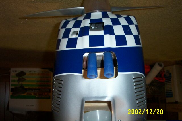

O.K.I placed my rudder servo at the rear on left side of fuse to not have to use pull-pull.I attached a secondary rod to the rudder rod for the ohio superstar tailwheel that I installed.If the pictures turn out you can see this.I also did not do my sheel pants as they show. I used my dremel tool to create a slot in the bottom side.Hard to explain.I bought ultracoat and sealed my elevator and ailerons,so air leakage through was impossible.Also adds to strength.I used a dubro 24 ounce gas tank.Also mounted os160fx engine and used a bisson pitts muffler instead of factory muffler.I did not like the military stars and bars on a non military plane. Didnt seem appropriate.Tivey

Default engine mod pictures
Underneath picture.Tivey

I flew my new wm extra for maiden flight saturday afternoon. It really flew nice with the os 160fx. I was sort of wrried but it was plenty of power.I had it very rich but really had enough power for me.I do not fly 3d though.This bird doesn't need alot of elevator for the average flyer.Be warned.Tivey
