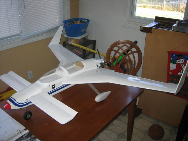

Initially I was using an OS 46AX to power my Long-EZ. It was quite adequate but once I installed the cowling with plenty of openings it tended to run lean. Now part of that problem was more than likely the defective "quick fueler" I installed on the side of the plane. So I changed out the "quick fueler" and since I have always liked Supertigre engines, I figured the Supertigre GS45 ABC with its very tall thin cylinder head fins just might cool a little better.
About $69 spent at the LHS for the Supertigre and things are much much better. This engine makes a LOT of power even set slightly rich--enough to leave a very noticable smoke trail in flight--running on 10% Wildcat fuel. It is also very fast, I generally fly at about 50% power and that is plenty fast. I've probably got it under-propped as it makes a very unique sound in the air. The stock muffler being the rotatable "barrel" shaped thing I've got turned 90 degrees to the fuselage.....so it looks kind of like a volkswagen (or better yet a Porsche 911 "sausage" ) muffler. Idling on the ground is no problem. Even with the cowling installed it will tick over at an extremely low idle without getting hot. So no worries about "get it flying quick in order to cool the engine!"
I'll take a look at what prop I'm running and report back. Maybe even a picture.

My prop is on correctly and I'm running my own muffler which gets me a few more RPM's out of the combination. Don't get me wrong, it does fly alright and I am taking off from grass but it really could use just a little bit more, I'm wondering if maybe a two blade would work better for me or just breaking down and getting a .46 AX.
One other thing, has anyone installed any rudder's on the wingtips. I got mine into a spin and it didn't recover untill it was too late to do anything about it. [:@] Yes that means I have practice repairing the canard.[:'(]

The distance between the center of the fuel tank at its design location and the design CG of the airplane is not so much to make that much difference in the moment arm with regard to balance. I'd recommend placing the fuel tank in the design location and balancing the model with the fuel tank empty. Works fine that way on mine.
The Rutan "Quickie" is a different ball game altogether....that one does have the fuel tank centered over the CG and it DOES matter!
