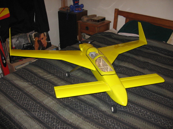

I received my plane in the mail yesterday. I surprise to see how well it was built. This is my first arf and I'm pleasantly surprised. Hopefully I'll have it put together in the near future. It is smaller than I had expected so I'm gonna go with your guys sugestion an use the .46 LA that I have. I'm gonna so some slight modifications to the cowl area so I can get some better cooling to the engine. I'll post some picks of what I do if anyone is interested.

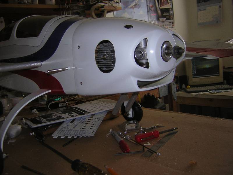

Please do post cowl mods... I'm thinking of making some small scoops to put on the sides os the cowl, it is still a pretty tight fit though. Cliff

I was going to mount a scoop to the left wing panel to cover the head of the engine, I was thinking this may be easier to do that attaching somthing to the cowl. Maybe 2 small screws to hold it on. I even took 1/2 of the plastic container that a DuBro spinner came it and painted it white on the inside. I left the flats on the sides to glue to the cowl, looks pretty good for a scoop. Just knocking around some Ideas.

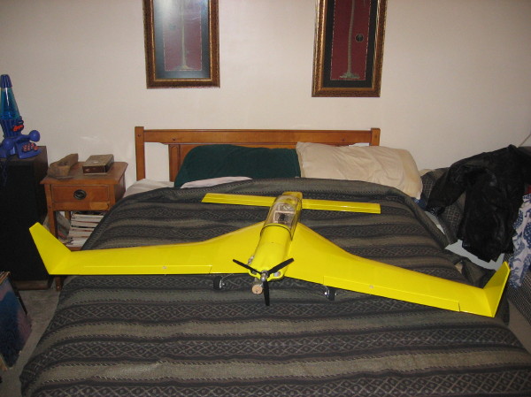

Just a couple of days ago I received my yellow LongEZ from Raidentech. Wow! The quality is very impressive for the money! Kind of figured engine cooling was going to be an issue, I've got an OS 46AX to install, but since I'm reading you guys just fly the model without the cowling its giving me even more incentive to install my OS 30 Wankel without the cowling. The Wankel makes a LOT of power, and since it is very inefficient with the fuel, the LongEZ is large enough for a large tank to make the Wankel worthwhile I should think. Hope to build this one in the next couple of weeks.

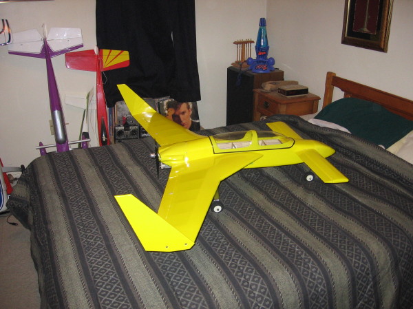

I finally started to assemble this plane. Overall I would have to say that the kit is fairly well constructed. It could use a little more glue in some of the joints which concerns me on how much they used on the inside of the wings. All the parts seem to be laser cut which makes for a nice precise fit. My cowling looks a little different from the ones you guys show in the pics, mine already has side scoops on it. I think with some well placed baffles inside overheating shouldn't be to much of a problem. I ordered a 9x7 three blade to go on the .46 LA, I hope this combination gives enough push. It will definately help with ground clearance. As of right now I'm just using the stock nose wheel. I thought about a retractable nose wheel since I have one laying around not being used but with all my warbirds I wanted to go with simplicity on this one. That may change later after some flight testing. I also might do some airbrushing on those large white wings instead of going with the stripes that come with the kit. I'll post some pics when it's flight ready.

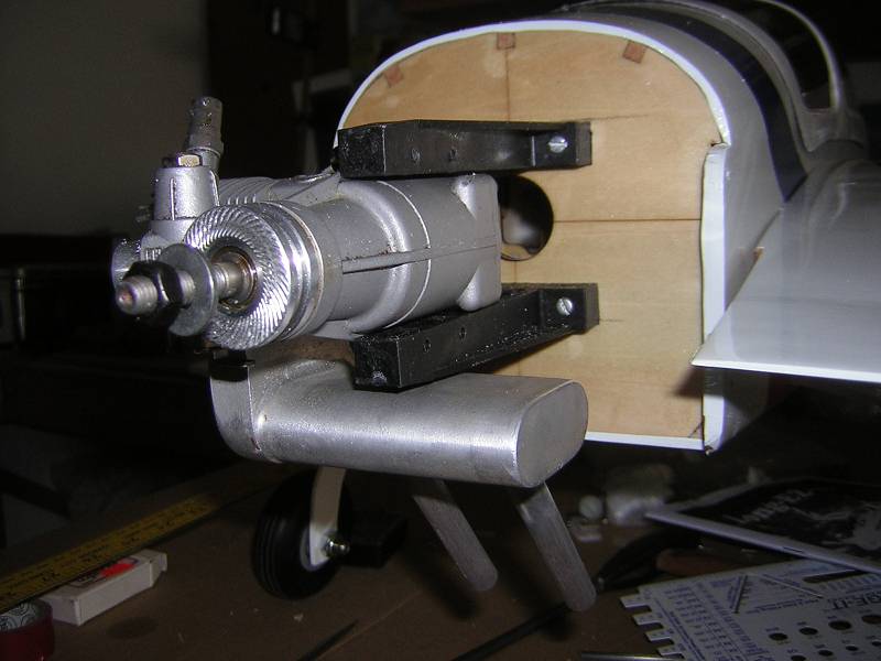

Just thought I'd add a few things from my build of the Raidentech yellow Long EZ model over the past few days.
With regard to the original question of this thread about the engine mounting--what I did was to mount the engine (OS 46AX) on the supplied engine mounting rails at the correct distance back from the firewall (120mm I seem to remember) and added about 4 mm for "comfort"; I then placed the rear cowling on the fuselage and positioned it to fit the lines of the top and bottom of the fuselage for appearence sake. Measured through the cowl to insure I had the required 120mm and then applied masking tape where the cowling edge met the fuselage to mark things. Next I removed the cowl and placed the engine/mount assembly onto the firewall while holding the fuselage vertical, fit the cowl on (I had already cut out enough for the sideways mounted engine) and holding the fuse vertical moved the engine around to "center up" with the cowl and more specifically the hole for the crankshaft. Marked the outline of the engine mounts and then proceeded to drill the holes in the firewall.
Mounted the engine and fit the cowl, looked terrific! Thats when I slid on the left wing....well....almost slid on the right wing! At this point, and after an open handed slap to the forehead, I was faced with one of two options:
A) Make about a 1"X1" notch in the trailing edge of the left wing to clear the engine or
2) Move the engine up about 13mm for good clearence.
I chose solution (2) and the cowling still fits pretty good. So you've been warned!
