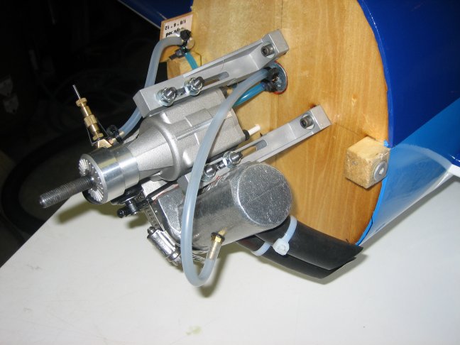

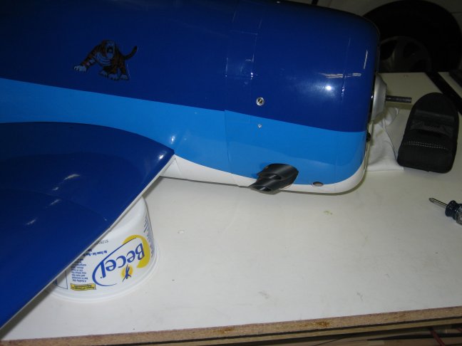

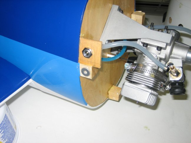

Putting a thick washer on the balsa blocks on the side mounts can open up some air space - on mine it was about an 1/8 of an inch each side. That should help with airflow. I haven't flown mine yet, but prolonged full power ground runs don't seem overly hot. A little rich on the carb setting helps keep it cool too but we'll see first flight how hot it really gets.
The black pipes on the left side are real and I put fake ones on the right side. With some holes on the bottom but excluding the gap the washers created, the ratio of out to in is slightly in favour of out. I also used some small baffles on the inside of the cowl to control airflow.

motorman......Inverted engines dont like me....never have, and Ive learned hard lessons with inverted engines.
That said, MDS engines run hot anyway.
They (MY 78) are dense and heavy, but the power is smooth and strong. Im runnin a 3blade 13/8 and I beleive I could go bigger if I wanted to.
Im gonna try a 14 /8 3 blade on rarebears ST 90.
My MDS has been hangin in the ole stuka for a few years.....bearing rust...................all that ................old school burn it out crap, and I'll keep alot of good glow plugs til all the crap is out of the motor.........
.......Its runnin perfect now, after tweaking the low end for the Texas heat and humidity. Folks dont like MDS engine beacause they are sensitive to low end settings, and unlike most engines, you really notice how the two needles effect eachother.
After turning the low end needle IN 172 degrees, and opening up the high end to 4cycle running, and then slowly closing it off, I get a summer needle setting thats way different from the rest of the year.
The motor runs fine now, although it will benifit from more use........and Folks please ...........dont bother me with bearing care and how to store engines and all that........

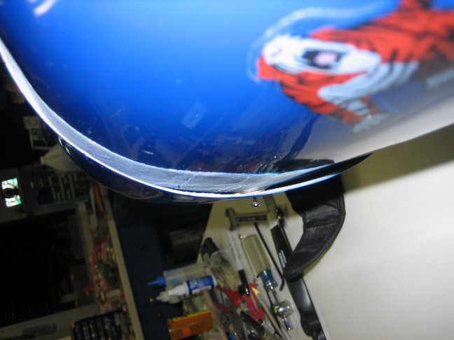

Hepdog..Hope your cowl dont crack........ On mine, I releived the mount blocks and added a thin slice of silicone to take up the space, and re-glassed (thin CA) the area about 2 inches around the mount holes in the cowl. I simply tightin the screw, which is a tight fit, until the cowl starts to distort into the silicone, and them back it off a little bit. This keeps cowls with that mount system, in good shape for alot of flights. I do understand you did it for cooling, but I think your benefit would be minimal at best, and risk of cracking the cowl up ......high.
But remember that thin ca will fix it nicely with minimal weight.. I do hope it works out for you.
And get that supertiger sticker off of there!!!!>>>>NOW! [X(]

BTW: all I did to my firewall was to reglue it. I didnt have to add anything to it. It is fine, and will be fine.

when i removed the hot melt the fire wall fell out , it wasnt in there very well , but its fixed now and glassed in with 1/4 ply and nope ill be keeping it i was thinking of ordering a new wing set and put it together with robart gear if i change my mind ill let ya know

Bignasdy thanks for the info. I'm not worried about cracking the cowl - now that the washers are there. Before the screws were flexing it inward and placing it under quite a load. Now it is just even - the cowl slides over with no stress at all. A little dab of RTV on the final install should smooth vibrations.
The stock muffler isn't even close to fitting - and was too restrictive anyway. It was really quiet with just that tiny little exhaust hole. This pitts style is much better - has a real nice low note and a bit of a snarl to it. Damn slimers are noisy anyway so it might as well sound good. I figured as much about clamp tightness so once again high temp RTV to seal it up - the clamp is just snug. So far no leaks.
I've had those Tiger stickers for a long time - waiting for a use. The nose was bare, it IS a HellCAT, a tiger is a cat, its powered by a SuperTiger so....1+1=3 kindof thing.
I will most likely cut up the lower fuse on each side an put some cooling slots like you did on top. That and some more baffles inside and it should be good on the hottest of days.

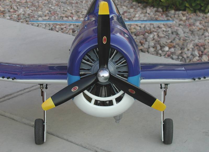

For cooling you should only cut the area out in front of the cylinder head. You are defeating the purpose of the baffle by cuting out between all of the cylinders. You want all of the airflow over the cylinder head. I just remove the one cylinder head in front of the real head and have no problems with the engine overheating. Here in Las Vegas we fly on day's with the temperature well over 100 degrees.

I totaly agree with you on the baffling thing. All of my planes which are colwed in have only the portion infront of the head open. Most of the time, I have to block the other side like with a Cap or Extra. Even my Shoestring runs noticibly cooler with the otherside blocked off.

I understand what you are saying about using the fake motor as a baffle. I cut them all open cause I thought the crankcase and especially the muffler could use some cool airflow. To compensate for all that air rushing in unorganized, I actually baffled the cylinder head inside the cowl so it has its own dedicated influx and efflux (plus I cut up the fuse for a channel behind the head). That's how all the piston slappers I ever flew were cowled so hopefully that works here to. Electric would have been sooo much easier...
For the gear, I think it would be pretty easy to add the forward facing small gear doors. Anyone given that much thought? I think I will need to do it to keep all the slime off the retract mechanism - although at least one side will be well lubed
