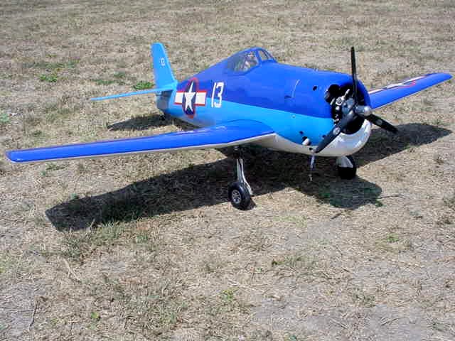

FIRST FLIGHT MOTOR TOO HOT...SAGGED AND SPED UP ON FINAL...FLEW PAST ME ABOUT 200 YARDS......TAIL CAME UP ON LANDING, NOTHING DAMAGED. tHE RETRACTS HEKD FIRM.
sECOND FLIGHT ..OPENED UP THE COWL FOR COOLING. nO PROBS, BUT WILL open two more cooling flaps for heat exit.
ther was no wind 95 dgrees, humidity 90%
This plane flies light and crisp. Had no prblems whatsoever, except overheating the first flight. Im not gonna correct all the typos becaus this dinosaur website will erase all the poist. this is my third attemt at posting. Motorman....you can see there is no oil on the mains..to answer your question.
You can also see the 3 inch wide crack in the ground...the whold feild is cracked and I had no probs at all.
You can also see the weeds on the gear from the first landing...again, no probs. Yall keep modifying, Im goin flyin!
LOL
good luck!
d

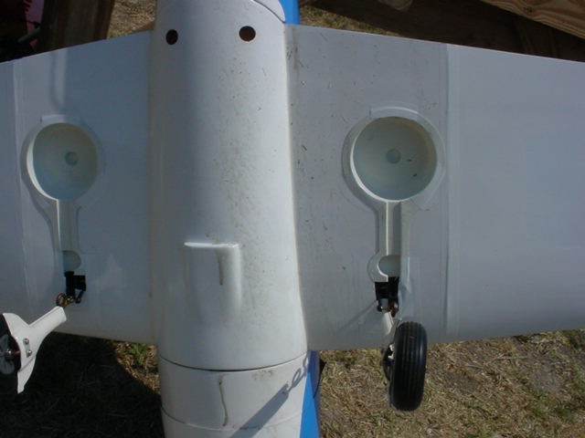

Motorman.......heres what I did.
This dounled my exit size. Ran perfect today.
As I looked the plane over, and checked bolts and all.........the retracts had some play when down, so per instructions, I tightened the allen bolt in front. I left a tiny amount of free play. Very tiny. I expect until the gear gets broke in real good, itll need adjusting a few more times. No other problems noticed.[8D]
d
