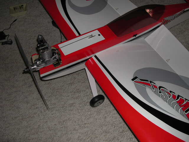

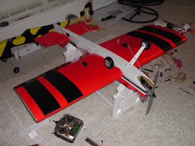

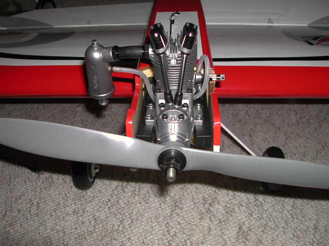

I picked one up yesterday at the LHS. I have a Saito 100 with no home and I thought maybe a 60 size UCD would be a good place for it and it was my intention to pick one up. I like my 40 size pretty well but it's not nearly the plane my Kyosho Flip is. Anyway, they had 2 of the Twist 60's sitting there which had just arrived. I opened one up and was amazed at the extent of prebuilding; all pre-hinged, openings cut for servos, wheels installed on LG, pre-bent control rods, pre-installed horns and it has a bolt on tail assembly. How easy does it get? I didn't even check for a UCD; I just bought the Twist.
I spent most of today putting it together. Had I chosen the 2 stroke engine or electric motor setup, it'd be done with time to spare. With the Saito however, there's just no decent way to hook up the throttle. I switched the carb orientation back and forth several times and looked at it from several different angles but the best I could come up with was to build a replacement hatch that would hold an HS81 and have a rod run from it to the carb arm over the top of the hatch. It won't look pretty but it'll be functional. I believe it would be possible to squeeze a rod on the far port side and bend it such that it might work but I absolutely hate using bent rods.
Noteworthy items include - the pre-hinging is nice from the standpoint of saving time but I actually would have preferred to go with nylon piano hinges. Only the control surfaces are beveled so with tight CA hinging, throws are somewhat limited. I was still able to get everything to travel well beyond what the book calls for on high rates, but I think it could handle even a bit more.

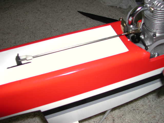

The tail wheel that comes pre-installed is the type that's driven directly off the rudder. I cut it off and installed a Sullivan spring drive unit. The rear tail assembly bolt can be used as the front hold down for it.
The book calls for only standard servos which seems a bit light for use with the Saito so I used HS5625MG's all around. I don't think the size of the rudder is such that it deserves anything more. BTW, I'll be running 6 volts.
The CG came out with the receiver and battery in the center of the wing compartment. There's acres of room to move them around so CG experimenting should be a breeze.
There's room for as much as an 18 inch diameter prop so those of you so inclined could easily put a 125 on it. I'm starting out with an APC 16X4W and there's tons of clearance.
The control rods that come with it are what I'd call bare minimums. They're pretty short which is their saving grace. If you're going with the 2 stroke and standard servos I'm sure they'll be more than enough.
The plane seems to be built very strong and they did a great job gluing it together. I usually have to add quite a bit of epoxy and CA to fill in missed spots but this plane needed none. That's a first.
IMHO, H9 has set a new standard of pre-build level and quality with this plane. If it flies as good as it looks like it will, I'll be drooling with anticipation for what they come out with next. One big miss though; they should have made provision for the Saito 100 especially since their web site and even the box says it's designed with that engine in mind.
Maiden flight is scheduled for this Sunday.

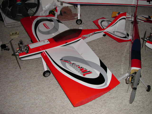

I'd like to see some pictures of it if anyone has any.
Old 08-11-2006 | 12:58 AM
My Feedback: (13)
Joined: Jun 2005
Posts: 164
From: Irving, TX
Default RE: Twist 3D 60 ARF
Enjoy!

Old 08-11-2006 | 03:40 PM
Ernie Misner's Avatar
Posts: 5,037
From: Tacoma, WA
Clean throttle linkage!!! That muffler looks like it might keep the plane cleaner by point upward?
Ernie

Thanks for the pictures bobkra. Looks like a nice ARF. I like the painted landing gear. You did a good job on the linkage, K.I.S.S. I always say. Hope the weather is nice so you can get out and test fly this weekend. I can't wait to here if it does as good as the 40 size.

Yeah...the linkage looks different for sure, for the throttle, but heck...it sure is functional....

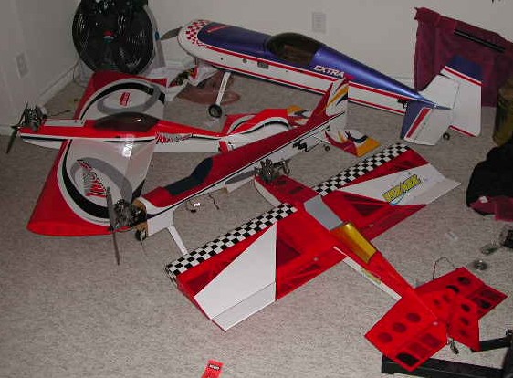

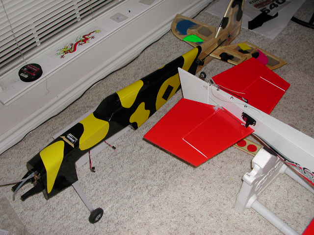

Lack of the correct prop kept me from flying mine today as planned. The closest I have is a 15X4W (on the plane in the pictures), and the props I ordered from the LHS haven't arrived yet. I have my fingers crossed for Tuesday. BTW, here are some more pics of the engine installation and one comparing the Twist tail to a U-Can-Do 40 tail.

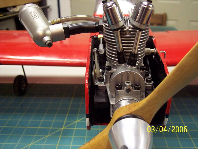

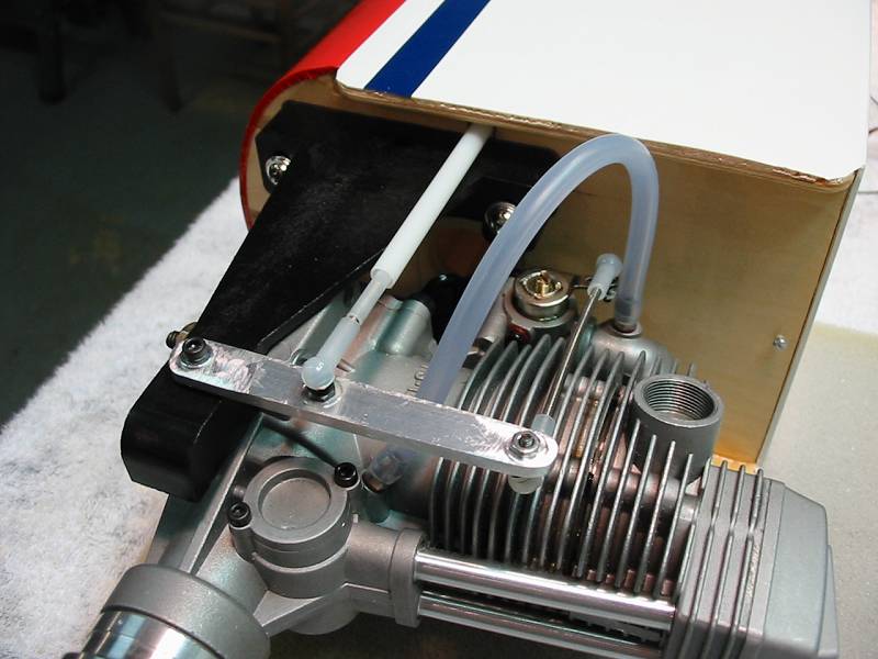

ORIGINAL: bobkra
For future reference, what lair300s mentioned is commonly referred to as 4-stroke linkage. Dubro actually makes a hardware package you can buy:
Dubro 4-Stroke Throttle Linkage
http://www2.towerhobbies.com/cgi-bin...?&I=LXD939&P=7
Just for reference, here are a couple pics. The linkage on my SIG Mayhem is homemade and bolted directly to the engine mount, the linkage on the Tiger 2 is the Dubro hardware and bolted to a small metal bracket that I fabricated. Both work great.
Let me know if you still have questions about it.

ORIGINAL: sgillmore
Great pics... I am aware of both methods you've used and have seen them both in person. The method you used on the Mayhem requires adequate room between the fuse and the engine mount which there isn't on the Twist. I could have cut off the side of the fuse but decided against it. The bracket mount method could be made to work with a seriously bent linkage rod from the bracket arm to the carb but I don't feel a bent arm provides the same strength and feel as a direct link does, especially when hovering down low where throttle control is critical. I considered using a bracket on the opposite side by flipping the carb but you still have interference problems between the engine mount and carb arm unless you're willing to give up some throw which I wasn't. If someone can do with a bent rod, I believe the port side carb orientation might work without any extra linkage.
