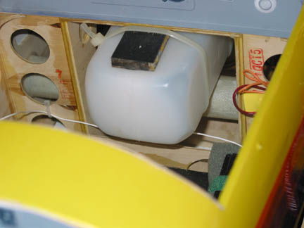

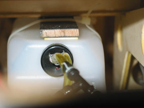

Another question, how are you guys mounting the fuel tank on the CG with the Wing tube in the way, and it is some cramped quarters to be working in for the CG?
Would mounting the tank up against the wing tube still bring decent results? The instruction show the fuel tank all the way up against the firewall.
#42
My Feedback: (64)
Woodscra, again, not sure this is the best way but I mounted a 1/8" thick honeycomb/carbon fiber composite plate (1/8" light ply would have been fine) on top of the wing tube. I screwed it to the bottom of the motor box with #2 screws and extended it over the wing tube. I then brilled holes and zip tied it to the wing tube. Tank is held to the plate with velcro. Will try to post pics if I get a chance. cbk

cbk has given you good advice. I used the composite to build my tank mount and I've enclosed a picture of it for you. If you want to see more pictures of this and other mods I made, check out the review I wrote at www.rcaerosport.com in the review section.
I'm using a Tru-turn spinner on mine, modified by Tru-turn with a menz cut, lightened backplate, drilled for the Taurus, and they supply the correct adapter too. I know Tru-turns are superb quality from experience, but I can't steer you on the Dave Brown ones as I haven't see them.
