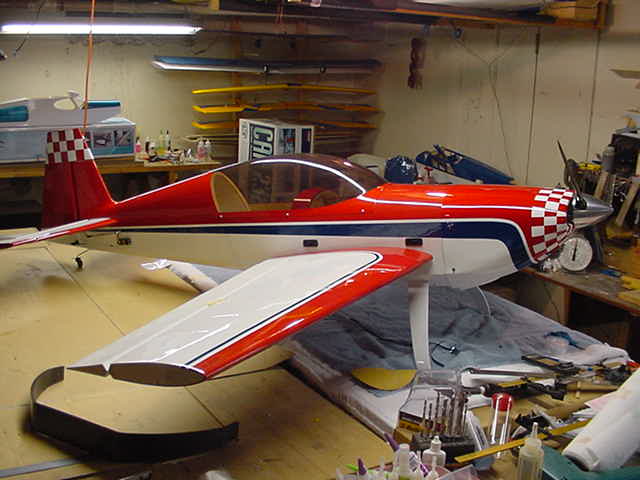

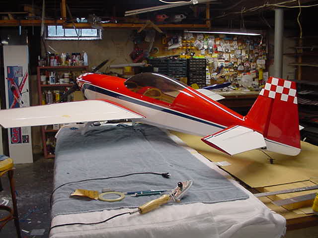

Hey guys
I got my last sept.after ordering it at the Wram show in Feb.I have a 160fx in it the pull/pull set up and the batt.over the engine box.I have the cg set as per inst.far back. This plane flys great I don't know why you would put such a huge motor in it and then complain the push rod ect. arn't strong enough.this plane isn't made for this much power.Your really don't need it! Mine weighs in at 13lbs
