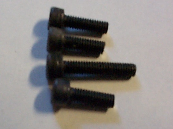

I was able to pick up everything I needed today , except for the 5/16" nylon bolts for the canopy. Got a beautiful XOAR 14 x 4 prop, it's almost too nice to use...Got a Sullivan pull pull cable set. I'm ready to start building as soon as the 3152 servos get here.
#832
Bob- I agree- its fun AND pretty to do scaleish takeoffs. Not my old habit, but I'm trying to make it my new one. Its alsoa lot betterto be taking off level(er) if the engine quits, eh? BTW- Have youevermanaged to land on the mains and roll 20' before the tail hits yet? I'm wondering if its the nose high attitude when you slow it down that is making this tough for me- all of my clean landings are ~3 pointers.Probably justmy "new plane" jitters, but I'm having a hard time- maybe I'll up the airbrakes from 13-20mm & see. Of course thehigh wing layout on the Cub probably makes it easier for my buddy- you can see the darn wheels better! (Oh, yeah he's a better pilot, too! That'll all have to be next weekend- we are flying off water both days this weekend and my Phoenix Extra (Phextra?) isn't due for such "carnage by the sea" abuse til NEXT year...!</p>
Racerchuck- FYI: I found 8-32 nylon bolts (not 5/16) went into the existing canopy blind nuts nicely, meaning a little "squeaky'. The blind nuts are 4mm dia by 0.7mm pitch which is close enough to the 8-32 diameter (0.164" dia) that it works. In fact, the 8-32 is only7 thousandths of an inch bigger than 5mm (0.157" dia) and the 4mm nut isalways a hair over 4mm and 8-32 bolts are always ahair under 0.164" making for a nice tight fit in most cases. The slight difference in pitch on the threads (32 tpi vs 0.7mm pitch) actually HELPS because it makes them turn in a little hard but they don't vibrate out. The 8-32 starts nicely and tightens up ina turn or two because the 8-32 pitch in metric would be 0.79mm vs 0.7. So for each thread engaged you get 0.0036")of interference in pitch added. This is good for short thread engagements- after about 8 threads you've actually wiped a whole thread out. OK, so maybe I do a little too much with threads at work....simply put, by dumb luckit works great- couldn't have designed it betterif Itried! Just go easy with the screwdriver the first coupla times when you put them in (torqueis high at first)or you can stab a hole in your fuse!! There are a few happy coincidences in the whole english/metric mess. Another one is the 5/16-18 vs M8x1.25- so close that you can squeak them together for lightly loaded applications like nylon bolts. Be careful doing this in metal, though.... the threads will pull out easier with the pitch mismatch.</p>
Ace Hardware has the 8-32 screws in nylon for flat screwdrivers. Next, I am looking for hex head nylon 8-32 to reduce the stabbing! I found the real 4mm x 0.7 nylonpan head screws at the hobby shop and will try them on the gear..... because those are loaded a bit moreI was a little nervous about the 8-32 trick- I can drill and lockwire those or just reef on them to keep em tight.. Another 0.3 oz saved for a buck or two!! Ihave had bad luck with the nylon screws in colder weather- but that's not til October....</p>

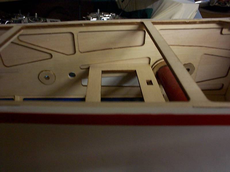

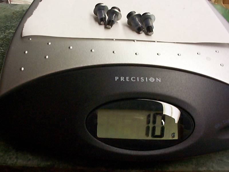

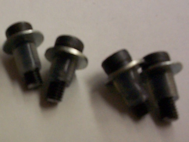

Rick, I don't quite understand the platforms for the rear servos, but there is no reason they shouldn't work, although they do add some weight to the tail.
Shortening the wing bolts is a good idea. Far more length than needed, and in all the time I've been flying mine I have never had the wing bolts loosen up at all, even with the hi-vibe 4 stroke....

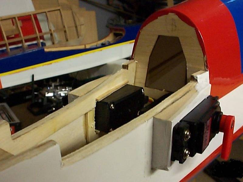

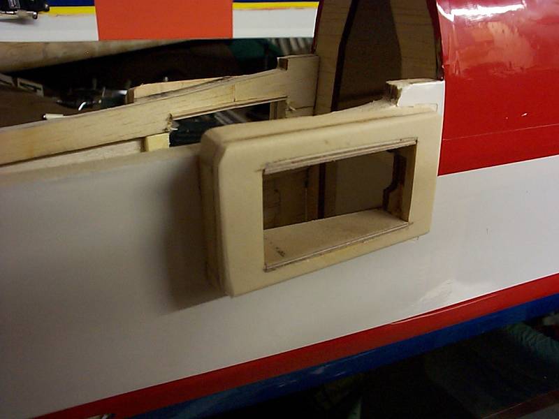

Bob, How's it going
? Time is getting one up on me and a lot of post get created inbetween my assembly progress. None the less, here is part of my post 703 that more or less explains why the boxes for the elevator.
ORIGINAL: RICKSTUBBZ
.......... the modification process for my elevator servo mounts. As mentioned before, I am changing the servo mounting to be symmetrical. I will also be re-aligning the servos perpendicular to the hinge line of the elevator. This set-up allows both servos to fit at the same area of the fuselage and it straitens up the linkage movement.

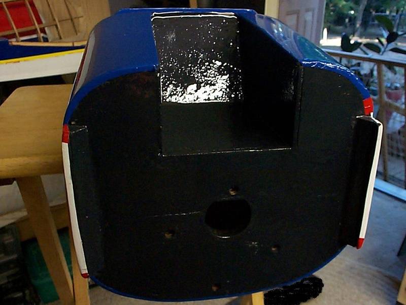

RICKSTUUBZ- I also repainted the firewall- I never like dull paints for resistance to oil & fuel but that paint Phoenix used made a great primer. I always like paintor white glue to seal the edge of the wraparound covering at the perimeter of a firewall so that it doesn't get oily and curl. I also blasted spray polyurethane in the entire tank/gear support area as best I could without too many sags and runs. That way, when I get a fuel leak (ALWAYS- just a matter of time!) the wood won't get soaked. Then Ijammed some paper towels in the "bilge" on either side of the tank floor.That way, if there's a slow leak, I can catch most of it in the towels. The spray paint covered almost everything in there pretty well- I wasn't about to spend 3 hrs with a brush. Your plane looks great, hope you get it in the air soon. I have done the silicone bead on seaplanes and floatplanes for obvious reasons. Never have gotten the stuff to stay for long unless I create some feature that isn't flat, i.e. holes or a groove to retain the silcone bead after it gets oily and tugged on. If you sealed the slanted "back of the pilot's seat" surface, you may want to put a thin film of silicone sprayor silicone grease so it slides in nice. Fishing stores have silicone grease for reels. Now that you've got her all pretty, be sure and use an exhaust diverter!

Can anyone tell me how far I should space a 2 stroke .91 away from the firewall? Specifically, an ASP 91 .
We've (my friend Jerry and I) have almost gotten mine ready to fly.
#849
Joined: Jul 2006
Posts: 2,819
From: Ossining,
NY
Chuck, it isn't super critical at all. So as long as the engine isn't scrunched up against the firewall or sticking way out on the ends of the mounting rails, it will be well within the range. Much more important is to make sure that the prop thrust washer lines up with the center of the fuse (after compensating for right thrust, of course) so that the flight dynamics aren't screwed up, and so that the spinner and the cowl line up.

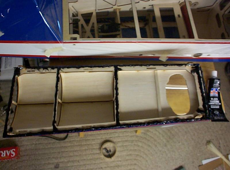

I've been a bit distracted, working on another project.
Good reminder about the paper towels. No matter how well you pressure-test smoke systems they will still leak. I just did the cleanest, most conscientious, pressure-tested installation I have ever done and the &#@*^#-ing thing still leaked a few drops.
One of these days I will get around to installing the .91 2c in the Phoenix, and now I know that smoke is actually a viable option.
