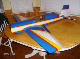

So I have been working on mine a little at a time.
Few things:
The fuse had a part that was broken loose. Simply glued it back on. (I blame shipping)
There was a rib in one of the wings that was cracked but nothing major.
The covering was a bit loose/wrinkled and in some places where not aligned well, so some time has been taken to make it all look pretty. The covering though seemed to be very friendly to work with. It took some time to find the right heat to get a good flow going.
I am adding in some yellows to the plane because I decided I didn’t want to use many (if any) of the decals. Without the decals everything just looked somewhat bland. I am a rookie at covering so it’s been fun. Well this is actually my first real plane and I wont count the lovely RTF Flyzone Cessna I have nor the 3 Target "Air Hogs"..
As I said I will be using a ST-G90 w/ standard muffler and will probably end up trying either a 15x6 or a 16x5 Zinger prop.

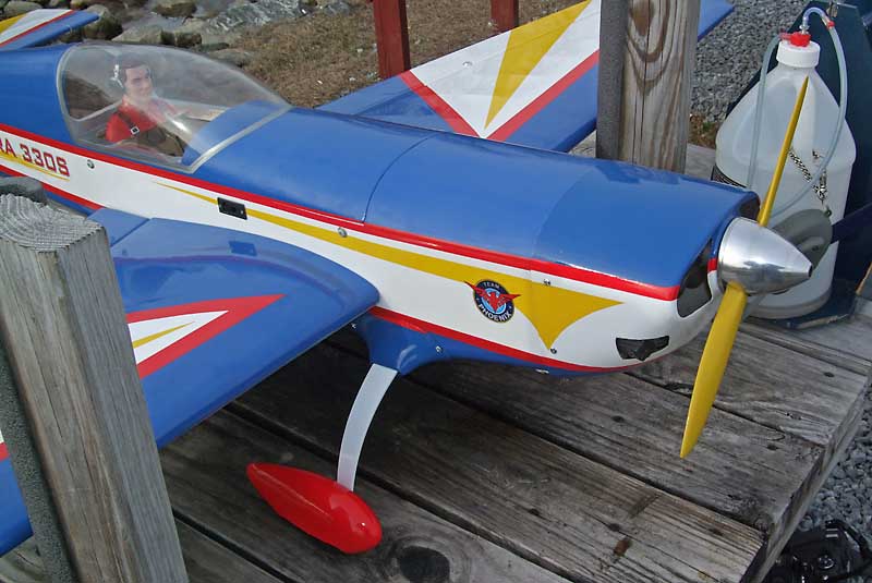

Hey, Jack, it looks as if the guys you are responding to - who used the Saito 100 - may not be monitoring the thread these days.
You can mount the engine inverted, 90 deg or at the 45 degree angle that has been pre-drilled and blind nuts installed. The 45 deg angle provides for the least cutting of the cowl and positions the muffler to exit in the little channel in the bottom of the fuselage.
I have an OS .91 4c installed in mine, using the stock mount and the 45 degree stock position, and it runs fine. I assume the Saito would also run well in this position. As you can see, all that was needed was a very small cut for the rocker cover.

This shows the engine mounted using the factory-supplied engine mount using the pre-drilled firewall holes.
