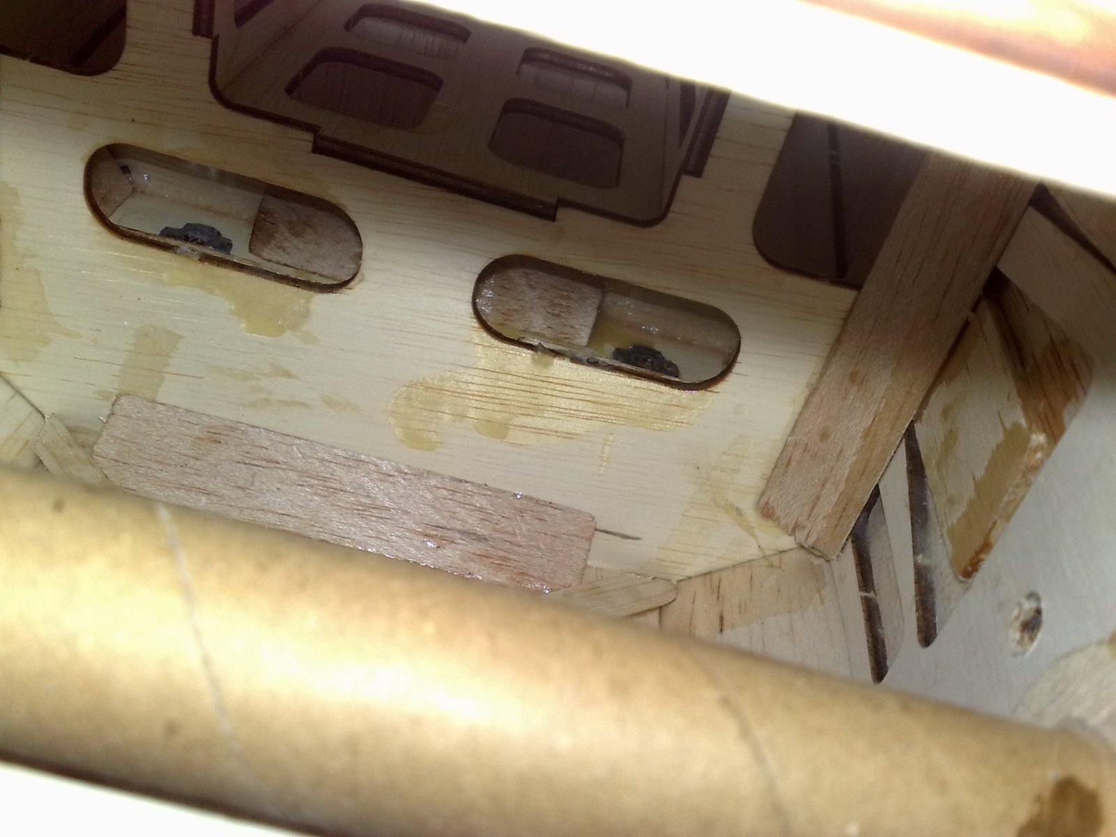

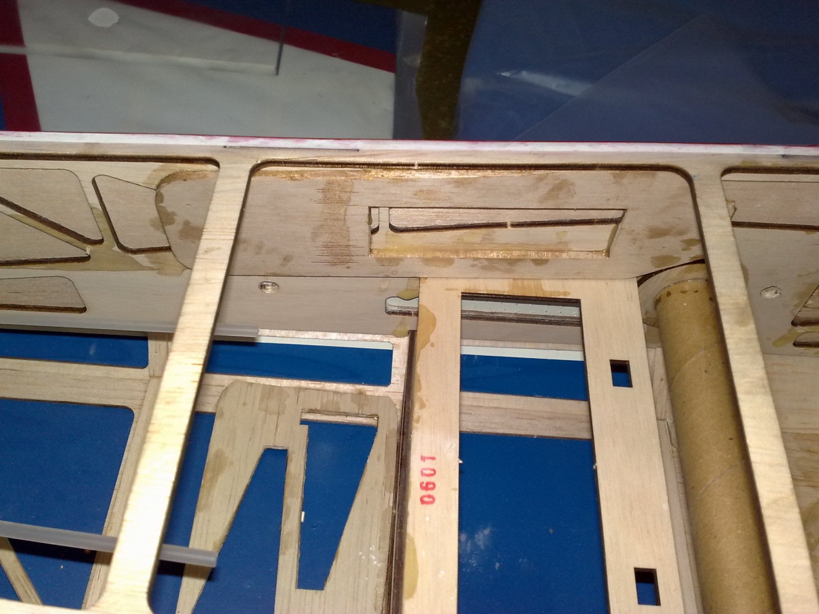

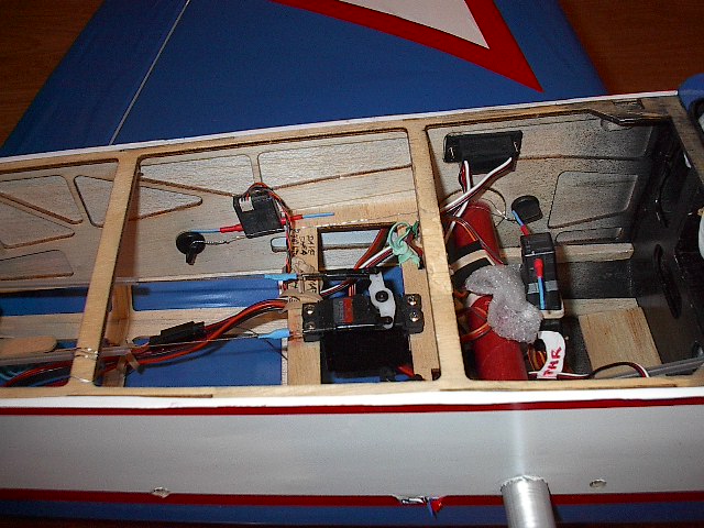

Nolefan61- per your request: Pictures of my Lockwire setupfor the wing bolts. First pic shows the holes in the wing bolt tabs. I just leave the wire attached to one bolt.
The wire is shown installed in the next pic, running over the wing tube to the front bolt. I put a hole in each tab so that there's always one on the right side.
Be sure and choose the hole that would make the wire have to get longer to let the bolt unscrew. There's a fancy way to do this... but I just twist it a couple of times. OK to have 1/4" of slack- picture the bolt trying to unscrew.
Note on the Right hand side the extra balsa added for Landing gear load distribution- one piece of aileron stock, thick side forward, on the bottom plate of the fuse. Two 1/4" sticks each side shaved to fit the fuse sides at the joints.
Just a little extra support to absorb and distribute shock loads during my "less than perfect" landings!

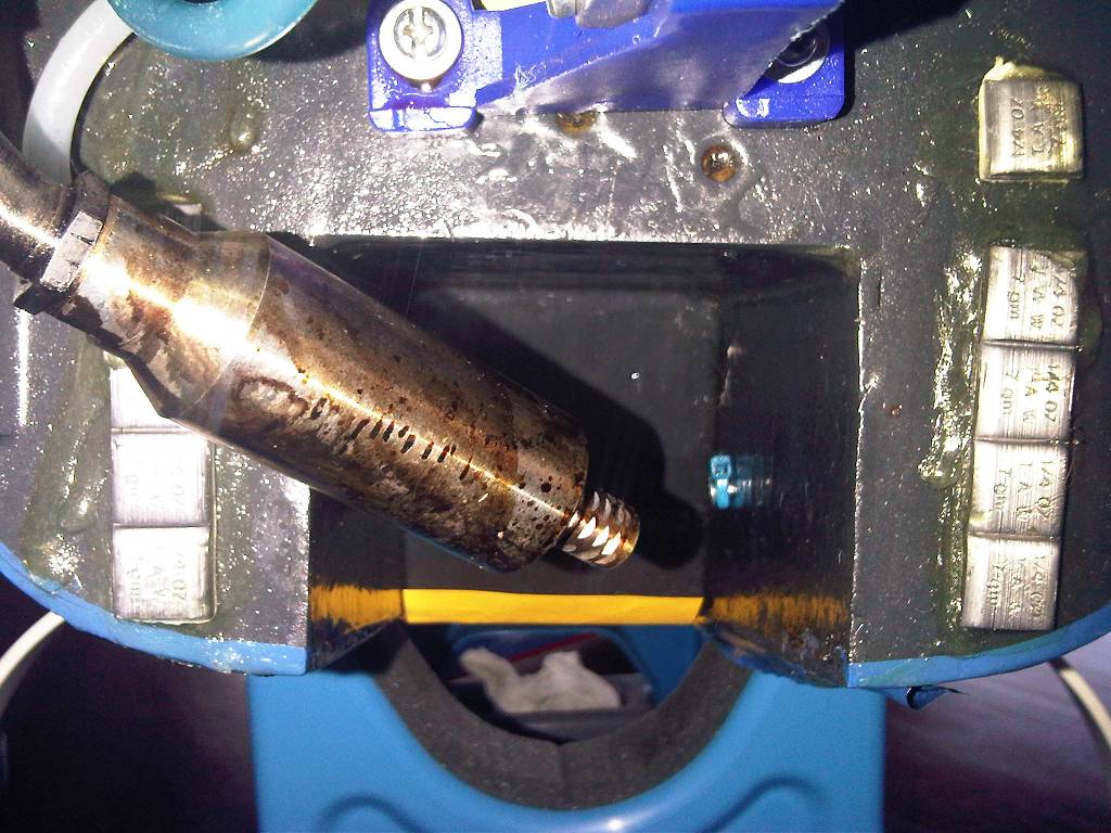

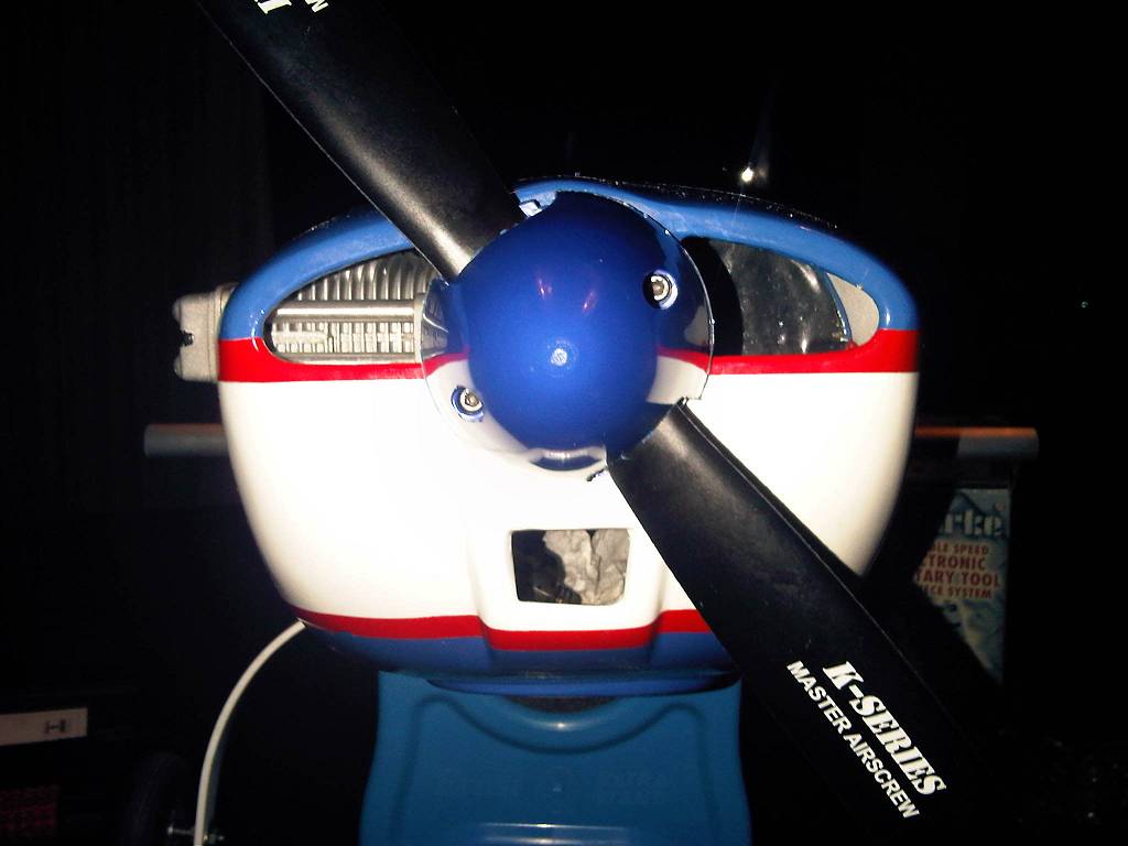

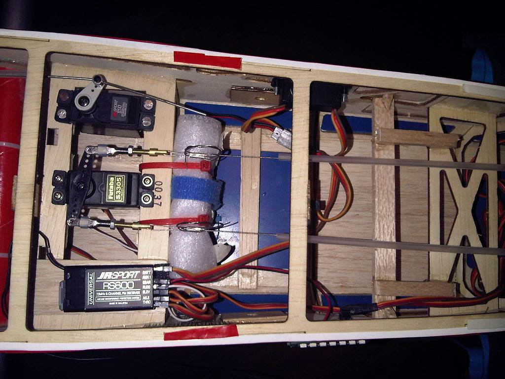

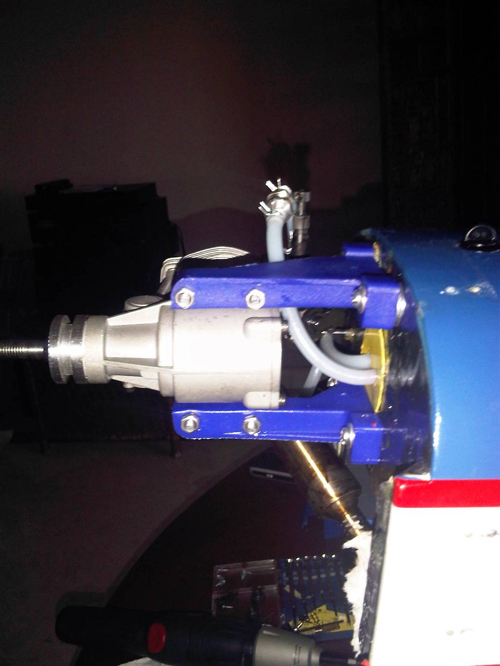

Hi to all, finally after 2 1/2 months of waiting i flew for the second time the Extra 330, this time i moved the battery from the battery tray to the Servos Base and attached to it. With this modification it didn't declare tail heavy and had a smooth lift of from the take off run, besides that, while it was flying leveled it shows tendencies to go up, so i decided to put some spacers in the upper screws of the engine mount to gain some down trust.
Also when we were flaring the plane to touch down it shows tendencies to drop the tail, so i put some weight over the engine mount. I will be flying the plane in about 3 weeks, so until then i'll not know the result of this, but i think is going to be good to have a little nose heavy tendency on it.
Also i found a problem to hold the deflector on the muffler exhaust, no matter what i do, that Du-bro deflector is trowm away by the engine compression and heat, and i'm concern of the fuselage damage that can cause. Does anybody have an idea on how i can make a deflector using a copper tuber, or other and that does not turn loose ? Need some suggestions !!!!
Thanks People.
Photos attached.
Thanks People.
Photos attached.

You could bend a short piece of brass tubing of the correct diameter that would slip around the muffler outlet pipe. Once it's shaped to exit correctly, drill a couple of holes for two small self-tapping sheet metal screws, run them through the brass tube into the muffler outlet pipe. Seal it all up with RTV silicone during assembly to keep oil residue to a minimum. Should hold together well, but if you need to, it will be removeable.

This may be too late for the Wrangler, but it is nearly impossible to keep a silicone outlet extension on a 4 stroke exhaust.
The stock 45° motor mount orientation lends itself to just pointing the muffler outlet in the tunnel, sticking out slightly below the fuselage- best choice for a 4 stroke muffler.
An alternative would be to buy one of the corrugated bendable ~150mm long exhaust pipes for your engine (Saito has them I know for sure- OS probably does as well) and maybe even skip the muffler altogether.
That corrugated pipe's open end could be held in place with a simple strap so that it doesn't fatigue off too quickly.
I added a close fitting aluminum diverter pipe to my Saito muffler and it seemed to fatigue off every 20-40 flights. Brass tubing will possibly be worse due to material properties and thinner wall.
My diverter pipe was dead soft aluminum for air conditioning contractors, with a slit to get it over the muffler and a hose clamp to hold it in place.
Looked good, worked well, fell off a lot due to fatigue!! Tabs would still be clamped to the muffler but the pipe would fall off.
