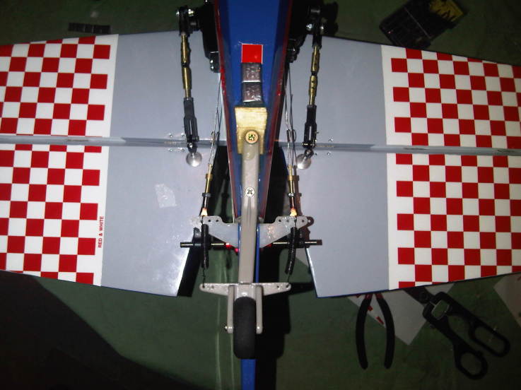

Billiefly- all good comments on the L/R balance stuff.
What I wrote about flat spinning kind of assumes pretty good L?R balance- but that isn't always a good assumption on my OWN planes, no less somebody else's!
NRAD2000:
Any chance your battery is flopping around during a loop? If the loop made it flop left to right, you could be seeing this effect as you level out the loop.
Anything reasonably heavy could do the same if it weren't held in place.
Another thing that I wanted to bring up because I did not catch it is whether you have the two servos both linked to the elevator on the top side of the horn:
http://www.rcuniverse.com/forum/fb.asp?m=9439191
The original kit suggests using a Y harness, which also requires the elevator linkages to be top and bottom, leaving significant asymmetry in the throws that you would fight.
With all DS821's and the OS 91, you are probably over 7.5 lbs. Heavier is snappier, but 7.5 shouldn't snap out as you slightly tighten a BIG loop.
I have (2) HS225 servos on the the elevator, with the linkages both on top side of the horn.
Mine is under 7 lbs and can loop around itself in maybe a 15-20 ftØ loop and not snap out.
If you are using the DX7, make sure you have the slave channel's ATV at 0% both directions. I say the slave channel, because some use CH5 (gear) others use CH7 (AUX2) but either works. You just want it (the slave) to follow the elevator channel, not add its own stuff as well. Maybe there is something happening there?
Remember to use one of the last two Mixes so that the trims come across from elevator channel, like Maynardrupp said. That's a peculiarity of the DX7.
One more thing:
My elevator counterbalance surfaces did not agree with the bulk of the elevator surface when viewed from the rear.
Many people I talked to use a couple of popsicle sticks to clamp the counterbalance surface (that part ahead of the hinges) fluch with the stab.
When I used that shortcut to set mine up, the elevator halves were way off just at neutral, adding some twist that the ailerons had to be set to counter.
So give a look from the back, at neutral and other positions to see if the two halves agree, ignoring the counterbalances. Those little counterbalances are probably less than 10% of each elevator's area, so if they are off you'd want to ignore them like I do. Its the bulk of the elevator surface that you need to set equal. The errors I'm talking about (measured at the counterbalances) are one shirt cardboard thickness up on one side, and two cardboard thicknesses down on the other, FYI. That's about 1/16" on one side, 1/8" on the other when the bulk of the elevators' surfaces are at neutral.

I used 2 mixing sticks and taped it to the elevator closest to the rudder. I got it to mix really close. it's down to a millimeter or so on both up and down. one other flying guy said " did you balance it side to side". Ah, no. He picked up the plane from the tip of the spinner and near the center of the back of the plane and the plane plopped to the right. same side that drops in the loop. he looked inside the plane and noticed everything is down mid line except for my throttle which is on the right. Since I have an OS FS91 mounted horizontally (rockers on the right) - he said maybe that is why the plane could be favoring to drop the right wing. he suggests to mount the battery on the left wall of the plane and what ever I can move to the left. I was thinking maybe put weights into the aluminum wing tubes on the left. what do you think about that?
My battery is well secured under the tank. I have the tank pushed far back - right infront of the wing tube. Nothing inside moves except for the servo connectors to the wings - they are slightly free hanging inside.
I flew thru the loop a little faster and noticed that right wing drop tendancy slightly went away. I maybe just exiting the loop too slow and stalling that heavy side.

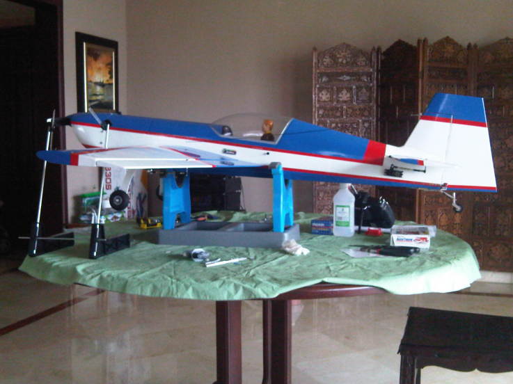

OK,
I will be very shortly putting together the Extra myself. Mine is old stock meaning it doesnt have the 2" tank spacing from the firewall, I will do that myself.I also plan to use push rods instead of the pull pull rudder and will reinforce the tail and landing gear with additional formers and fiberglass cloth. Anything else?
Ameyam
Ameyam
