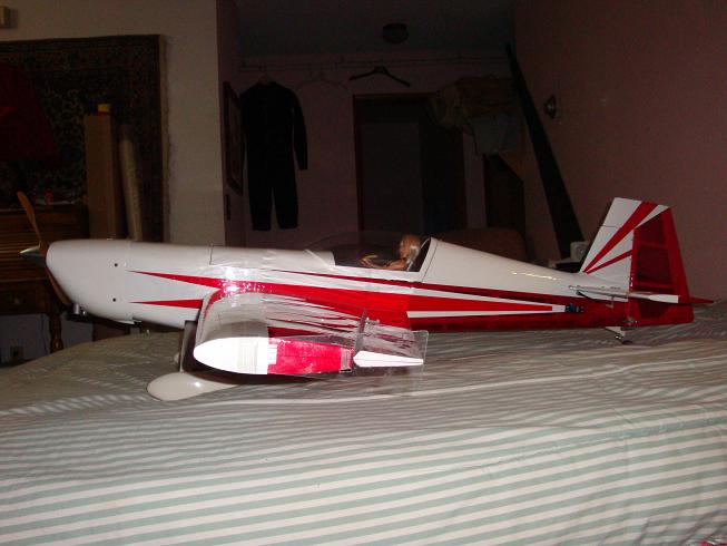

By that same token Flaperons UP 10-15mm (3/8" to 5/8") significantly reduces tip stall and speeds up the landings.
...But there is a down side to this- these are not flaps, at the root of the wing, but flaperons, all the way out to the tip. I learned from cmoulder (thanks if U are still out there!) on this forum in 2010 that flaperons down actually tends to increase tip stalling as the plane slows down.
Flaps up reduce Lift and Speed-Up the landing, as well as Reduce the tendency to tip-stall.
Flaps down increase lift, (Lift "IS" Drag) , they Slow down the landing and Increas the tendency to tip-stall.
SO Ya Gotta :
**Push the stick Forward to keep up the speed, (or sub-trim it in when flaps are activated) & count on the
drag to slow Ya down.
** Add these Mylar winglets,which will help to keep the air attached to the wing-tip, and reduce the tendancy
for the wing to tip-stall. They also aide in helping to keep the airplane tracking in a streight line. Thay effectivly
kill the wing-tip vortex at the expense of a bit of drag; but Who really cares when i got a DLE-20 up front that's
capable of puting out 14lb of thrust ?
Like -min$2crash said : " To each his own" !!
Kinda like the stock covering job ; some can Deal with it, & like me : ((Some Can't)).

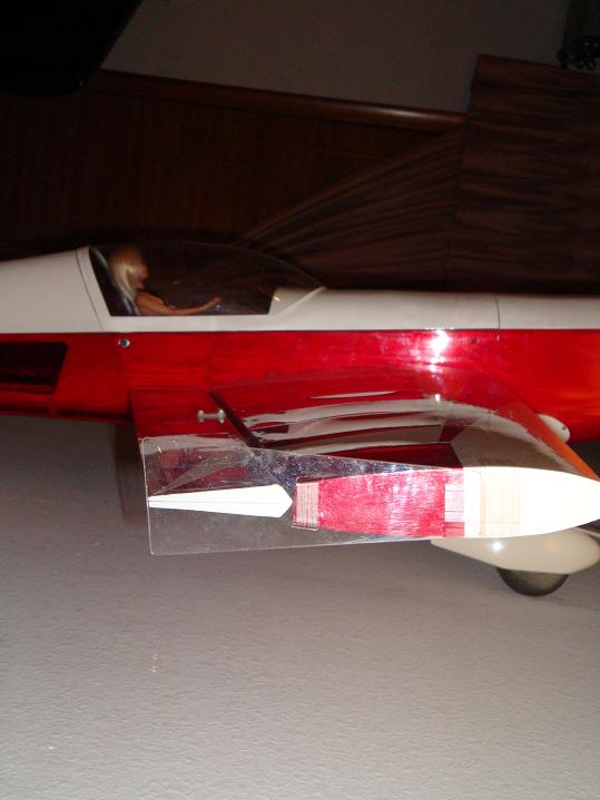

made with 10mill Mylar. The mesurment across the back is 2 1/4inches, (57.15mm) then
they taper down to the width of the airfoil at tha thickest part.

Another Really Cool benifate from the
wing-tip gates is that they increase the efficency of the ailerons thus giving them control
much further into the stall. For This reason i add more control travel with the servo then
add EXPO to give me a nice low stress place in the center, ((kinda like flying with trim tabs)).
I do cut down the travel adjust for Low rates but the EXPO stays.

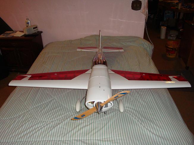

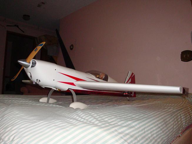

My Extra completly referbished :
3oz glass on fire-wall and landing gear.
Made the tail removeable.
Wing gates , a MUST HAVE !!
Sheeted the LE bays with 3/32 balsa & capped the ribbs with same. (( made it fly WAY better )) !
Fired the Dude pilot & replaced him with a Blond Winch !!
Added an Ultra IBEC ignition battery eliminator circut ,from Tech-aero, set to 5.3v , ( has a KILL switch for ignition ))
Added a Tech- aero Design BEC, set to 5.8v .
Added an LCD from above to notify me my Receiver was ON, (Dummy Me can't remember to turn it Off) !
Polished my DLE-20 and made it feel NEW .
LI-POLLY Battery, made "TWO" for extended fly time but only Need one to power receiver Add ignition.
Total ready to fly weight is 3,800g , ( 8.36 lb ) ; dropped about 1/2 lb & got 14lb of Thrust from my DLE-20.
Bille

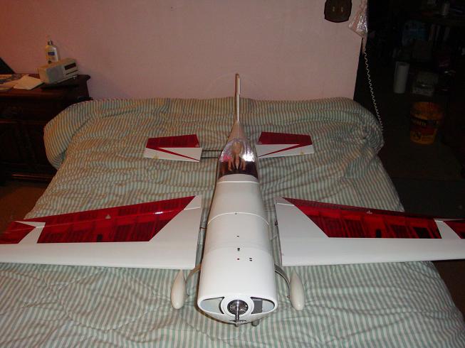

When i said i dropped a 1/2 lb ; it was from when it was electric with a Hacker & a 6,000mah 22v battery.
It flew OK with the gates. Seriously though ; sheeting the wing with 3/32 balsa & capping the ribs is
what really made the BIG difference.
See the thickness on the TE of the aileron in this shot ; i can add about (.75) inch to the TE which is
28.5 inches long. that works out to about 42 sq inches more aria on the wing, all of it on the aileron.
SO it will be a tad Less wing-loading and control Better ; also my servos Can handle it.
Probably gonna Do that. If it doesn't work then I'll hot-wire a New wind, same proportions on cord thickness % as now
but with with about ((100 to 150sq inches)) more aria.
33.33 % of it on the LE and 66.66% on the TE from the stock wing. I will Keep the stock span.
If i Like that then I'll mold the entire airplane, and build one from mostly ALL carbon ; which should
bring the weight down to somewhere in the 7lb range.

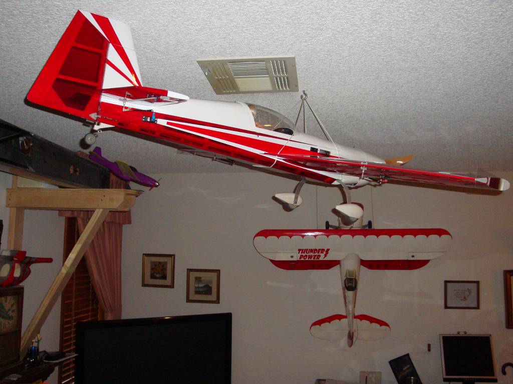

Bille.... great job on the rework. I have a silly question. lol You have it hanging by the ac/heat vent in your celing... will that cause issues with the covering and warping in the long run? I really don't know but is a possibility? Have fun flying!!!

With a well sealed and heat-shrunk MonoKote job NO !!!
It gets 112 deg in the shade here in Vegas, so heat is not a
