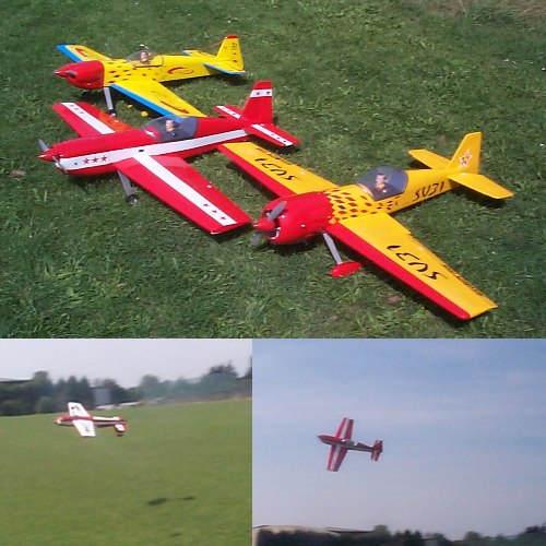

Hi, I just bought the Black Horse Extra 300S ARTF, has anyone else built one of these? I would appreciate any tips on the assembly, especially for any weak areas. I have seen the Black Horse Excel 2000 snap its wings in flight (twice), so am a bit worried that this kit may have similar faults.

I have the black horse extra and cap (prototypes) and my dad has built them both stock. I have as much movement possible (not nessary as I am a nutter
) but have had no problems with strength at all. I think that it will stand up to what ever you do but strengthen it if you want. I even flew it on ski's at the weekend, and no problems!

The Sukhoi flys well normally but with silly movements you can do some cool stuff (tumbles while flying sideways, blenders, tork rolls etc). The sukhoi can do normal stuff like loops, rolls etc too.
Hi MalaysianFlyer,
I like the extra since it is in between the cap and the sukhoi in flight performance. It can be flown in big manouvers like the cap can but it can fly tighter than the cap like the sukhoi. Its a good all round sports model. I have tried to prophang it but the ailerons are too far out to stop it from tork rolling but I have not had a propper go at tork rolling yet, I'll try this weekend. And it will blender.

All I did was increase the movements as muct as I can! I have not yet flown with a CG change but I might try sometime. I have successfully flown this in fog (and I couldn't see the end of the patch! NOT ADVISED
, but I had to get my fix
) This is my weekend hack and I love it!
Heres what I've got it to do:
Almost knife edge (not enough rudder)
Knife edge curcuit (cheating by not being entirely in a knife edge)
Blender
Loop
Roll
Flick
hover with headwind
Don't know what its called but its goes roll, flick, roll, flick etc (non-stop)
Almost torque roll
Tail slide
Hammerhead
spin
inverted spin
side slip
fly with ski's
good inverted flight
etc.........................................
Alan
