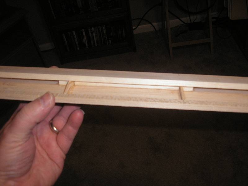

I have started modding the Rascal wing with Fowler flaps while I am waiting for the AMR Trainer 50 and the RCS RV-50 to show. I love the way the Rascal slowed down and landed with the flaperons but I did not like the loss of aileron authority when the flaps were deployed so I decided to mod the wing and add flaps. First I stripped all the covering off. After doing that I found several stress fractures on the web fillers between the main spars and several ribs split front to back. Nothing was missing or out of place just split. This could not be seen with the covering on even through the transparent red. So I used thin CA and glued her up then went on to the flap project. I started 10mm from the fuselage and removed a section 70mm deep all the way to the aileron. I added webbing and a 3/8 filler behind the webbing to support the hinges. I will be using Robart hinge points install from the bottom to allow the flaps to drop down and back so the leading edge of the flap is exposed. They will nest up to the wing when closed so the leading edge will not be exposed. I have the cutout completed on the right wing half.

Looks good Ron. How did the area where the strut screws to the wing look?

That area was good. I think that was all that was holding the one wing together. I don't know if the damage was from me or from shipping.

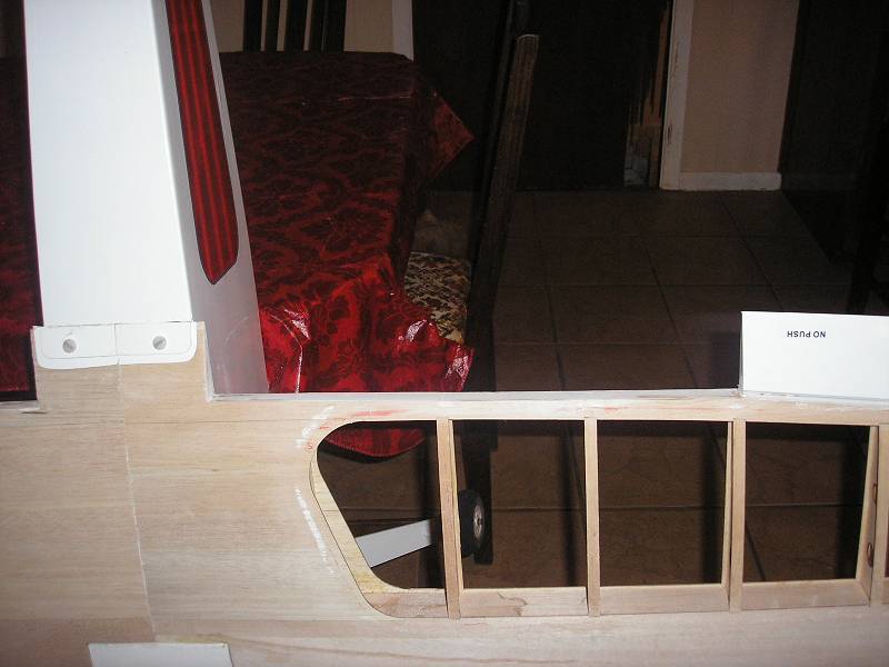

I have completed the flap cut out on the left wing. Next I will build mounts for the servos.

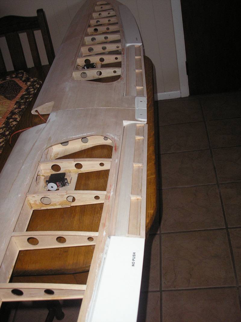

Both wings are now complete including the servo trays and servo installation. Next step is to build the flaps.
