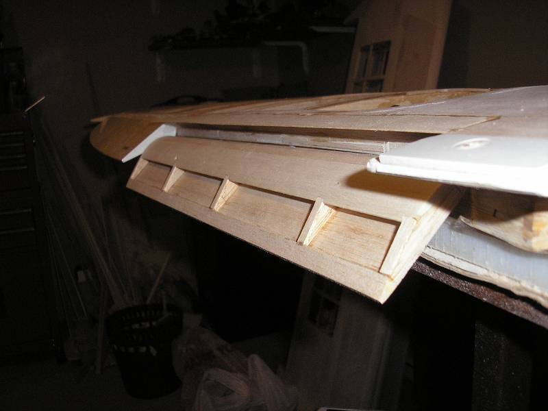

Jim how is the build going? I pull away from my AMR 50Trainer build long enough today to hinge the flaps on the Rascal and install the top side fillers. I am really happy with the results. Tonorrow I will do a little sanding and start applying Balsarite. Next week it will go to one of my fellow club mates to cover. He is awesome at covering and I want the Rascal to look like a stock plane other than the flaps.

The flaps look great. I'm curious as to what the Rascal will do now with the flaps. I wonder if the ailerons effectiveness will suffer due to their downsize???

I did not alter the ailerons. I am expecting nice slow landings with a little throttle added. I am also looking forward to being able to loose altitude quickly and landing without circleing for 1/2 hour.

I will keep you guys posted how the flaps affect the flight characteristics. It is not a really difficult mod but id does take time and requires pulling off the covering of the wing. I should get the covering started next week.
