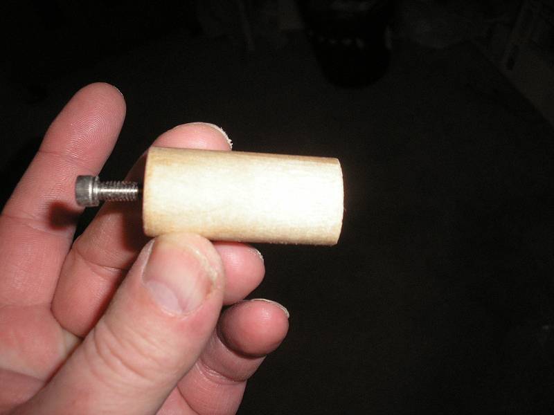

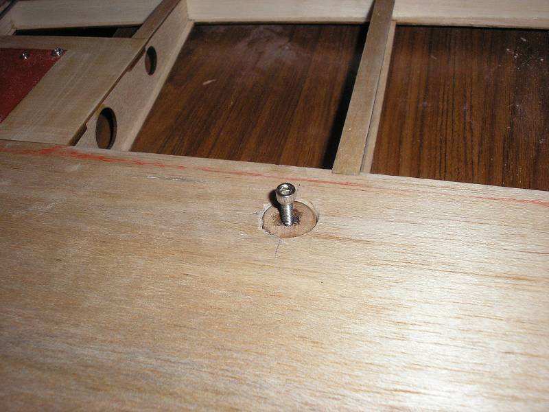

I have the wing strut connection points on the wing complete. There is about 1/2 inch of material that consist of the blind nut sandwiched between balsa and plywood. I used a 3/4 inch hardwood dowel to start. I mounted a 8-32 Stainless Steel Keensert in the center line of the dowel. I drilled clearance for the bolt 1 1/2 inches deep in the dowel. I marked center lines on the existing hole and centered the dowel over the marks and marked the outline of the dowel with a pencil. I then used a Dremel tool and opened up the wing inside the mark I made around the dowel. I finished off the hole with the drum sander attachment on the Dremel. I then stuck the dowel, insert end first, into the hole all the way down until it made contact with the top of the wing and marked the dowel. I then cut the dowel off about 1/16" short and sanded the edges on both ends. I screwed a 8-35 x 1" bolt in the insert a few threads. I then mixed up a bit of 15 minute epoxy, Coated the inside of the hole liberally and also put a good dollop on the bottom of the dowel and inserted the dowel into the hole holding the bolt until it bottomed out making sure the dowel was recessed a little. I added a small amount of epoxy to the top of the dowel to fill the small gaps between the dowel and the hole I opened up. About an hour later I filled the recess with faring filler leaving the bolt in place. After an hour or so I will remove the bolt after the filler has set some. Tomorrow I will sand the excess away and add a couple of coats of Balsarite. All done!!!!
ID:	1131756   Click image for larger version
ID:	1131757   Click image for larger version

I mounted the wings and checked everything out including the new strut mount points in the wing. All is well. Wings are now in the van along with the flaps ready to go the get covered. I still have much work to do. I am replacing the stock ignition with a CH ignition and upgrading all the electrics to 6.6vdc A123 batteries and dual switches.
