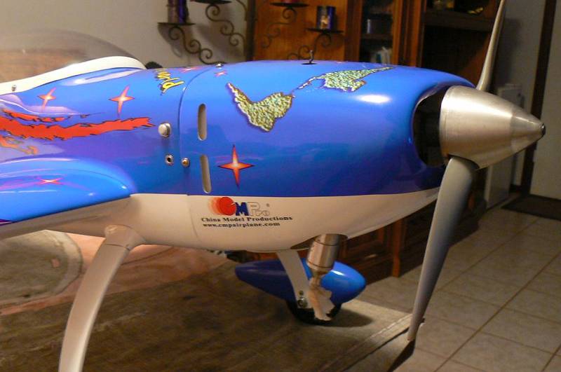

here is my cmp extra 330L......i chose EP. its 7.5 lbs. havent flown it yet.....a buddy of mine has the red version EP.....he claims it flies really well for the weight. i made my own droops for this....and tinted the canopy for a different look. im sure it will be a handful to fly.....not much wing. good luck all flying it.....(including me)....lol.

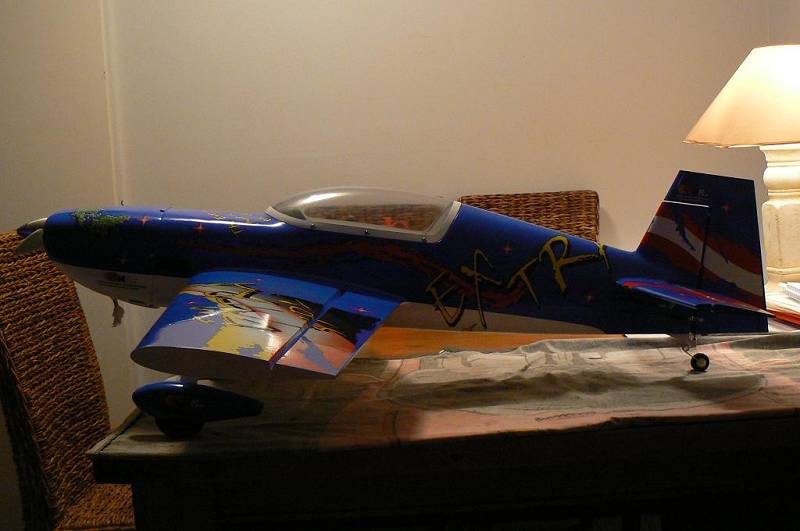

To adjust Cg on my A/C I made the following:
At wing root (fuselage-wing junction) I have made a mark on the fuselage at 90 mm of leading edge.
Then I just put my fingers on the marks I made on both side and that's all ! I had to put a lot of lead with the 55ax, and less with the FS-70...
I fixed the lead as following (picture with 55ax) :

You check the Cof G with the wings on. I think that picture was posted for reference only. I normally check it with my finger also, and have the plane at about chest level with the prop facing me. Just adda mark wherethe CG needs to be with a marker or something, and put your fingers on those marks. If the tail drops, its tail heavy, and if the nose drops (very unlikely with this bird) then it's nose heavy. Then add weight accordingly.

I have made the balance with everything fitted (cowl, spinner, wings, canopy, propeller, battery, Rx, servo) but with fuel tank empty ; I just lift the A/C by putting my fingertips on marks.

Just put your A/C on a table. Lift a bit the tail with CD cases for example to get the A/C nearly horizontal ; then gently lift it using the marks. If tail don't lift up add lead in nose ; do that until nose is gently pitching down.

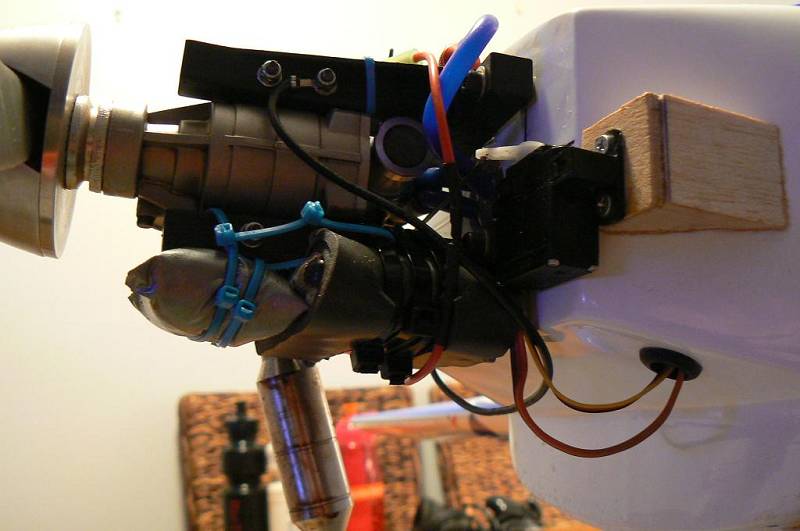

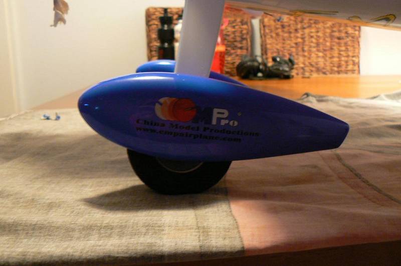

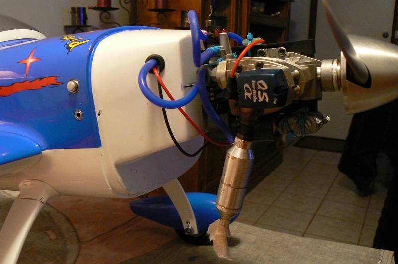

Thought I,d post some pics of my set up...in the hope Thatit helps some one out.
I also opened up the wheel pants to fit some larger foam wheels (very light, nice & fat with a
flat tread).

Hey, question, what things do you have in your engine mount? I see the battery well wrapped but I also see something that looks like a bag... what is that????? you are giving me ideas and I might change my battery position before the next flight..... I am also using a 11x7 (46ax), and the plane flies pretty fast, I have lying around a 11x4... I wonder if it would be good to put that one or is it too low pitch??????
I had 2 more flights today with it, I broke slightly the botton of the fuselage (easily fixeable)... my plane is 'heavy' for the extra weight, during the second flight, I tried to land but it was bouncy cause I was coming too slow I guess and it just cracked, I'll have to fix it. I think this is what I do not like about this plane, the landing skid is IN the fuselage and transmit the impact to the fuselage directly and it cracks it!.... I wonder if it can be modified in order to have a different (one piece maybe) landing skid outside with plastic bolts that could break in case of a hard landing instead of the fuselage! anybody knows??????
By the way, in my short experience with this plane, it does not float while coming to land, if you go too slow one of the wings will stall (that was not happening with my edge)..
