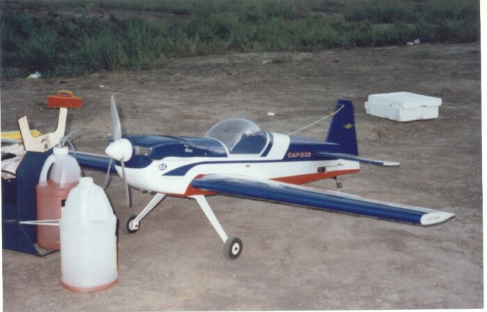

This is my GSP CAP 232, 91fx, now MA 14X6 flight great but is a little heavy 9.5lbs

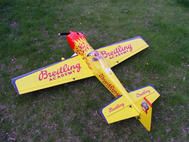

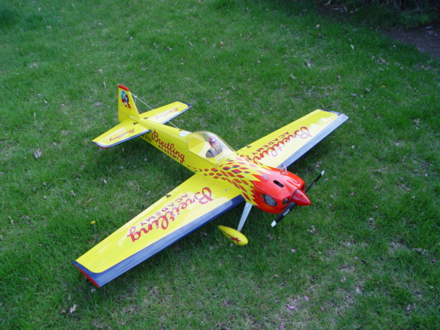

I just finished up a World Models CAP 232 - 40 size. I put an OS 61 in it and was able to balance it by placing the battery between the servo's. I haven't flown it yet can't wait.

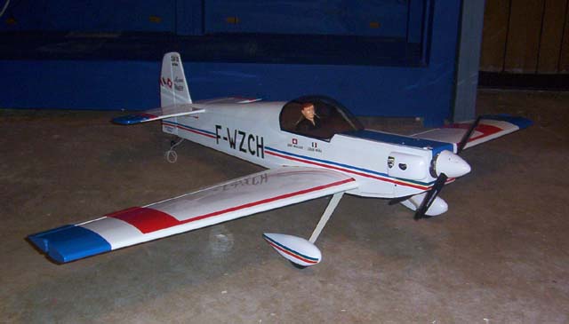

Here is my topmodels Cap232 3D, I hope you like it.

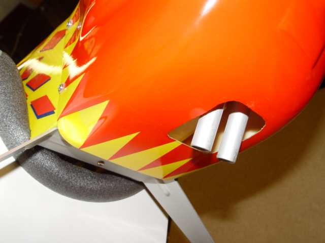

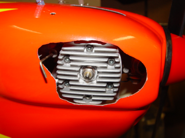

Quick question, I plan on mounting the engine (OS46FX) at 90 and using a Pitts style muffler, just from a rough look it appears as though the engine head will sit within the cowling, can I get away with only cutting a hole large enough to insert glow starter or should I cut a hole large enough for the whole head to be seen ? There'll be the opening at the bottom for the muffler exhausts for ventilation. I know from Full size aircraft that a cleaner cowling with only openings at front and bottom gives the best cooling, the engines will actually run hotter with the top cowl removed.

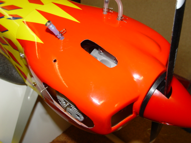

Hi Lancair-RCU,
I took pictures of my OS61 rotated 90 degrees inside my World Models CAP 232. I trimmed out a circle for the glow plug and 2 offset circles to be able to get to get a finger over the air intake for priming and access to the needle valve using a piano wire extension. I also cut out a fuel line view port to be able to look at the fuel line feeding carburetor. I also have a small excess hole above the needle valve set screw for piano wire extension for the allen wrench. I used a dremmel tool with a very small metal mill bit to trim out the holes.
Since I haven't flown the plane yet I can't comment on how hot the engine will run in my set up. There is a full width gap at the bottom of the cowl that is about 5/16's wide. Maybe someone else can comment on my set up after viewing the pictures, what good or bad. It's my first cowl so I'd be curious to know.

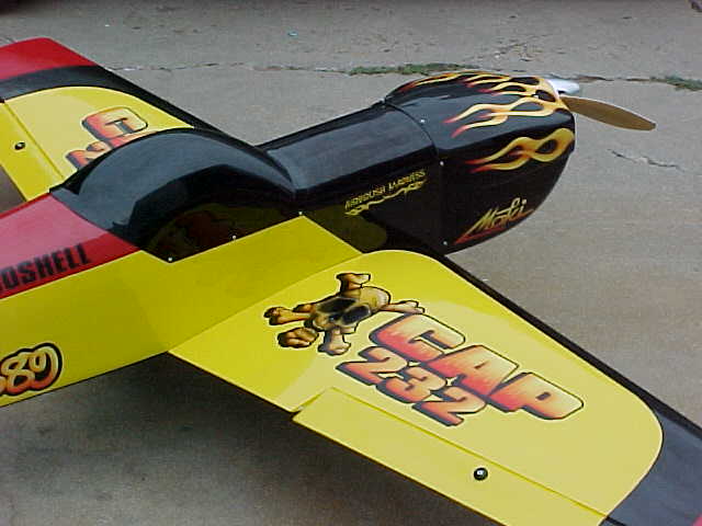

H9 232...don't know why H9 discontinued this one,they had a winner!
MDS .58
Futaba Radio Gear
