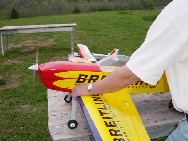

I just returned from flying my Cap (3rd time to the field with it). Today the wind was dead calm, so I really got to put the plane through the ringer. As you can see from my previous post, I wasn't too thrilled with its windy weather performance...
My first plane(this is my 2nd) was an Avistar and I was very happy with its aerobatic capabilities for a high-wing. But this plane is an absolute monster! With that big ASP .91 4s and a Master Airscrew 14x6(best prop so far) it will waterfall and blender like nobodies business! Seriously, I didn't think it would do it, neither did the guys at the field. But, I tried anyway, and it would waterfall with minimal input to the ground(if you let it, but you probably shouldn't).
I couldn't get it to completely flatten out an upright spin, but inverted I'm sure I could get it to hold its altitude b/c it flattened so well. It needs more right thrust as TR'ing was next to impossible. But, knife edge was super and... well, I am just so excited about this plane that I simply can't wait to get to the field again. Oh, and now that I have had a chance to really try it out, the G2 Cap doesn't even come close to being as aerobatic as this Kyosho.

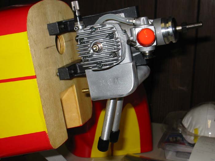

I finished the engine installation. I put in an O.S. 50SX. I put in the extra upward thrust recommended in the supplement.
If you look closely, you can see that I had to move the engine mount. When I first put it in I centered the mount, not the thrust line. I filled the holes by epoxying in a dowel. I then moved them over 1/4". All is well now.
I also found that a 2 1/4" spinner doesn't fit on the 50SX. I'll try a 2 1/2".
Next up is the pull-pull rudder.
-Michael

The 50 SX is probably a good choice, a .46 will not be unlimited. I had a 45 ABC Super Tigre in mine and it wasn't as spirited as I'd hoped but enjoyable nonetheless. The upthrust might be a good idea. Mine had a terrible pull towards the gear in knife edge.
Apart from that it was a great flying plane. Recently sold it to make room for more planes... I wish I hadn't now that I see this

Has anyone else had trouble hovering this plane? Like I said, mine pulls to the left so hard it won't stay in hover even with full rudder.

What prop are you using? Many of my friends use very low pitch props with their hover planes.
How is your lateral balance?
The firewall looks to have a bit of right thrust already in it. Check to see that your engine thrust line is perpendicular to the firewall. If you inadvertently canted it to the left it may have counteracted the right thrust in the firewall.
