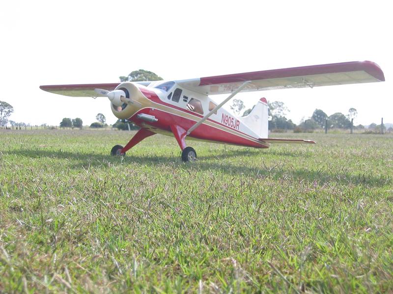

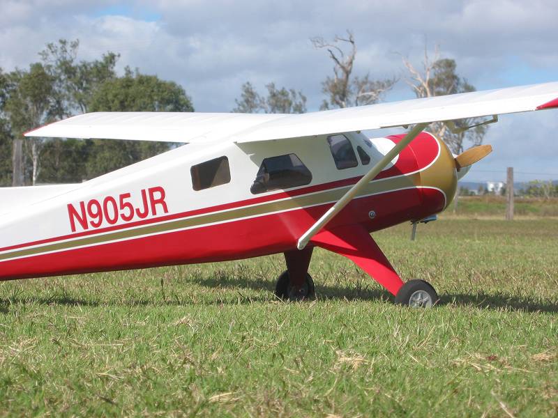

Hey guys just fitted a Saito FA 56, sounds awesome fly's great this plane was meant for anythink other than electric. I am spinning a 12/6 Prop, and installed a 12oz tank. haven't timed it yet, but when running in it took for ever to run the tank out. Flies to scale am very impressed with attention to detail

Basman,
Did you do much reinforcing of the engine mount area/firewall?
I am curious because I was thinking of putting one of these on floats, but based on the E-cub I think non-electric may be better for float flying. The E-cub I had ended up with a lot of water spray entering the cooling holes...ending up with damp electronics.

Had it flying with the carbie on the inside of the fire wall, but a landing in a creek popped the fire wall out so I installed a new fire wall 28mm back and reinforced the sides with some blocks. The perimiter of the original fire was glued back in, this gave me something to fix the cowl to on the original bolts, and reinforced the front. It also made easy access to the glow plug, as this was not easy to get too before. Will throw some pics when I get a change.
