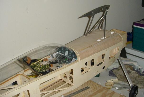

#122
My Feedback: (31)
cub yellow and true red is going to be my base 2 colors.
Fuse sides cub yellow
hatch and turtle deck true red
wings mostly cub yellow
i am not sure how i am going to do the wings as i want some strips something like dave patrick extra and hanger 9 ultimate. i think i may do the bottom part of the wings in the h-9 ultmates top wing look. not sure on my top wing look yet.
the plane is not ready for covering yet as i still need to cut the ailerons out and install my flying wires on the rear half along with sanding the dowels down flush.
