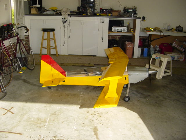

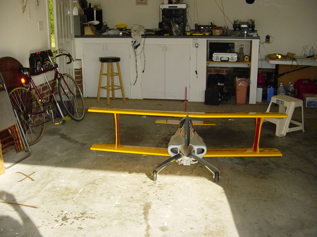

maybe a better angle

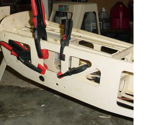

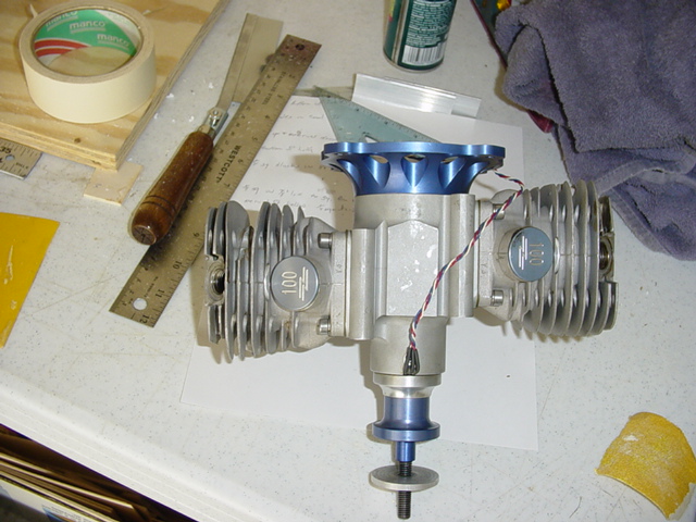

Man i have been slipping i need to get this baby up next month!

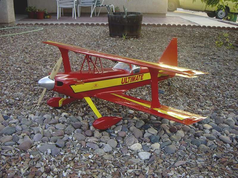

Here's a couple pictures of my 25% ultimate. It is from Conachen aircraft. Thier web site is www.conachenaircraft.com. It has a 62 inch wingspan and is made of molded fiberglass. This is the nicest plane that I own. the quality of this plane is awsome. I did not build it but got itfor a steal from another member in my club. It was powered with a ST 3000 turning an 18x6 prop and the performance is great. I am changing to a brison 2.4 gas engine and can't wait to fly it once the engine change is done.
Rick

she looks sweet i can't wait to hear your report with the brison on there

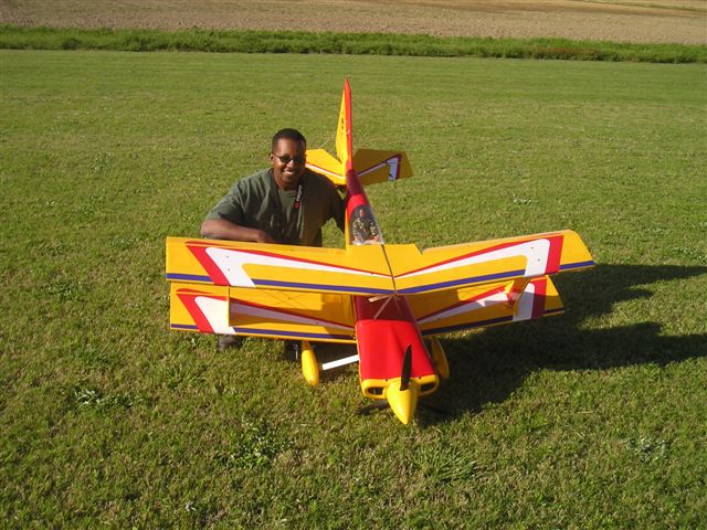

mine is finished now[8D]

Your plane looks awsome. What kit is it and what engine do you have in it. I was going to use a DA50 in mine but it is about 1/2 inch too long to fit inside the cowl. The brison will fit in it nicely. I think that the brison will be enough power for it as the plane is pretty light. It is really well built and flies very nicely on the Super Tigre 3000 that was in it originally. I am not sure who built this particular plane but I got it for 400.00 ready to fly. All I had to do is add my receiver and it was ready. I have been wanting a gas plane so I thought that this one would be a good one for it. It is built to handle up to a 45cc engine. The designer of the kit told me that alot of people were using BME 44's in them. I chose the brison because a couple of guys that I fly with have them and like them alot. Hope that this is a good choice? Great picture talk to you later.

when i went looking about a year ago i could not find many ultimate for gas i found this one at http://www.bobflies.com/
its a 70.5" WS 77.75 lenght kit to build foam wing, turtle deck, rudder, and stab. its made for a 70-100Cc and i went the 100 route its power for days with a 100 on there. i am talkiing like 50-60 MPH up lines if you nail it. i fly it at 1/4 throttle for staight and level flying. i had to send my C & H in last week so its down right nw the sensor was going bad in there. a 70cc motor would still work great on this bird. now that are quite a few good ARF out there in the ultimate series. i think that was my last stick buld kit as if you wait long enough a manf. will buid the ARF u want. your bird looks great the 50CC is the motor popular motor and plane going right now.
