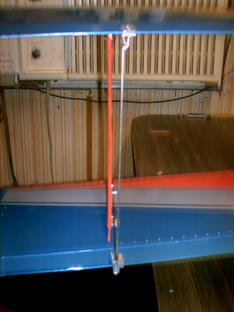

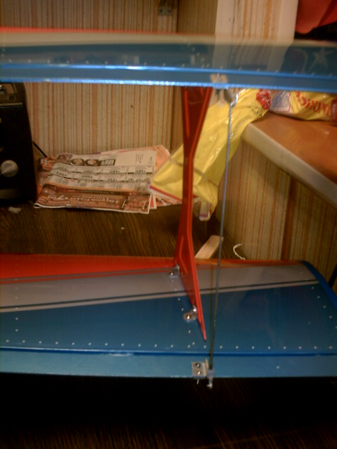

Can you post a picture of the ailerons?
If possible, post a pic of either side in the neutral, right, left and stuck positions (Preferably a side-shot that shows the linkage and horns)
Old 07-11-2008 | 10:34 AM
EpoweredRC's Avatar
Joined: Mar 2003
Posts: 1,138
From: Haralson county gA
Default RE: Help with Bi plane, ailerons not working right
Okay, well its not together right now but will be later, i can post the pic of the airplane all together from lastnight to see how its set up.
this is the whole plane then the left side and the right. will post better ones later. maybe I can do a video to show how they are moving.

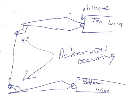

"Ackerman", put both of the control horns top and bottom wings on the same side (top or bottom) of the ailerons.
This may be causing binding when the top and bottom surfaces move at different rates or distance.

Oh yeah, right now bottom is on top and top are on bottom... hum, guess Could put the bottom one on the bottom thanks will try that
Old 07-11-2008 | 07:53 PM

I saw your video, something is binding! I would first swap the control horns sot they are on the same side of the aileron, so your linkage will move both ailerons the same distance. As I said before some one at my club was having the same issue, and the linkage was the cause.
Or it could be a weak servo and you can just disconnect the linkage to the ailerons from the servo and see it you have the same force and amount of movement generated by the servo in both directions of travel.
Another thing to check is that the servo horn is symmetrical and not an offset type used for aileron differential.

have you done this yet?

no, I tried to but the rods are not long enough to move the other to the outside as said have another plane here and there set up like mine.
