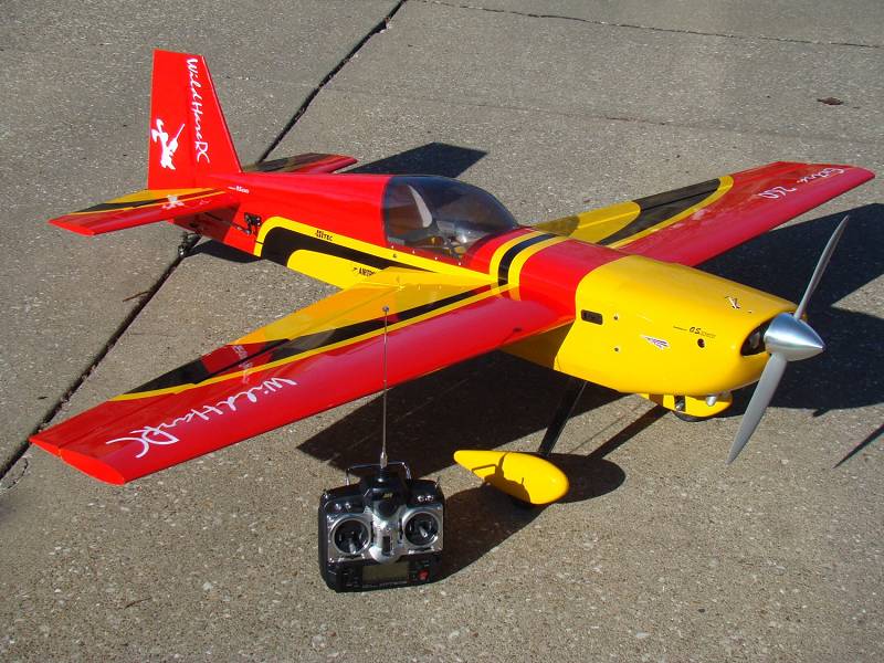

Deadeye,
I just sold mine. It had an OS 120AX 2 stroke swinging and APC 17X6 prop. Unlimited vertical. Very nice flying plane.

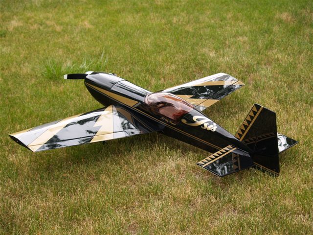

i cant remember which wildhare thread it was. someone took a 30 percent and stripped the covering off it (think it was the extra or the edge not the sukhoi). presented pics of the nekkid rabbit and then covered it in red bull scheme i.i.r.c.
found it
http://www.rcuniverse.com/forum/m_68..._2/key_/tm.htm
dont know if it helps with your ideas on covering
