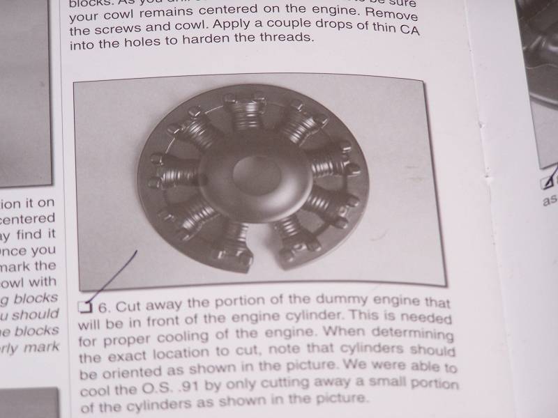

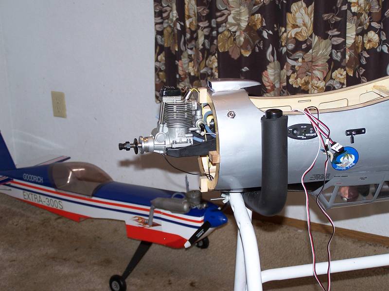

Here is some pictures of my setup with the OS 91, as per the manual. On page 22 of the manual, they will show you how to mod the dummy engine for cooling the engine. I have yet to fly my AT6 because winter has come to the great northwest. I will keep an eye on the engine cooling when I do.
You will love the build!!!
jet22b
jet22b

If you set up your engine and cowling per the manual and the way that jet22b did you will not have to worry about overheating the 91. One thing that most guys forget about is allowing the heat to escape the engine compartment alias the cowl. The way that the cowl is set up on this bird with all of the open space in the rear, overheating will not be a concern. I have a Hangar 9 P51 with an OS 91 in it and have never had the engine run hot. Of course I never run her lean.
jet22b: Read the review by Mike B and I think that the CG should be four inches from the leading edge on either side of the joint covers. If I read your reply correctly and you go 5.5 inches from the leading edge you are possibly going to be very nose heavy.

I will go and read Mike B review. Like I said in my post, the 5.5 came from using the Great Planes CG machine and the leading edge of the wheel well. I am in my workshop now and I will put it back on the cg machine at the manual 4-1/4" and see what the cg machine come up with. One good thing, the laterally balance is dead on!!!
Again, thanks for the info and Merry Xmas to you and yours!!

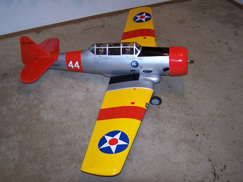

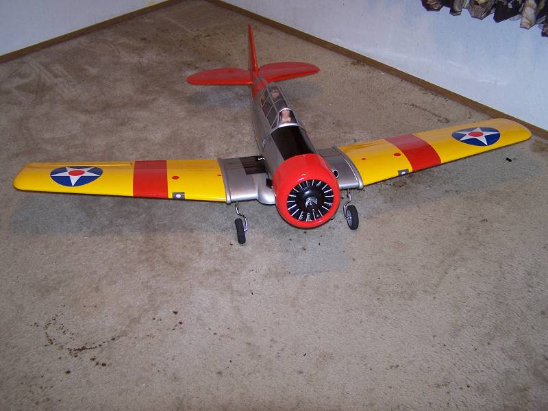

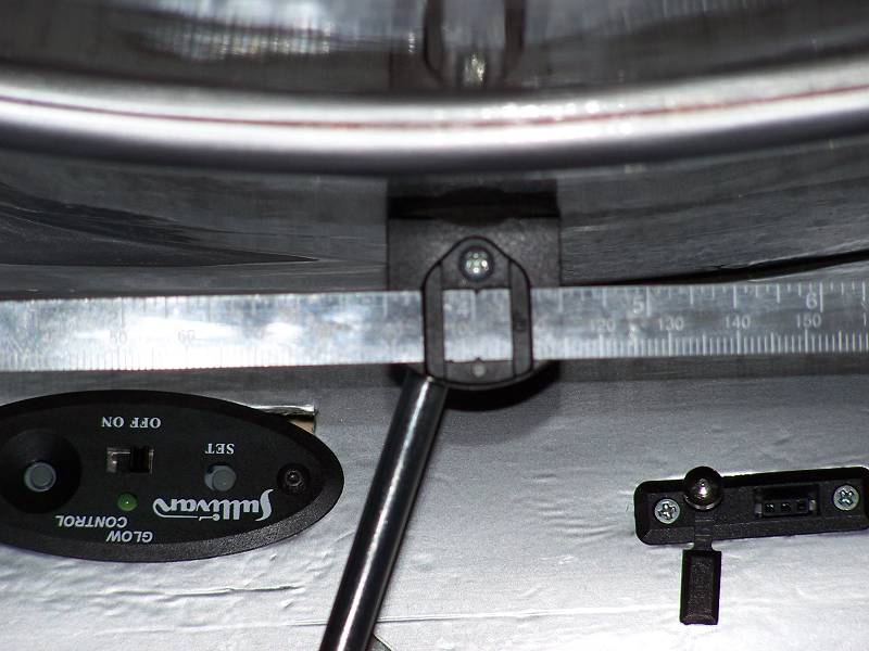

I went back into the shop last night and work for about a hour on the CG of my AT6. I did read Mike B review and set the CG as per the manual. I set the plane back on the great plane cg machine and move the number 2 battery pack, ( for my onboard glow system ), up to the firewall. The machine came out with 4 inches and the plane was sitting level. I know Mike said he did add so more weight at the field, and I will have so weight in my field box if the plane need it.
My fuse was just like your. Over 1 hour working on the fuse before it look okay. The control surface still don't look right!!
Now to get some good weather to test fly her!!! Now the weatherman is saying we may get 5 inches of more snow over the weekend!!![]
Again thanks for the info!!
jet22b

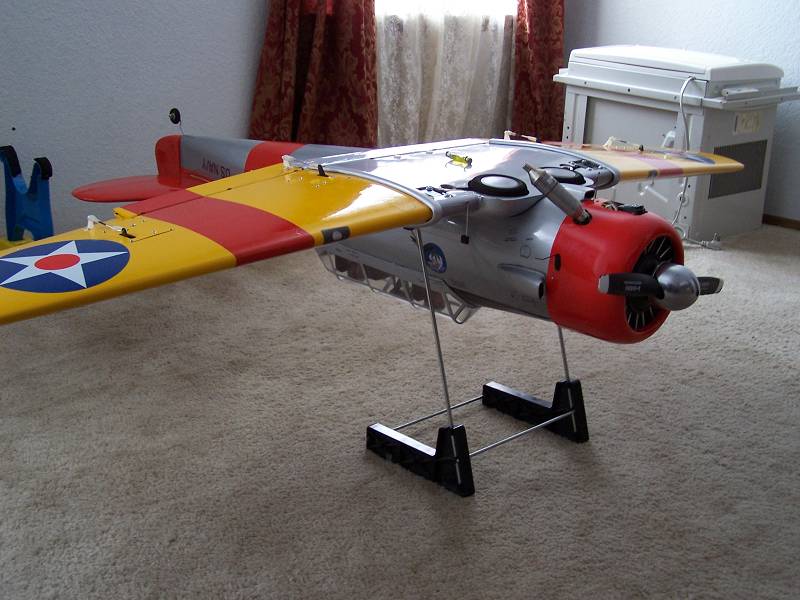

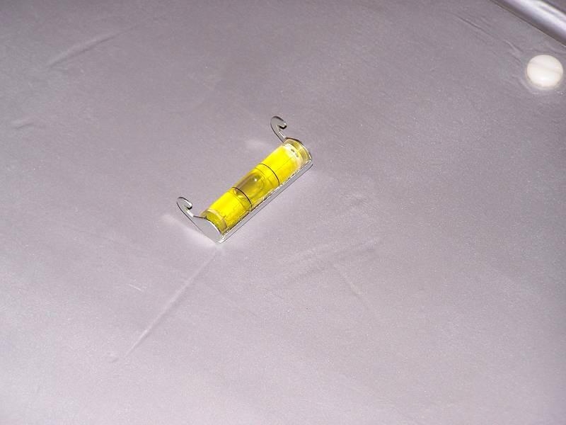

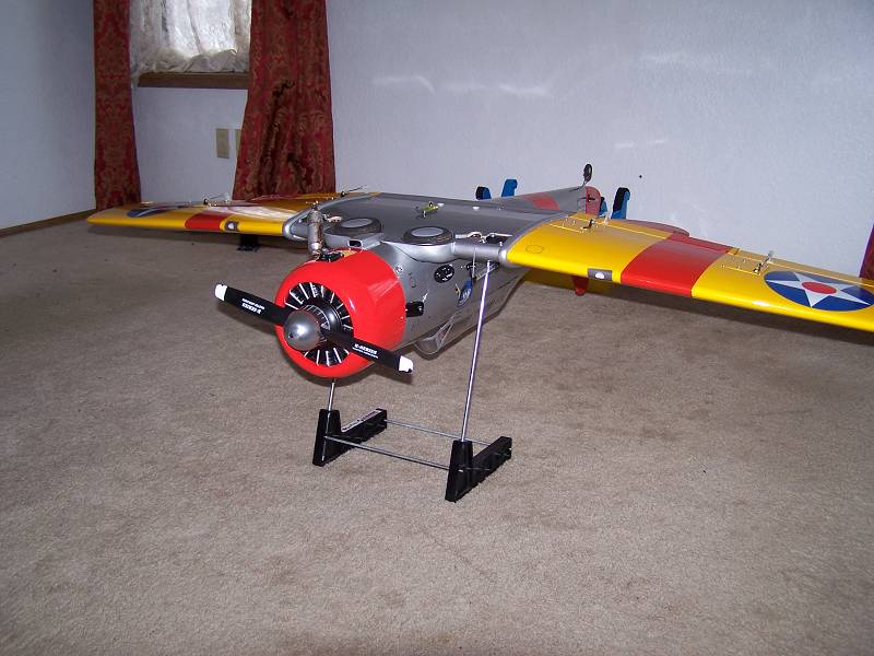

Here are a few pictures of my AT-6 Texan sitting on the Great Planes CG Machine, with a CG of 103mm or 4.055"
As you can see, the plane is level at this point. I email Mike B last night to ask about a CG range of 3.9 to 4.0" as a good start for the AT-6 Texan. He email me back and said yes that would be a good starting point. But he did point out that the control throws must be as per manual. A big must on the elevator throws!!!
With all the snow we are getting, it may be spring before I can fly her!![]
Merry Xmas to all!!!

Well I let my brain clear and went back to assembling the AT6. Even though I was greatly disappointed with the covering I was able to get around the few minor deficientcies and continue on. I will point out that the design of the combo tray for the tank, battery and receiver is a stroke of genius. I used EZ connectors on the servo arms for the elevator and rudder. I don't think that one could adjust the elevator through the hole at the rear of the fuse. I was able to get around the throtle servo problem that Mike B had by using a very small diameter plastic tube and music wire. A small bend near the servo arm and it does not bind or twist the arm.
When you mount the canopy and decide that you will screw it to the fuse and are going to put the screws according to the picture in the manual, be careful, the forward ply doublers in my kit were too far back to use that point and if I screwed it in there would be too much wind pressure on the canopy to deem it a secure mount. I just went and used RC 56 to glue it. And to the nay sayers, you can still the remove the canopy if it becomes necessary.
She is starting to come around and now I feel that this is going to be a really nice bird both in looks and performance.
