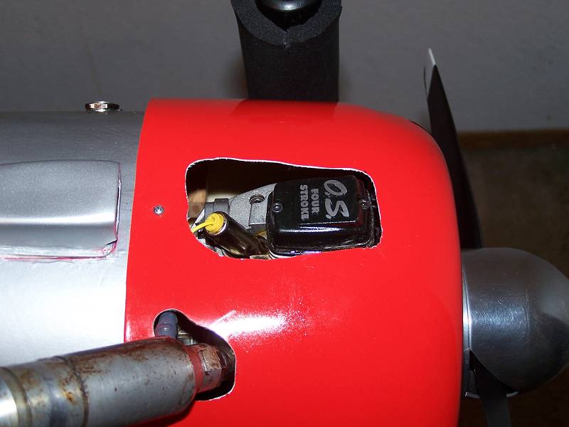

#58
RE: Top Flite AT6 ARF
Steve & Curt;
Here is a bit of info the both of you may want to look at. On my AT-6 Texan, I went with the Sullivan Onboard Glow Driver System and the Du-Bro Kwil-Fill Fueling Valva. Very sweet setup. The sun came out today but the club field is still under a foot of snow, so I went into my backyard and play with this setup. The OS 91 four stroke came to life after 24 flips of the prop. I setup the automatic operation for the glow driver to come on at low throttle. I was shock on how smooth the OS 91 Four Stroke ran with the glow plug on!! Just before half throttle, the glow plug go out and the OS 91 4-Stroke bring on the power. Bring the power back down to low idle, the plug come back on and the engine just tick. Hit the off switch on the system and the engine quit.
Please let me know if you would like to see pictures of my setup and I will post!!
Sonny
Sonny
Curt & Steve;
I think I found a way to start the OS motor with the big spinner. I have a Hangar 9 12V PowerPro starter with the soft rubber cup. I was in my shop last night turning the motor with this setup and the motor was turning over. So today I went out in my back yard to see if this setup would start the motor. I would say after 5 sec on the starter, the motor came to life!!! You will have to push hard on the starter to keep a tight seal on the spinner. That big spinner looks so good on the AT-6!!! Now this setup may or maynot work for you, but it can be done!!! Now to get some good weather so I can fly her!!!
Sonny
Sonny
#67
Join Date: Sep 2005
Location: Berthoud,
CO
Posts: 839
Tower sells a large aluminum cone for the Hobbico '180' starter with a large rubber insert. I think it's about $20. I don't like the starter....no real guts..... but with that cone it easily starts up to a 1.2 four stroke with that AT-6 spinner. I have them on 3 planes.
#68
Augie11;
Thanks for the info. I just place my order from Tower for the large cone and rubber. Now I can setup one of my starter just for the AT-6 Spinner.
Thank you again for the info!!!
Sonny
Sonny
