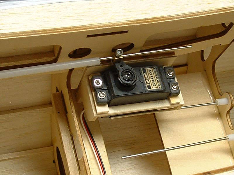

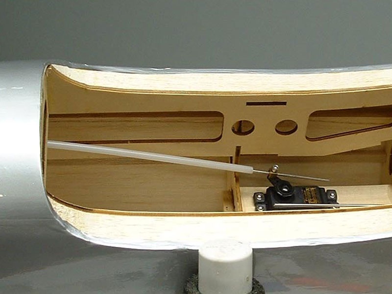

I am currently building a TF AT-6 for an RCU Magazine review. I haven't flown it yet, but it's ready to go (Just waiting on the weather)
The quality is outstanding. Although I did find two flaws - Both easily corrected.
1) The set-screws in the wheel collars did not fit. I don't know if they were the wrong size, or if the holes were not properly tapped, but I just re-tapped the holes and used some 6-32 set-screws that I had on hand.
2) There was a pretty severe angle between the throttle arm and the servo. This caused the servo arm to twist as it moved. You can solve this by either replacing the throttle pushrod with a flexible cable, or what I did was to make a servo mount that moved the servo to a more in-line position.
