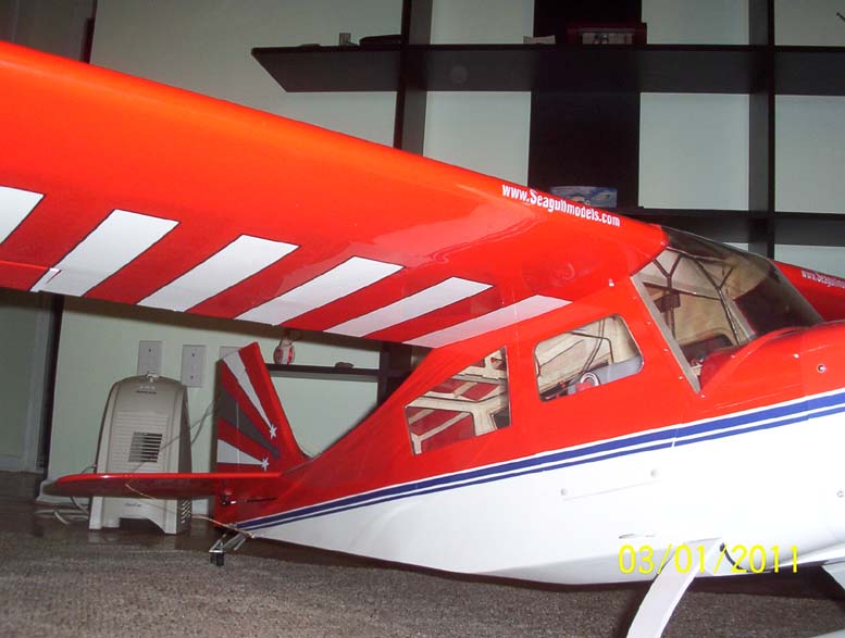

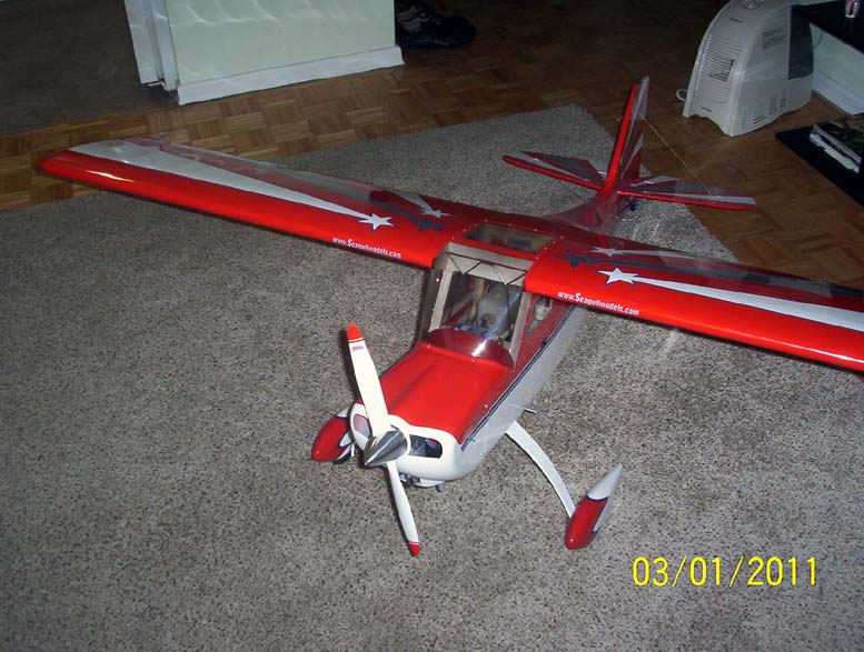

Basically I finished the plane. Trimming lines, stars, beams were pain in the a…s.
The last picture is a Photoshop test picture (in the process) before ordering vinyl stickers from Kirby.
I tried struts today. They are too heavy - almost 190g or 6.7Oz. Probably I will make new one from balsa. Has anyone rebuilt the struts?

Thx, SkyPilot101,
I think 190g or 6.7Oz are not a big deal for this plane (basically nothing), but I have time to re- built the struts because I don't fly in winter.

Thx ec121 for your input. I feel that those struts are OK for this plane. It's not a 2Lb foamy one
Just nothing to do during winter time and I want to make new struts.
I also set a CG around 85mm. Maybe your rattling sound is coming from pushrods? They may vibrate in tubes.
