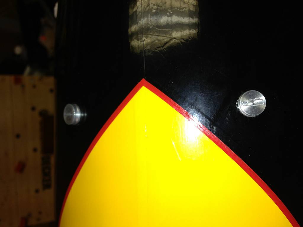

Default RE: Seagull Gee Bee Z

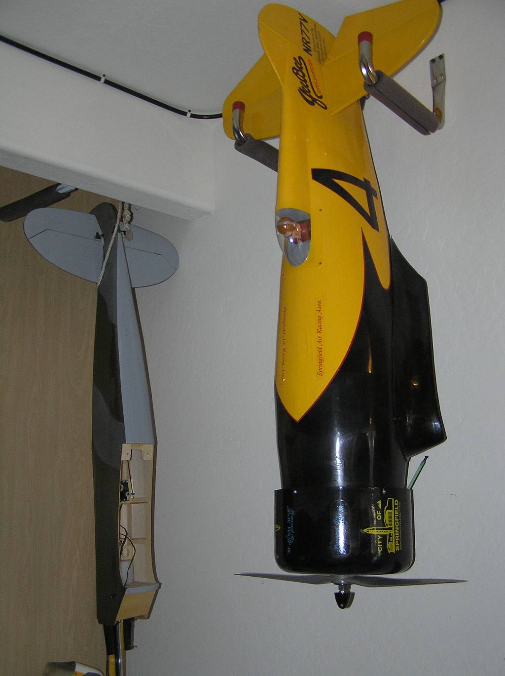

still hanging around
Going to have to put that bird back in the air again....

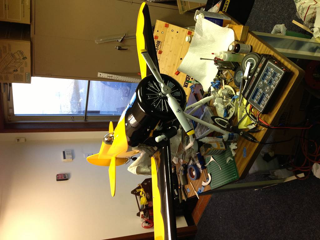

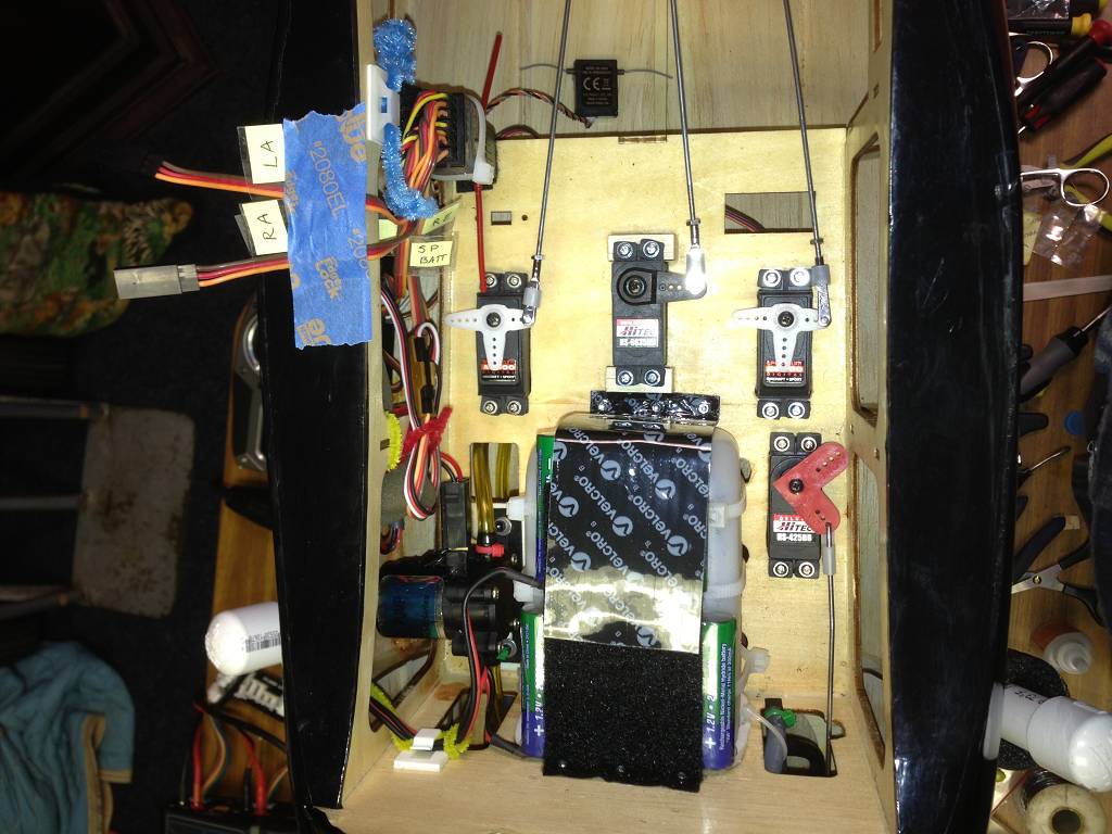

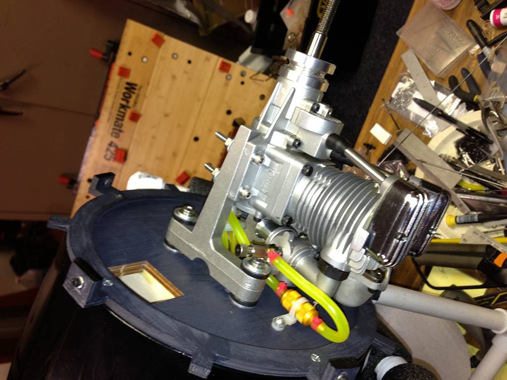

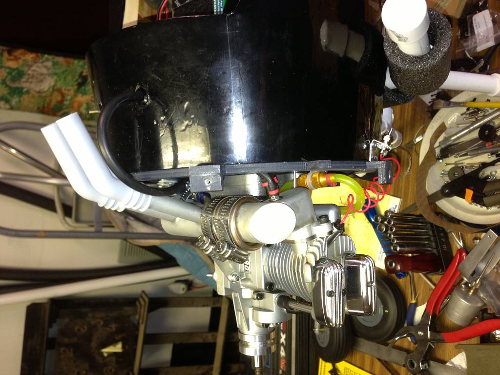

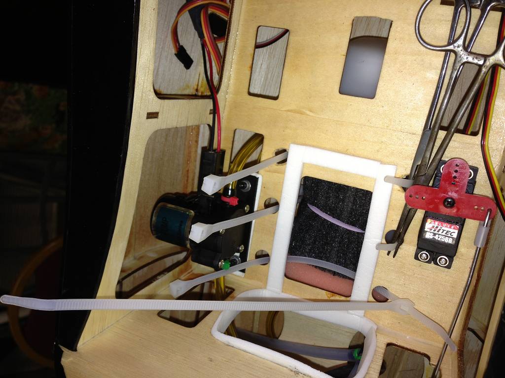

Worked all day on my Gee Bee build. Installed engine, TME smoke system, all plumbing , fuel dots, vent tubes that extend out the bottom of the fuslage, throttle linkage & servo, smoke tank, fuel tank, rudder servo, cowel and cowel ring. Found out I cannot do the magnetic quick release cowel as Stephano did, since my Pitts muffler pipes prevent me from pulling it straight out. Darn, I really liked that design he came up with too. I ended up with 4-40 bolts and blind nuts to secure my cowl. The 16 oz. smoke oil tank is above the servo tray, and 24 oz. glo fuel tank is below the servo tray. Tyraps surround both tanks, and hold them tightly together against foam on either side of servo tray. I ran and tested this entire system before installing in the plane. Believe me, I do not look forward to removeing the smoke tank anytime soon! It is deep inside this bird, and routing all the plumbing was a nightmare hehehe.

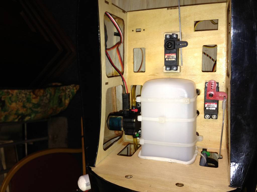

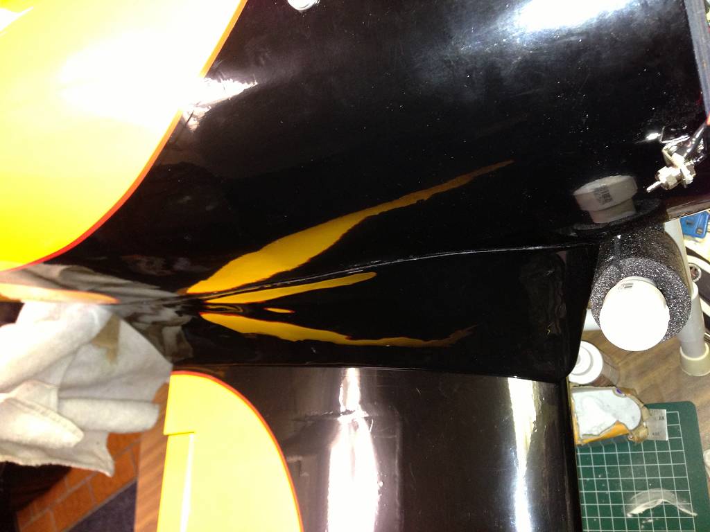

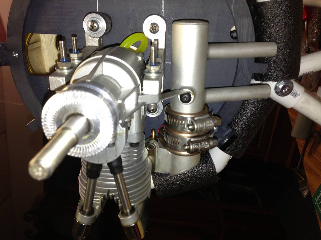

More photo's from today

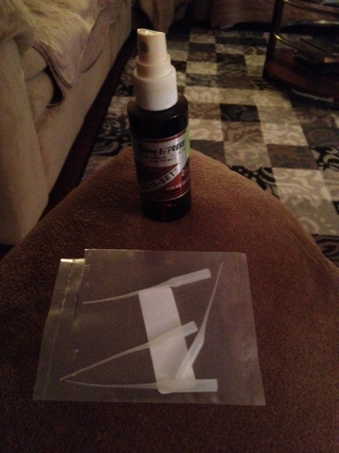

I used thin CA with applicator tips and accelerator spray. taking my time and working small areas turn out great, but not the easiest thingI'vedone. just don't get in a hurry .

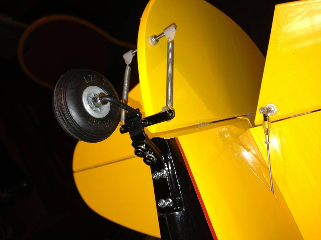

Thanks for the tips, so now I have installed my wing fairings! I reversed the procedure and installed the wing, trimmed and tucked the fairings in place, held with a little painters tape, the CA'd all around. Removed the wing, added a good amount of canopy glue in between fuse and fairing and reassembled for the night. This way I can work on something else while it dries! They look ok, but not perfect ;-). What a nightmare. I was able to upload some picks from yesterday's work mentioned in previous post!

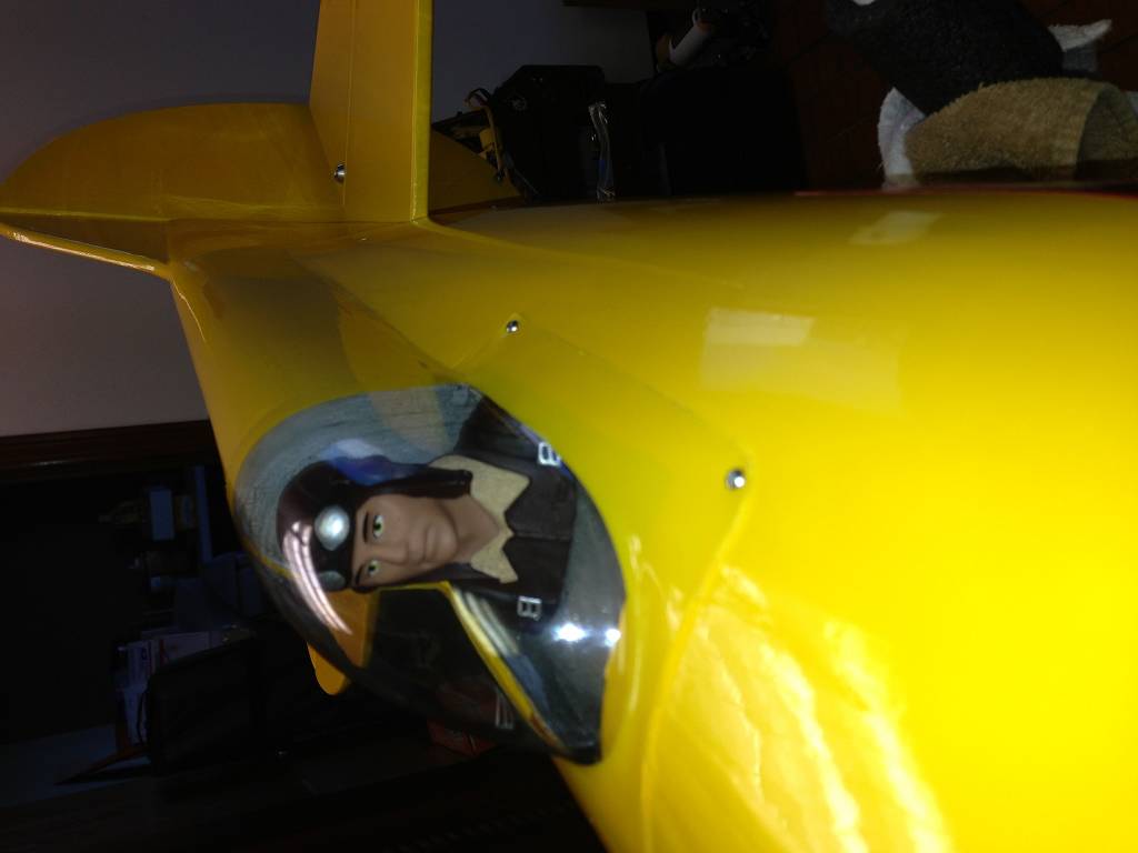

Starting to look like a gee bee z! Photo of the great planes period pilot I chose to use.
